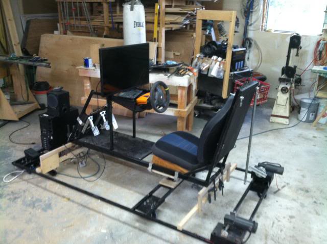

    Here is the pretty much finished assembly. I still need to add a mount for my shifter and another mount to the base for a static tray for the keyboard/mouse but otherwise it is finished.
    I ordered two Pololu 755's today. If I burn them up as well I will bite the bullet, order two winch motors and two Jrks's. :D

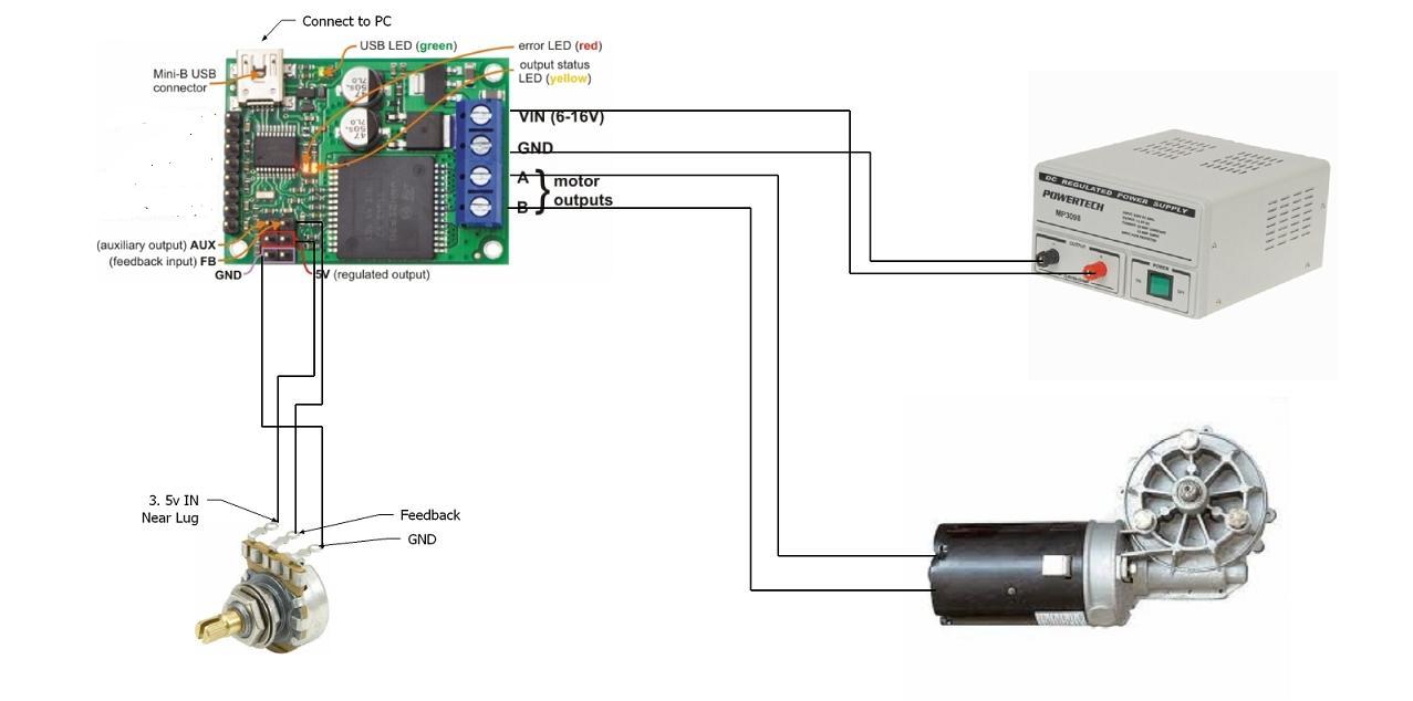

  17. eaorobbie
    20,503Coins
    +1,687 / 23 / -2
    Well , well, winches and popping up again.

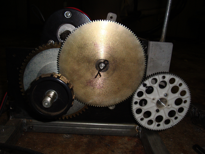

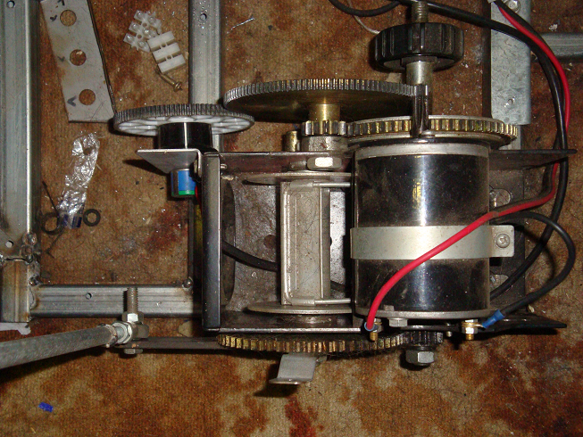

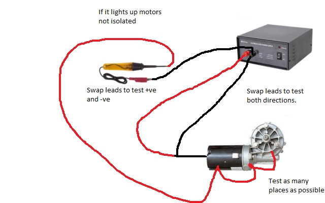

    1. Make sure you electrically isolate the internal motor terminals, most winches involved in the automotive industry have capacitors internally from the terminals to the body of the winch motor. These are in place for noise suppression, ie when motor is spinning it stop the interference noise coming through the am/fm stereo ,etc.
    Open the back of the motors carefully and remove these. In turn you can test this. Via:
    (link to test pic to follow) (Hey Dave could you post this I cant find my pic(Since banned from you know where, my photos gone too.)
    2. Ok now to wire the Jrk.
    3. Heat Sinking , there are two main chips on the jrk that need a heatsink to run continuously at 20-30amps all day. You will see the two big chips, I used two little heat sinks from my local hobby electrical store. Jaycar.http://www.jaycar.com.au/productView.asp?ID=HH8580 bonus thing that they have a heat transfer sticky on them , peel and place. One 120mm 12v fan is good enough to cool both. And is a must. or Jrks might overheat and shutdown, yes they have internal protection for this and other things.
    4. Now an important piece of info, hooking in the feedback pot, this either can be done via levers or as I have found for the style of winch I first used was a RC Heli Gear matched a cog on the winch and a 5 turn pot was perfect for giving me 180 deg on the lever.

  20. bsft
    Heres the testing motor pic
    As for hooking up heatsink on big chip, I used thermal paste, sat heatsink on top and made sure it cleared capacitors and stuff, and used a bit of araldite on the edge next to wire terminal block and glued the heatsink to that a bit, to keep it steady.
    No I dont have a pic.
