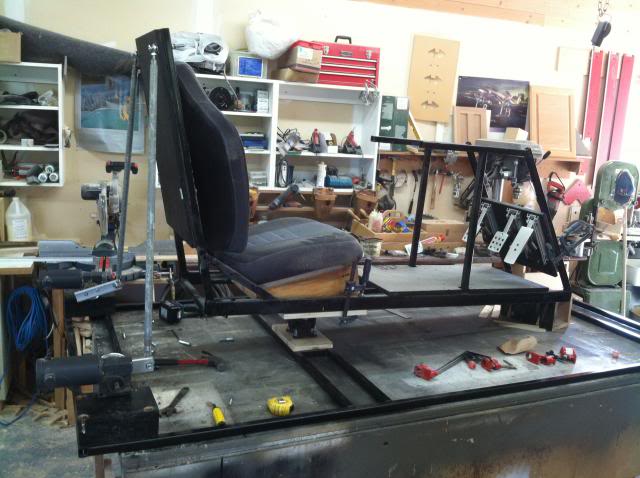

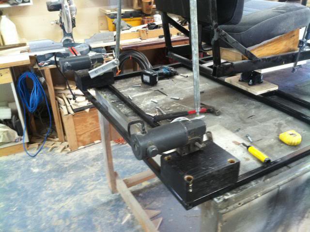

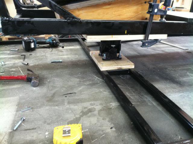

    Some progress:
    I need to finish the wiring harness and mount the potentiometers, then some testing to see if everything works.
  7. RacingMat
    2,233
    21,082Coins
    Looks good ! +1 :)
    This width will give you the needed stability.
    Ujoint looks solid !!
    Eager too see this coming to life soon :))
  8. Historiker
    2,162
    9,205Coins
    +2,173 / 19 / -1
    Thanks Mat, The over large base is so I can upgrade in the future to a 3DoF motion platform. I wanted to upgrade slowly, one step at a time ;)

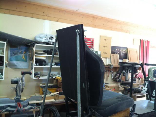

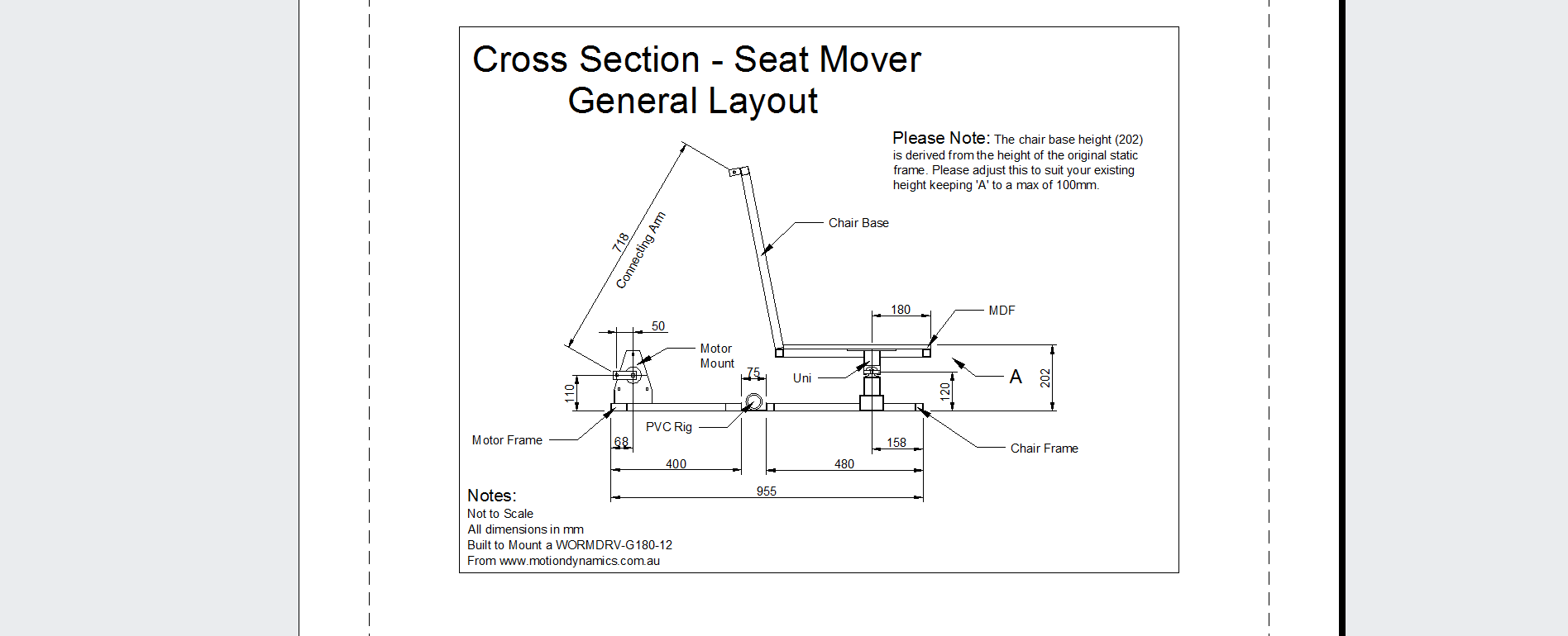

    Just one thing to pick on ya connecting rods angle is very shallow I tend to work with a min of about 60 deg, the more vertical this rod is the hard your motors will have to work, roll is the motion that will affect them the most.
    Basic principals of leverage, if you have to push vertically you are supporting 100% of the load and at 45 deg you are only supporting approx. 50% of the load so this angle can be a critical feature of have a sim move efficiently and fast.
    See how you go. Another did you set the pivot position correctly, ie mount everything on the sim , including you and monitors and accessories, then place a pipe under the base move it back and forth with you on it to find the balance point for your sim. Apart from that all looks good mate.

    Rob, excellent advice, thanks. I had not known about the proper angle on the supporting rods. I had kind of done an eyeball measurement from looking at other peoples setups. I can reverse the motor mounts and extend the pipes to allow a greater angle.
    Yes, I did balance the rig before mounting on the base. The yellow paint dob you see on the side is actually the CG with everything mounted (including me). I am also working up a method to adjust the pivot mount for other, lighter, drivers as well as future additions to the platform.

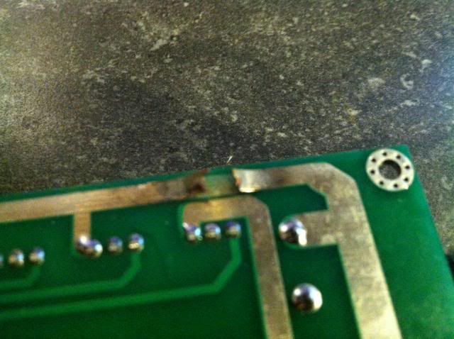

    Connected as per RacingMat's instructions on his thread. Start up the system connect power, verify that the Arduino is functioning correctly, etc. I double double double (triple?) checked all connections.
    Both motors disconnected from the seat, they spin at full speed in one direction until the arduino locks up and needs to be reset. The pots connected to the motors are functioning correctly. I checked them and the wiring harness using a sweep sketch with an R/C servo. The pots move the R/C servo in both directions with no stutter/shutter.
    After a couple of tries the driver controller burns out resulting in this:
    Odd thing is that it couldnt be drawing many amps, there is no load. 3A max I would guess. There are 15amp fuses in line with the motors as well.

    I tried your setup (arduino and wiring) with both boards. I must have done something wrong as both boards are fried. Both let out smoke and no longer function.
    What voltage did you use with your boards? The first run on mine was with 24v. After destroying the first board I tested with only 12v and the result was the same.
    Again, the motors were without load. Testing the motors connected directly to the batteries results in 3amp no load and 14.5 amp load at failure.
    It could be that both boards were just poor quality. This has happened before with Chinese eBay electronics. A 4-channel amp board that I purchased needed to have half the components re-soldered before it would work.
    I really cannot think of how I could have hooked them up in-correctly.
    Not blaming you at all, you have been a great help. I am sure the arduino settings are good. I am very suspicious of the cheap boards though.

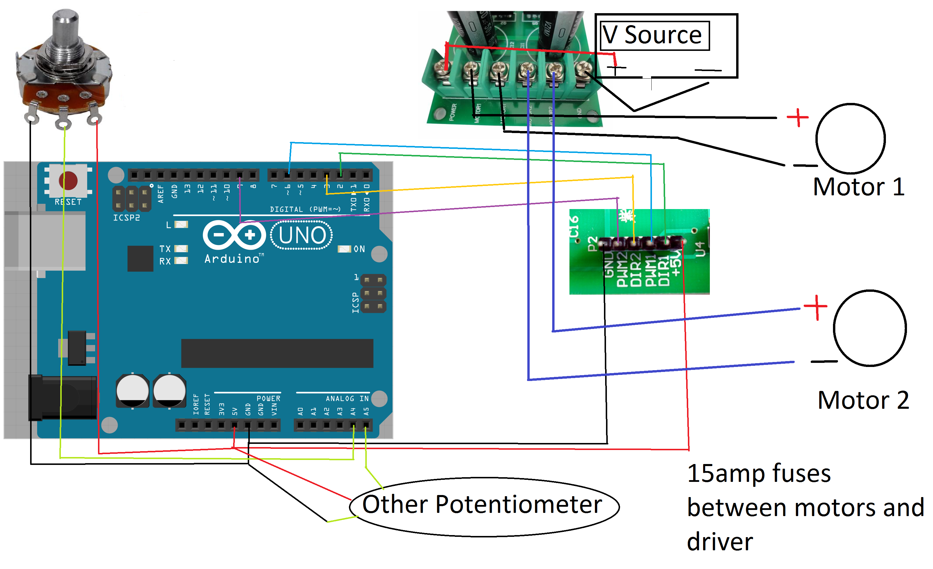

    Do you think my motors might be the culprit? Not sure how to test for that other than doing and amp draw test which I have already done.
    Here is a drawing of how I wired them. I did this both two motors on one card and with one motor per card. First run was with one motor per card, that is how I lost the first card, lol. I should have stopped. I then reduced voltage to 12v and hooked both into one card. Even more smoke and a larger pop.

    Mat, I am going to order the Pololu 755 motor drivers today. Hopefully I will not screw those up. I must be doing something wrong if I destroyed 4 our of 4 motor circuits on the chinese drivers. I am worried that I will do the same with these as well.
    Can you have a look at the picture that I posted above and verify that this is how you connected your boards?
    Another question about the Pololu 755, the specifications seem to indicate that you do not connect +5v and ground to the driver board at all but rather it uses the 24v input instead?
    In a typical configuration, only PWM and DIR are required.
    The V+ pin on the logic side of the board gives you access to monitor the motor’s power supply (it should not be used for high current).
    Thanks again for your help.
