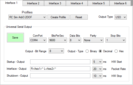

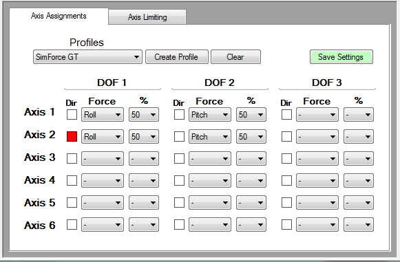

    It is 2AM (ish) here. Still no luck with those settings Rob. When I start output testing or a game (race 07) both servos go nuts; moving erratically back and forth. They actually tore themselves from the model, lol. Nothing some super glue will not fix ;)
    I studied the manuals for both the game engine and the game manager and everything seems to be working correctly with Race 07 although both Dirt 2 and Dirt 3 crash as soon as I start them up. The crash is before they pop on the screen leaving me with a normal desktop.
    Not sure what I am doing wrong, I am getting telemetry from the game when using it, and the admin window shows telemetry when using the output test screen. Eventually the ard crashes and has to be unplugged to reset, as well as crashing the game engine.
    Tomorrow I will swap out the servo's in case they both prove to be defective but I do not count this as likely. I tried each in turn without the other to test and both acted the same.
    I am using the sketch that aarondc posted on your RC thread and the interface settings that you took a screenshot of earlier.
    Here is a screenshot of my setup:
    Thanks again for your help, sorry to be a bother. As I get older these things seem to get harder, lol.

    When powering up model (ah could be an issue, to run more than one servo off the Ard Uno R3 I have found that a 5-6v 1amp Power Supply hooked to the Uno was needed. (radical movement, sometimes nothing) ) the servos should come to their centres and hold there until Sim Tools send them a command, Is this true on yours.
    Ah you made a little error, and when first testing disconnect the levers.
    The space is missing from Interface Output.
    Interface output should read R<Axis1>~(space)L<Axis2>~.
    If not give me some time and I will do a video of setting from uploading code to finished test in game.
    Need to test via Output testing before moving onto game mate.
    More info in my original post to come, sorry

    I added the space in the output but that did not seem to help the issue. I am also using an external power supply for the uno.
    When I plug in the Uno the servo's both snap to their midpoints (90 degrees) and hold there. They do not go haywire until the Uno starts to receive information from SimTools.
    The servo's are definately disconnected from the model now ;)

    After any changes in sim tool have you pressed the save button, important one.
    If just clicking the output test do the servos jump around ?
    Are you using the last code Aaron posted, first one caused this type of issue.
    Reflash Ard with last code show in my post.

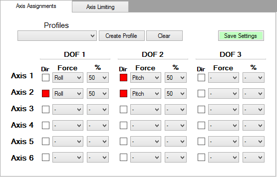

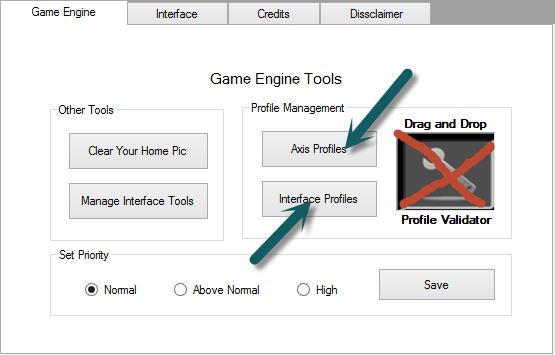

    Ok had a little time up my sleeve, Here is images of my axis and interface profile, including the profiles for coping onto your machine.
    Axis profile for above , start with this and if the motion seems inverted invert the roll , pitch to get this correct for you.
    Profile for the Interface settings , too supplied below.
    Note you will have to change the com port , after selecting the profile , change comport to -
    then select the com port the Ard is on.
    Ok the profiles
    RC Model Test Profile.zip
    Ok now open the zip and copy and paste this into the correct folders, to find these folder click on the arrows shown below and copy the right file to the right place, pretty straight forward. Sorry Auto Updater in that bit has a issue. Good old copy and paste.
    From there I would restart Game Engine and select each profile and save as you go and then test the output with the in built test app.
    Hope that helps , plus here is a quick vid showing settings and test. With all the above plus the last version of RC Model recoded By Aaron.
    http://www.youtube.com/watch?v=_Eo9jTs8QUE
    :cheers:

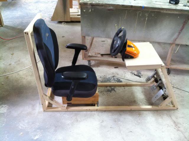

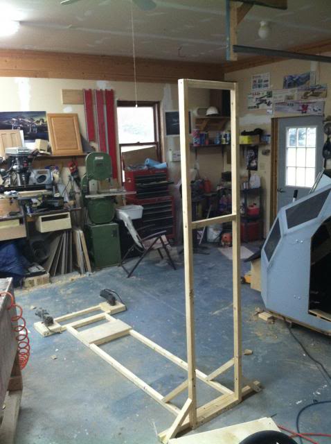

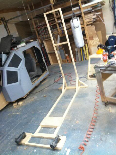

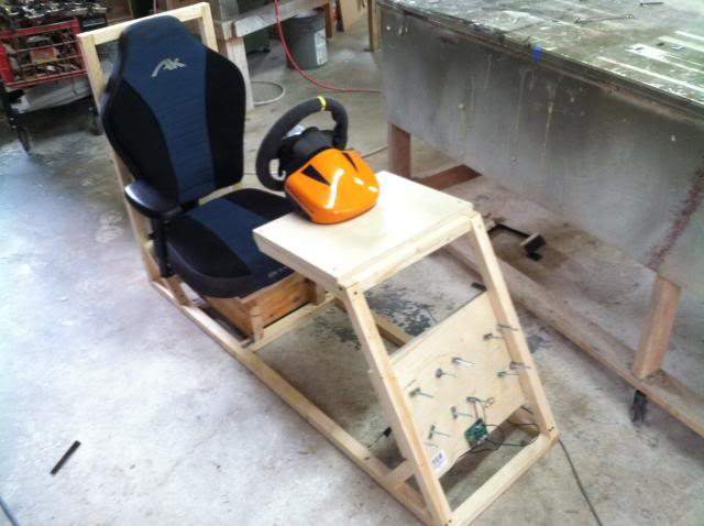

    On a different note, (this is where someone hums or whistles); I put together my wooden prototype today:
    The motion platform. I found that I need to stretch it a bit as my long legs are scrunched up too much. But still usable. I will make those and other changes to my design.
    The motion base, the monitor tree is really tall but you will see why in a bit.

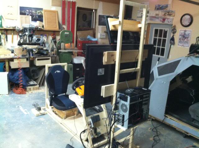

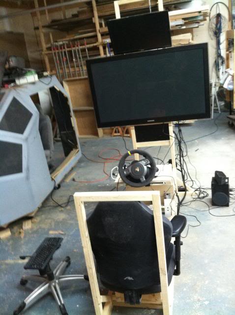

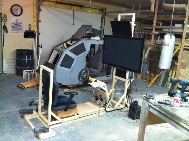

    And assembled with the PC, and two of the five planned monitors (see why I need that tall tree?)

    off topic what is the other sim pit in the background.

    In the background is my Mechpit. I built it to play Mechwarrior Online as I am a huge Battletech geek but that game stagnated into a first person shooter rather than the Mechwarrior sim that had been promised unfortunately. I recently converted it to a race pit but as I mentioned in the first post; I was worried that if I tried to use it for motion it would fold in on me! ;)

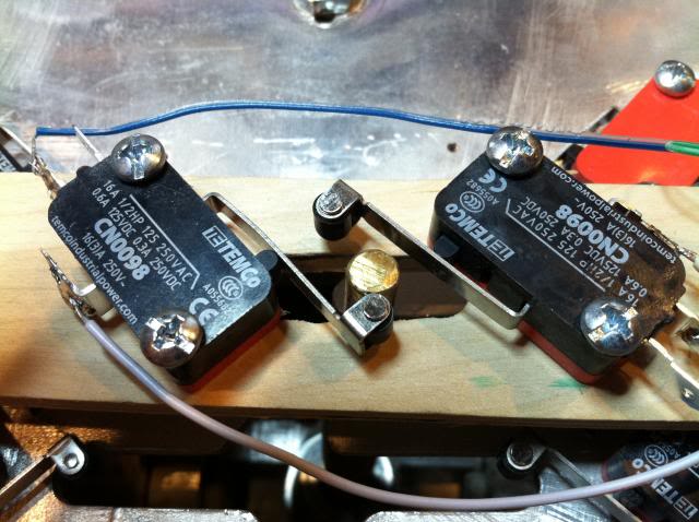

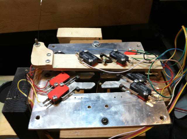

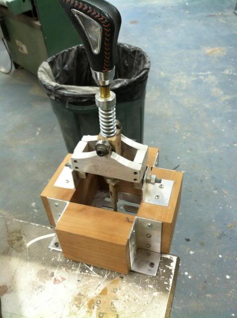

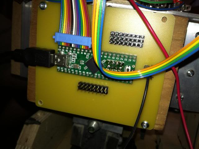

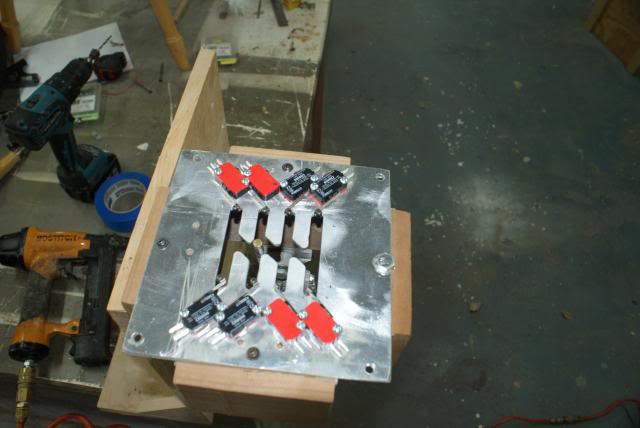

    Since I am not getting much done on the motion project I thought I would share something that is actually done...well...pretty much done. Still want to replace the plywood with an aluminum plate and make a lever system rather than the pull rod to engage the sequential mode.
    My DIY shifter thanks to Elnino and Willynovi for posting their designs and sharing ideas.
    DX Input is via a Teensy++2.0 controller board (Arduino compatable) programmed to be a 32 button/8 axis joystick.
    I can engage sequential mode by lifting a rod which brings up the platform with two additional switches and captures the bottom of the shifter arm.

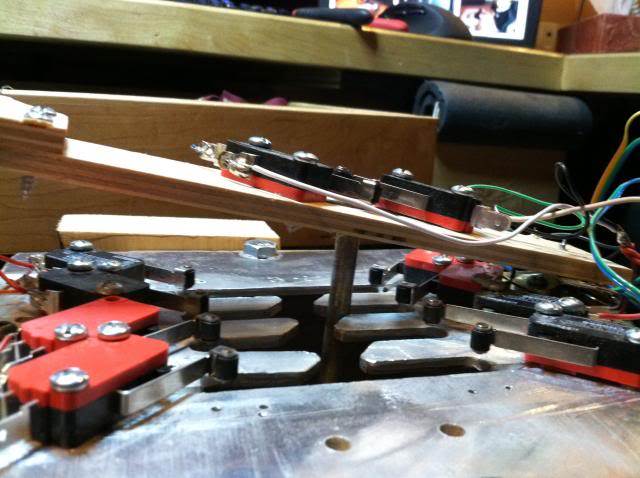

  13. bsft
    Thanks for the ducks guts pics.
    Good to know whats inside.

    This has to be the first complete setup I have seen, well done looks brilliant. :clap: :clap:

    Thanks gents, the shifter is incredibly smooth and best of all it has the weight or heft of the read deal. The action is spot on as well.
    I just have to find a why to make an enclosure for it on the motion platform. In the enclosed pit it was easier I just bolted it under the console.

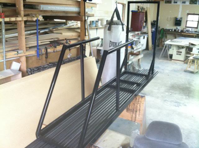

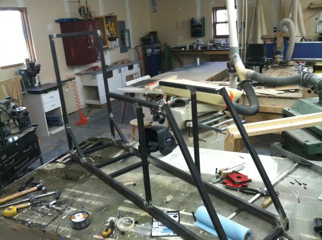

    The motion pit in the embryonic stage. The steel was purchased at PADNOS Recycling Solution in Cadillac Mi. Thanks Wayne and Chris for your help! Both were extremely interested in this project and wanted to follow along so after being given their business cards I emailed them the thread. I look forward to their input.
    I picked up a 90amp mig welder from Harbor Freight (a discount tool store for those who have not yet heard of this chain). For 99.00 it works very well, not a professional tool but good for the hobbyist. It is rated for steel up to 3/16 thick and seems to work very well.
    I purchased 1x2x.125 tube for the base rails of the motion platform and base. The 1x1x.125 will make up the bulk of the design.
    The motion platform assembled. There will be plywood sheets bolted on to help with the rigidity.

    Cool looking good, just beware of ya weight for the motion table, I tend to use 25x25x1.6 SHS Dural Gal in my normal creations , moving frame needs to light but rigid to aid in being able to mount everything on and not get too heavy, my old base weigh in at 12kg without seat and wheel, seat was 3kg and wheel wasn't much heavier all up.
    But in turn if you balance point is in the right place its not too bad, weight will affect the interia the motors need to punch at to change directions and when they are changing every 10ms, too much weight or in correct balance will cause the motion to fell lagy
    But keep us all informed looking good.

    I picked up a trailer wheel hub today that would be perfect for adding a 3rd dof for traction loss. I have flush mount rollers and if I create a second layer for the motion platform and a third 24v wheel chair motor as well as various sprockets and chain to provide linkage for the traction loss module.
    The motion platform painted up pretty
