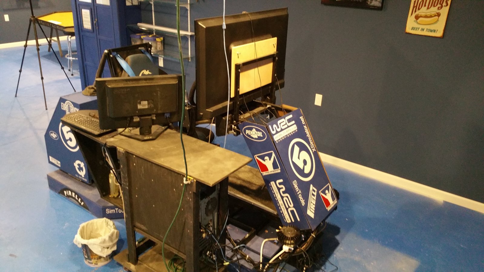

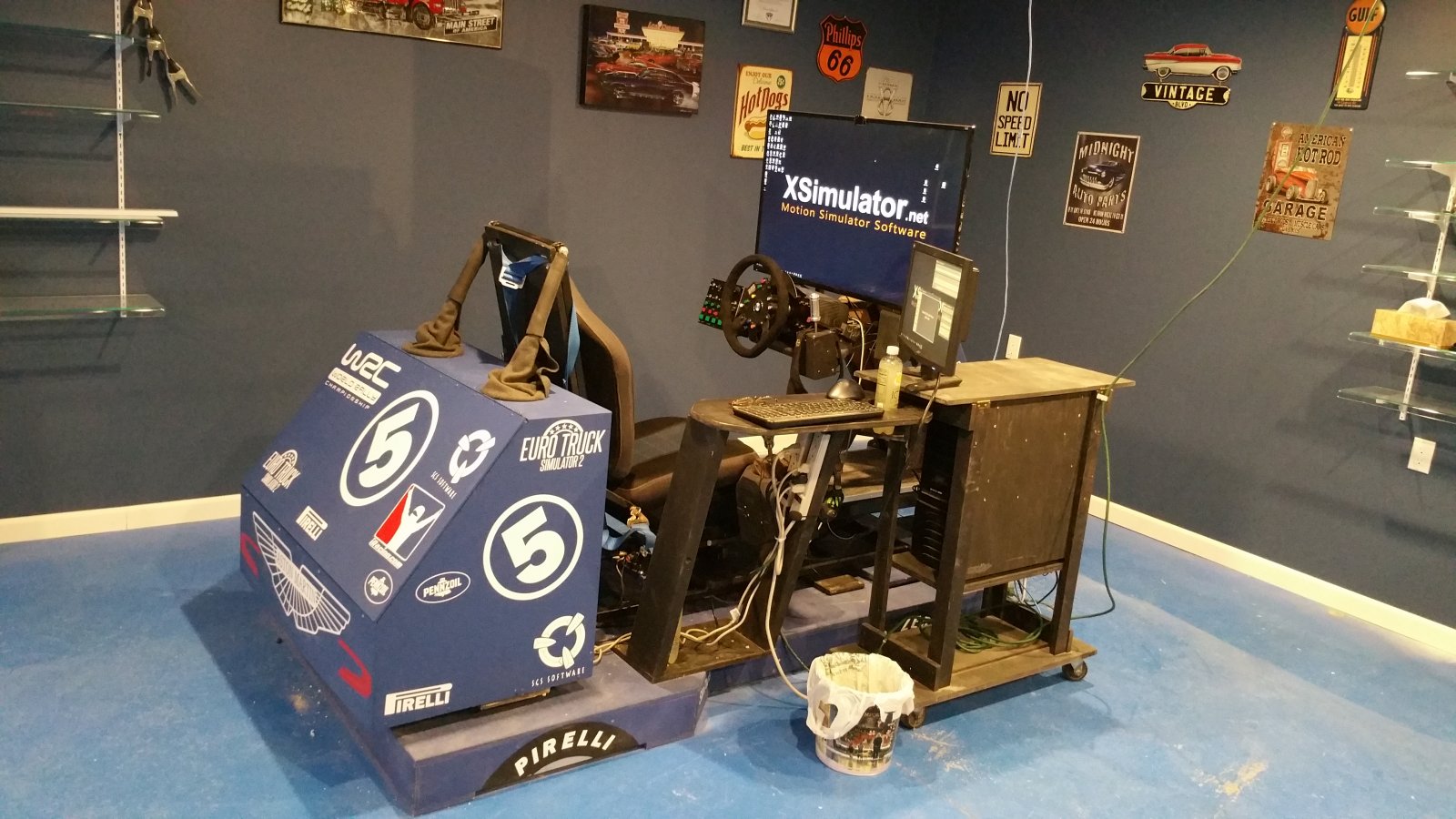

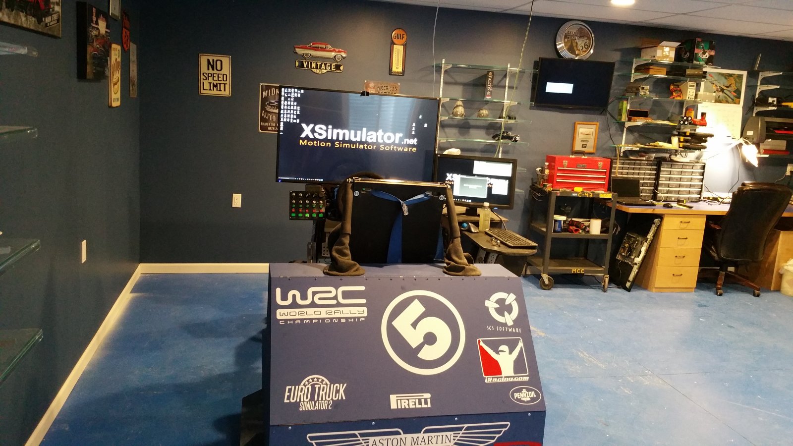

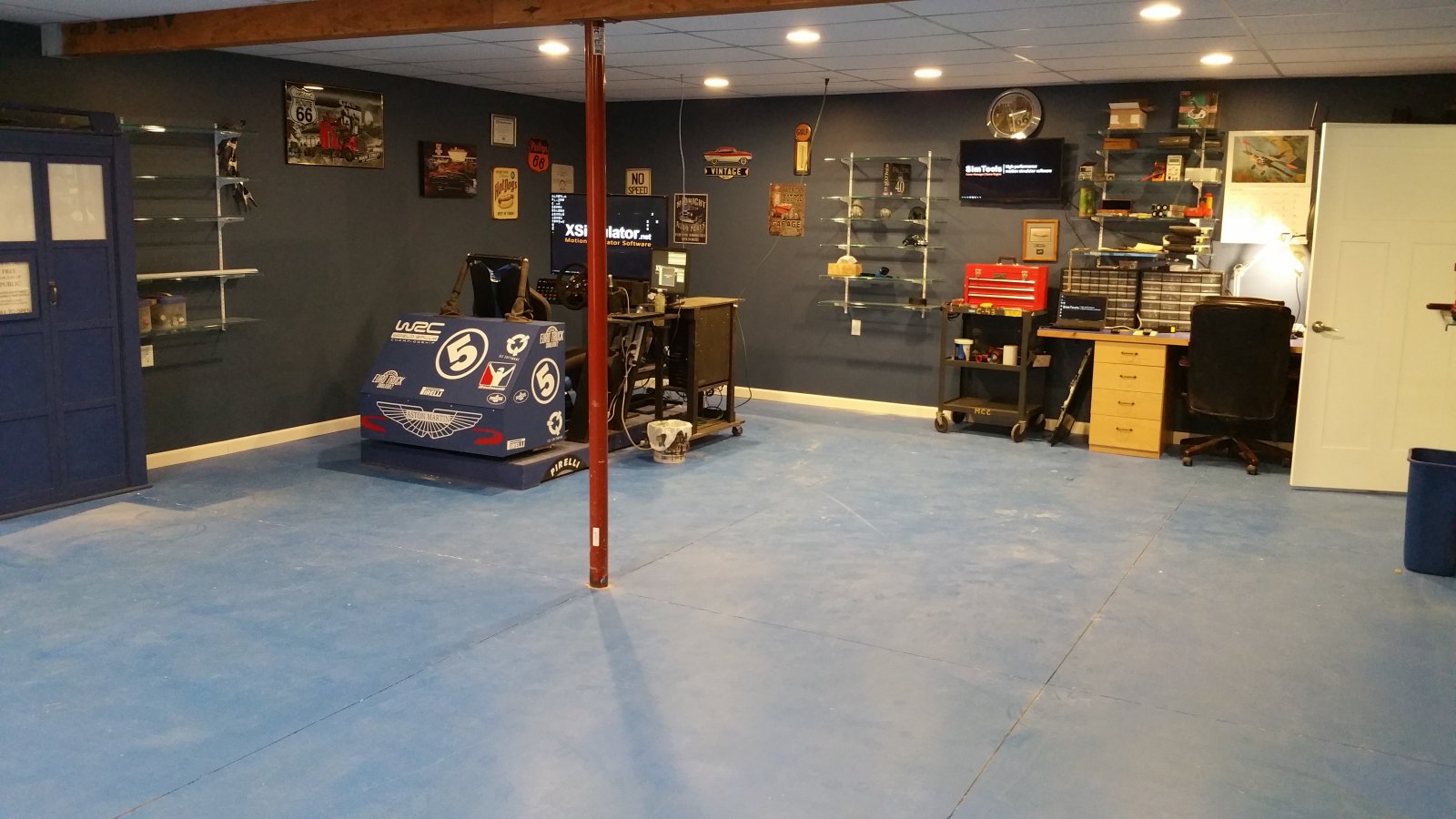

    The Simpit has a new home!

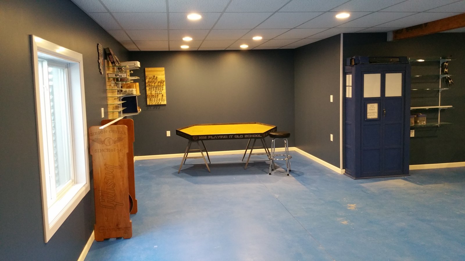

    Last week my wife and I completed the Man Cave, I spent the rest of the time setting up my motion pit.
    My gaming table area. I will add several floor to ceiling book cases eventually, and this area will be carpeted. I am also thinking of adding a peninsula bar to further separate the gaming area.

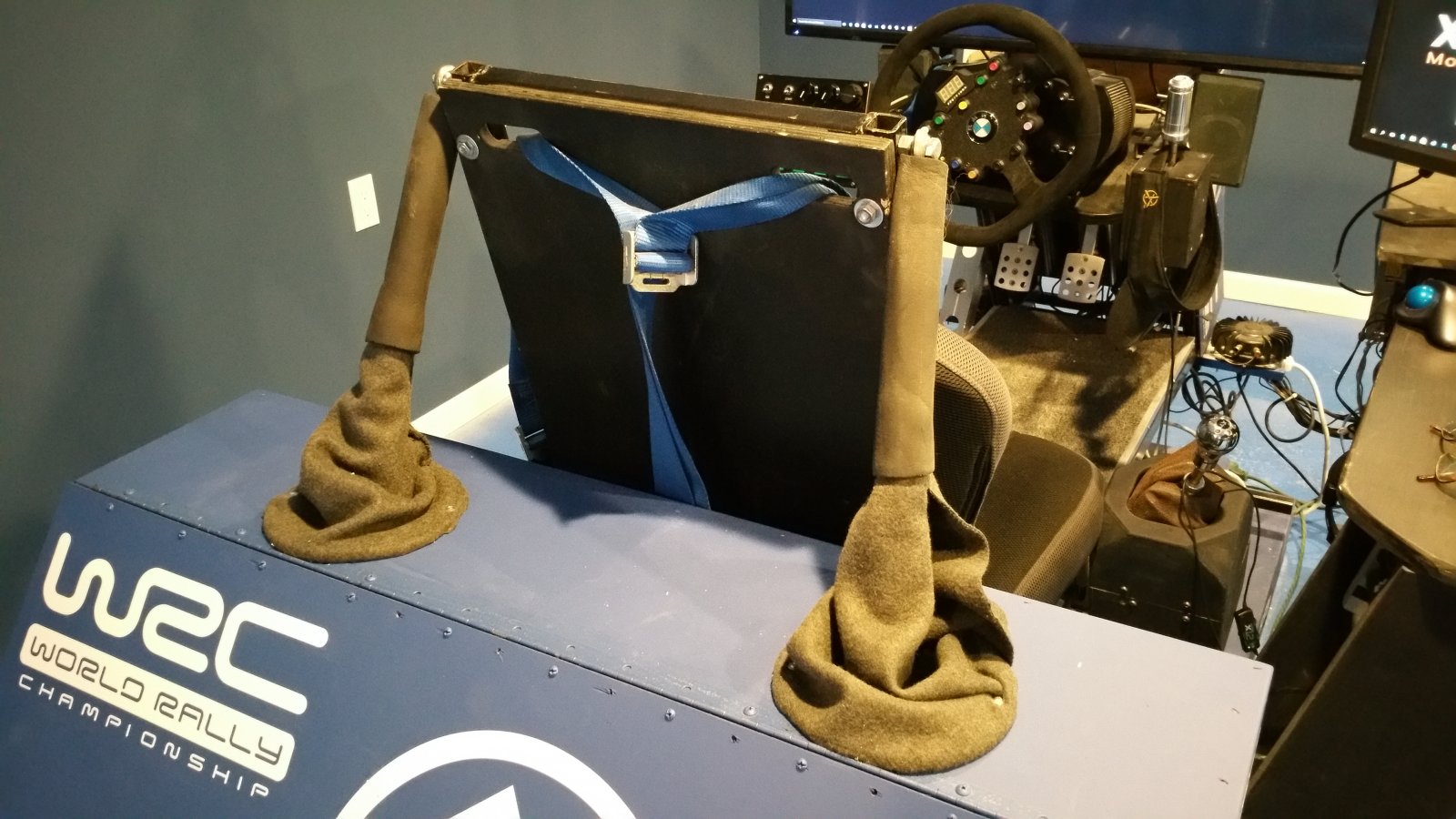

    Added an enclosure for the motors and boots for the actuator shafts.

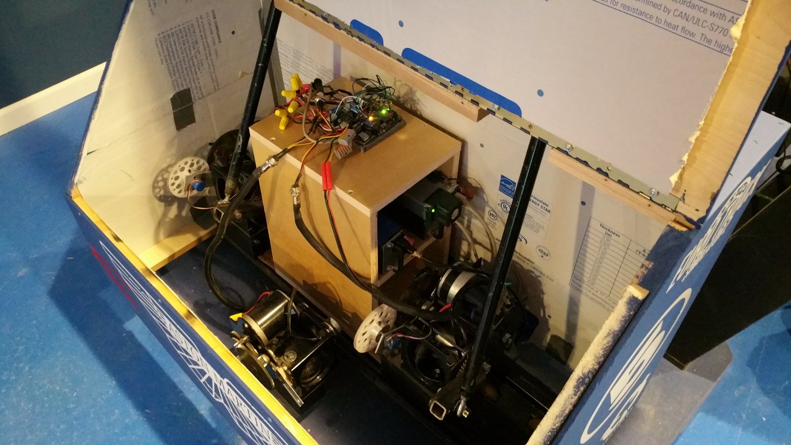

    The power strips are mounted next to the seat to allow me to turn everything on at once (including the PC)
    Behind the door is my electronics bench, very convenient for the simpit. There is plenty of room next to the driving pit for my flight sim pit as well.
    The enclosure greatly reduces the noise of the winches. The 3/4" foam board helps a great deal. The bottom is open allowing cooler air into the box and there are 120mm fans in the front of the box pushing hot air out.
    One of these days I will clean up my wiring....maybe :) The plywood cabinet allows me to stack my PSUs (I installed one for each winch just in case).
    I do need to clean the PC cabinet, that thing looks dusty.
    Video's to follow (no, really I will post a few). I will work on them tonight.
