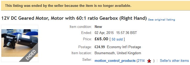

    What do you mean with "broken"? When I click on the links, I get to the product at ebay.co.uk. It just says that the listing was ended. See the screenshot below. ListingEnded.jpg
    I checked the web site of this vendor (http://www.motioncontrolproducts.com/) a while ago, and he seems to have taken the motors out of his stock.
    That's bad, because now there is no European vendor anymore.
