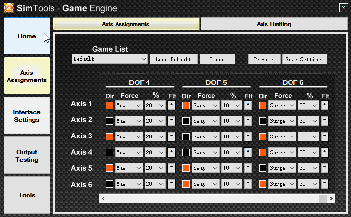

    Before I test LFS in my old laptop, the SIM is shaking even the car is stop, and the SIM works unordered,
    today I tested in my new Gaming PC, and it's the same. looks the SIM TOOLS receive some wrong signal form LFS game.
    I looked at the tuning center, even the car is stoped, the value in tuning center is changing from minus to plus. Someone met this same issue before?

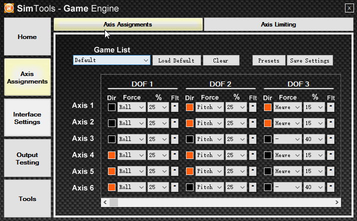

    I'm so careless, I didn't notice the language bug in FAQ, and all my test and research I did before are wrong.
    Today I changed the language to English now works reasonable, and I got some more understanding.
    But there is still a problem I don't why, when I drive some times the yaw signal is wrong, most of time it show 100% or -100%, even the car is stopped.
    I will try to unpatch and patch the LFS again.
    below is the setting and Video.

    when I stop the car, all the signal except yaw will reset to 0,
    why YAW didn't reset? is it normal?

    2,573
