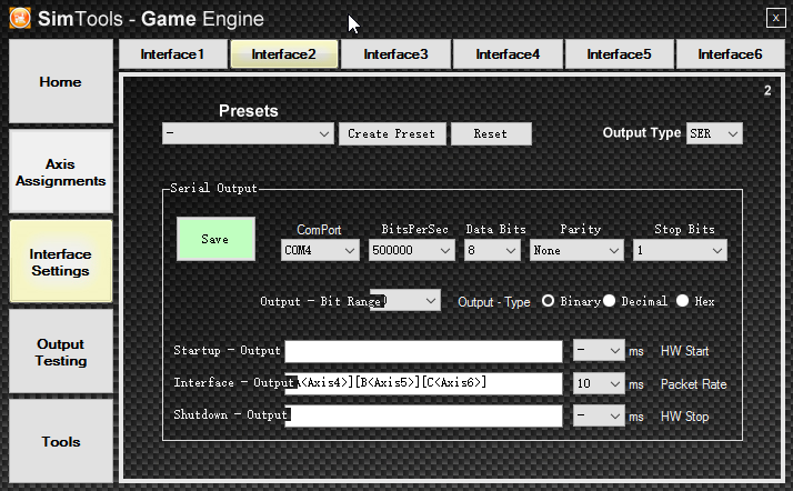

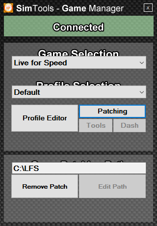

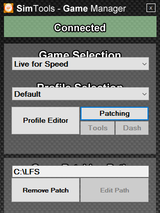

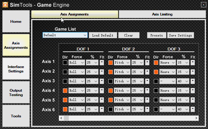

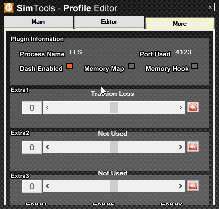

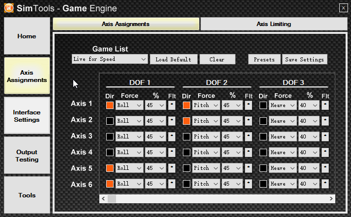

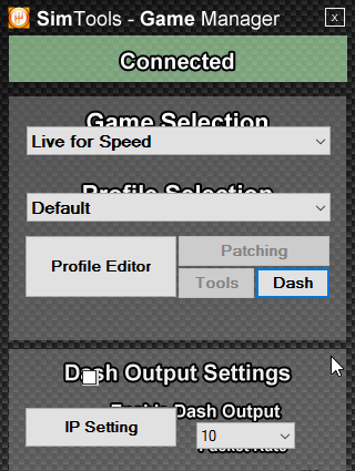

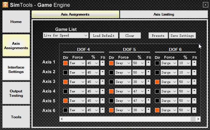

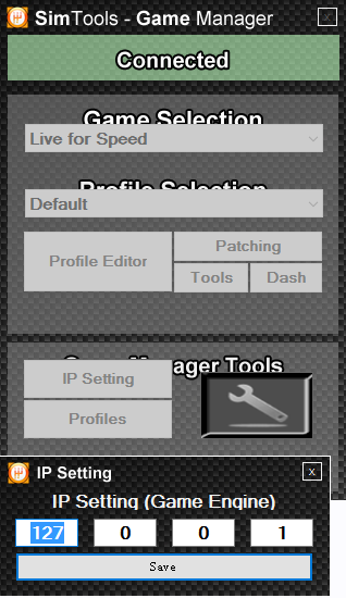

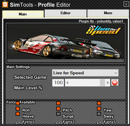

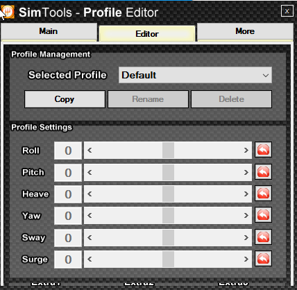

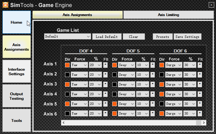

  8. Racing Mike
    Racing Mike Member
    Apr 24, 2016
    99
    Chile
    348Coins
    +34 / 0 / -0
    smc3 utils is closed, I can perform output testing in simtools. so the interface setting should be OK.

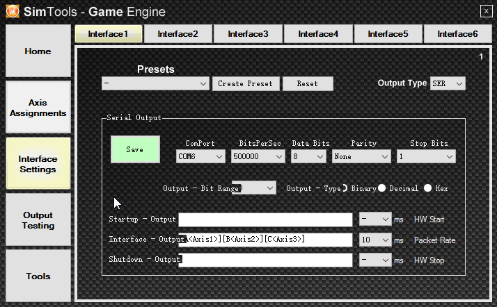

    when I start LFS, the RX LED in Ard is light but TX LED is off. when I quit LFS, RX LED turn off.
    I attached some configuration picture, please your help to check, thanks very much. @bruce stephen @noorbeast

    Have you setup the Simtools Tuning Center values - you didn't post a screenshot of them?
    Also is your windows setup with region/language US English - Simtools has a problem with some languages.
    21,720
    152,027Coins
    +11,062 / 56 / -2
    From the screenshots the first thing you need to fix is the known DPI bug: http://www.xsimulator.net/community/faq/game-manager-dpi-fixes.123/
    Next up your Axis % allocation totals are too high: http://www.xsimulator.net/community/faq/axis-assignment-percentage-totals.120/
    If output testing works then it would seem a configuration issue. Did you run a couple of laps in LFS before you patched it, as LFS first needs to generate the base files. If not unpatch, run some laps and then re-patch.
    Once you get it moving it pays to tweak the motion profile one axis/force at a time: http://www.xsimulator.net/community/faq/steps-to-create-a-motion-profile.228/

  11. Racing Mike
    Racing Mike Member
    Apr 24, 2016
    99
    Chile
    348Coins
    +34 / 0 / -0
    I ran a couple of laps in LFS after patch LFS, this should be the reason.
    I just uppatch LFS, ran LFS and then patch again, now it's works. thanks all. I will continue test Axis assignment.

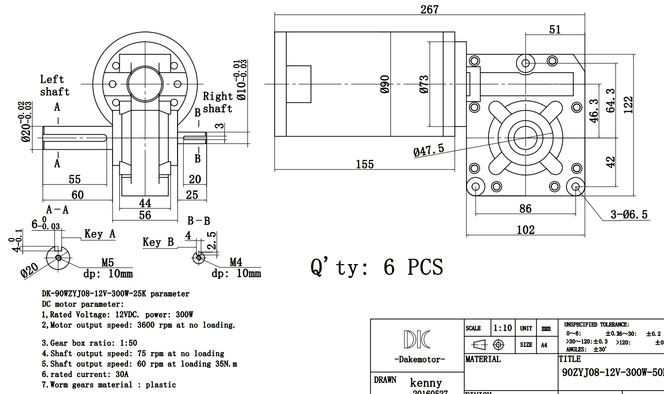

    Hi all, I contact a seller recommended in forum in alibaba, below is the specification he sent to me.
    Is it necessary order the faster motor with 120RPM, but about 18 N*m?
    60RPM is enough for my 6DOF or not?
  13. noorbeast
    21,720
    152,027Coins
    +11,062 / 56 / -2
    Personally I think the higher torque will be useful and 60 RPM will be fine.
  14. bruce stephen
    Jun 7, 2015
    1,286
    general contractor
    michigan
    9,115Coins
    +1,243 / 9 / -0
    Mine is 41 rpm. 60 is ok. Use a longer lever if you want it to go faster (torque is sacrificed).

  16. Racing Mike
    Racing Mike Member
    Apr 24, 2016
    99
    Chile
    348Coins
    +34 / 0 / -0
    Update:
    I have bought some spart part to improve my model sim, now it works better. I record a video(roll, pitch, heave, yaw, sway, surge), please someone help to check how to optimize the axis assignment.
    Motor left front >> axis 1
    motor left middle >>axis 2
    motor left rear >> axis 3
    motor right front >> axis 4
    motor right middle >> axis 5
    motor right rear >> axis 6
    Question: the % of each axis and dof, I tried to modify it to see the affect, but I didn't found the rule, can someone teach me what is the function of it, and how to use this parameter. thansk in advance.
