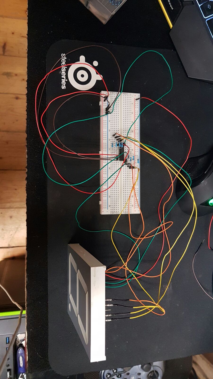

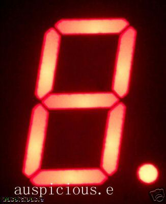

    I found a 3inch 12v display in my stock but it's common cathode .
    It seem to be more complicated to drive it (mainly because it is 12v, there is a driver for 5V, not for 12)
    Maybe anyone have a solution ?

    Common cathode will require to source current rather than sink it... You will have to find anoter chip reference. Or maybe someone could advise you (as I have no computer access this week)
    As 4" is better than 3" ;-) you could order a 4" common anode :p

    I think that I'll buy a new one, it will be more simple.

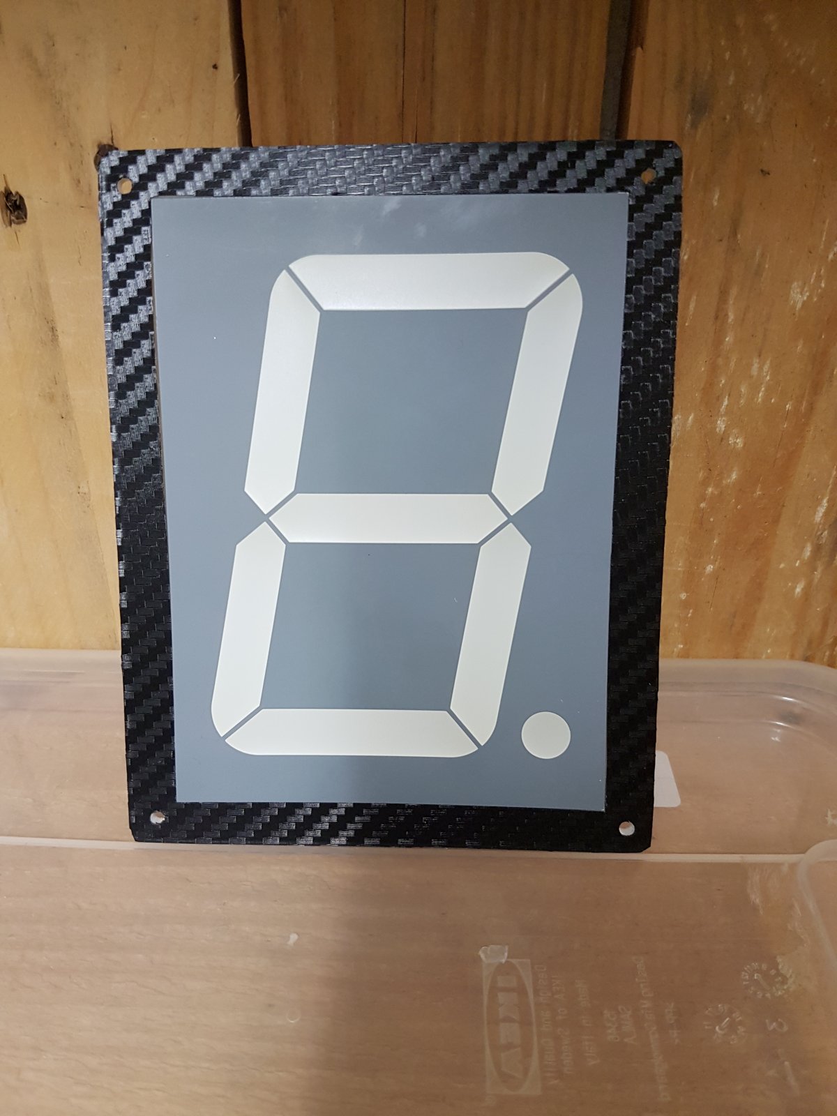

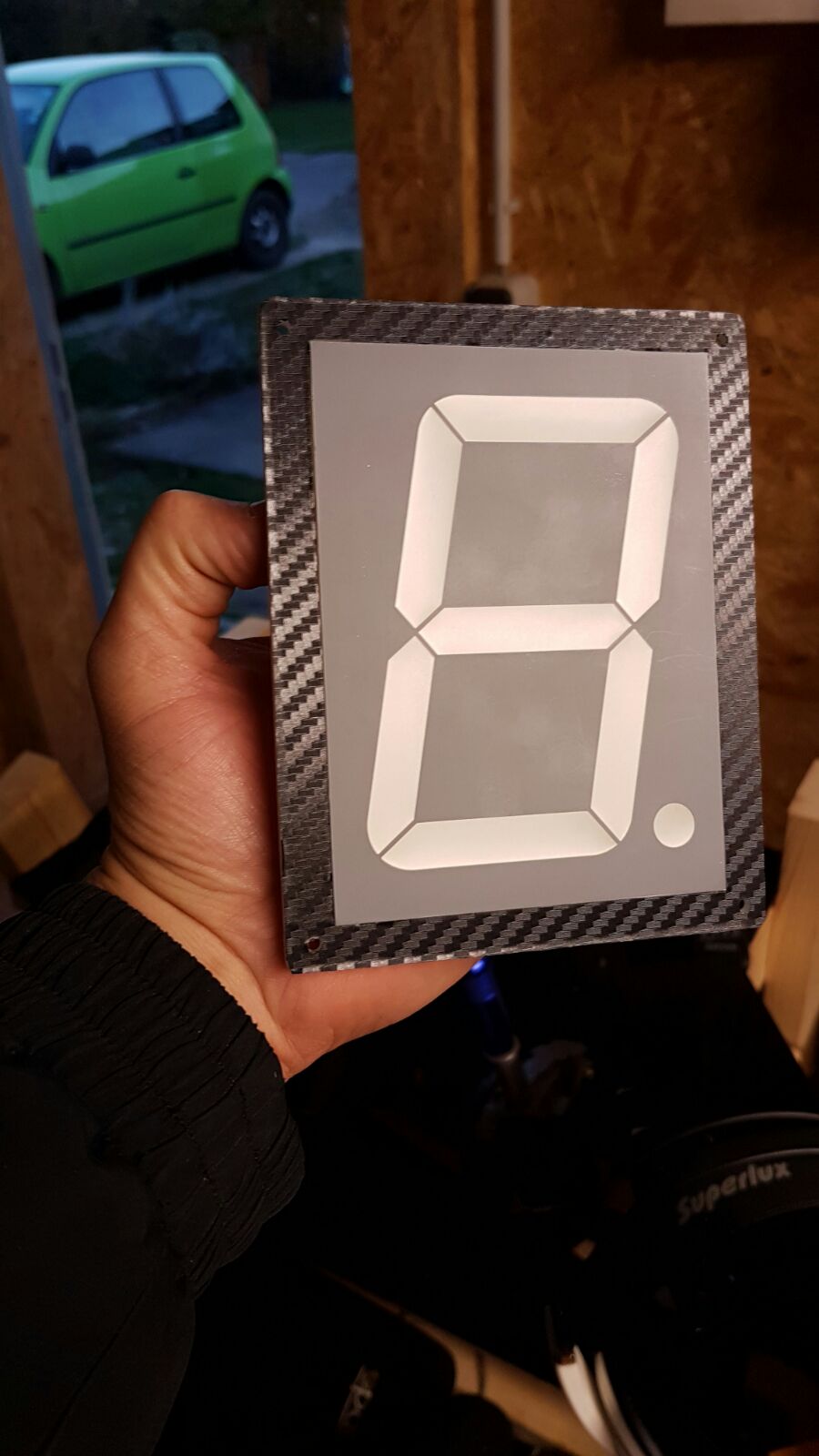

    Nice On,
    I build this one & it´s great but i can not download plugins to test :)

    Ok here some Pics
