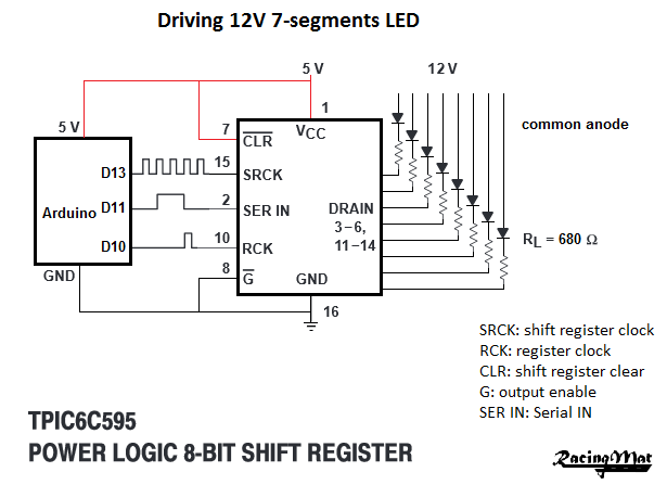

    Hi guys!

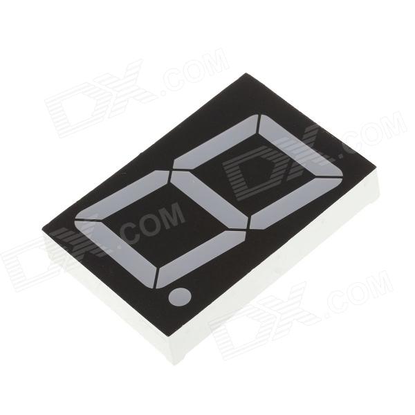

    I have got a 4 inches 7-segment LED and arduino: let's start a Gear Indicator!
    12cm x 7cm
    The closer specs are these :
    http://www.led-display.cc/Single-Di...4-Inch-Single-Digit-7-Segment-LED-Display.htm
    I bought TPIC6c595 : a power logic 8-bit shift register
    This works with common anode and can sink high voltage (50V and 150mA) http://www.ti.com/lit/ds/symlink/tpic6b595.pdf
    It will need only one resistor per segment (less soldering! than transistor + 2 resistors)
    Here is the schematic between arduino and 6c595

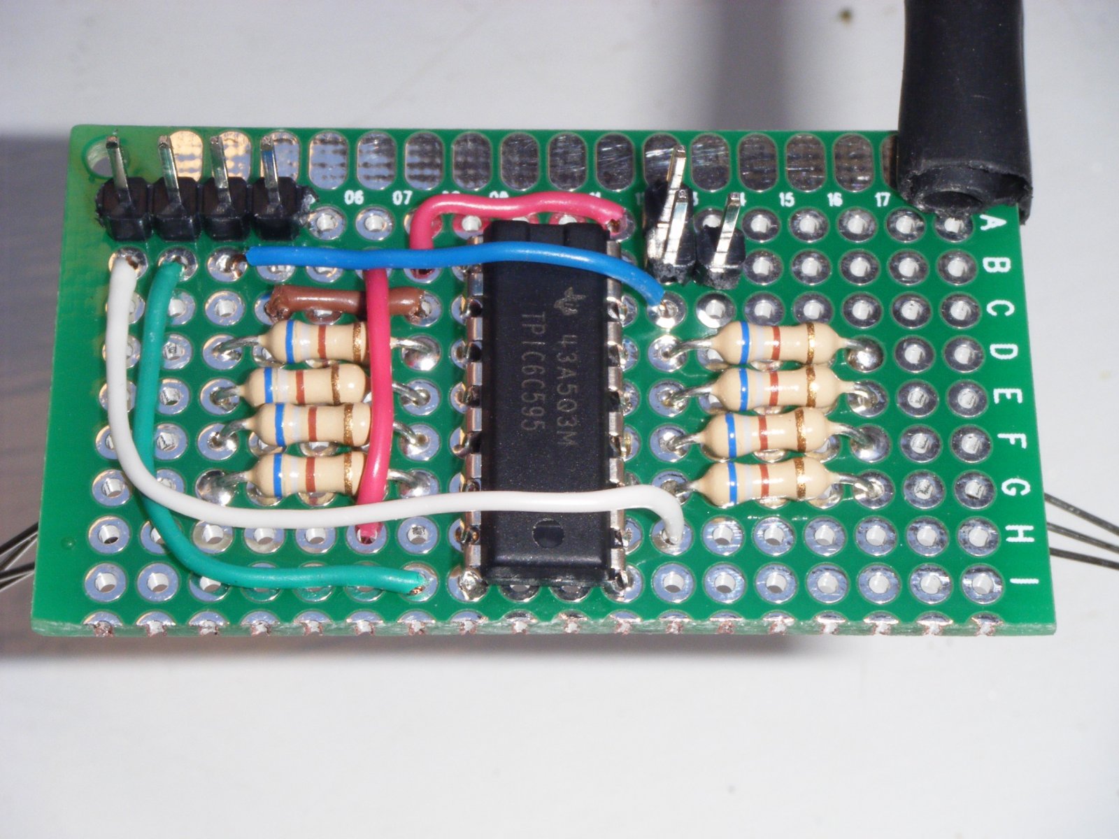

    Some pictures of the protoboard:
    the board lost in the middle of the giant LCD :D

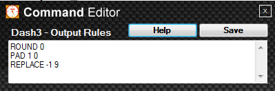

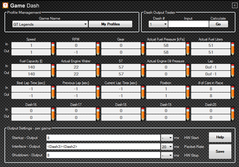

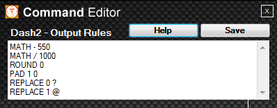

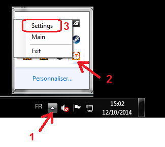

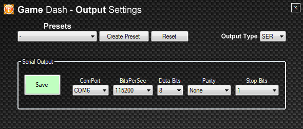

    2/ setting up GameDash
    Screenshot of GTL plugin showing what each data represents in the game
    I'm using only Gear and RPM in this tutorial
    gear : just replacing reverse which is "'-1' in GTL by a single character '9'
    RPM : math calculation to determine if RPM is over a limit or not
    then replacing 0 or 1 by other ascii characters to fit to the simple arduino code
    Now you have everything available to do exactly the same!

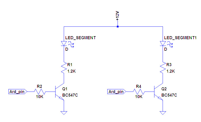

    Can someone help me to setup a "giant" gear indicator ?
    but the LED are 12v driven...
    I have googled some links but too old: some components are no longuer available...
    Do you know how to drive a common anode 12v 7-segment with Arduino ?
    Thanks!!
    Mat

    3DOF, DC motor, Arduino, 4DOF

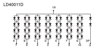

    @RacingMat , you can try this schematics - one npn and two resistors for any LED segment
  5. RacingMat
    2,237
    21,031Coins
    Thanks @prilad !
    Good, it's rather cheap: BC547CG 0,11€ + resistors

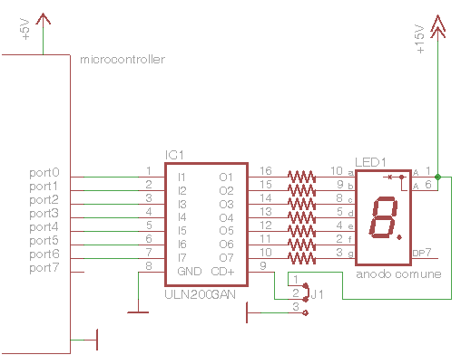

    I have read that ULN2803 darlington array could work but not sure... R0403636-06.png

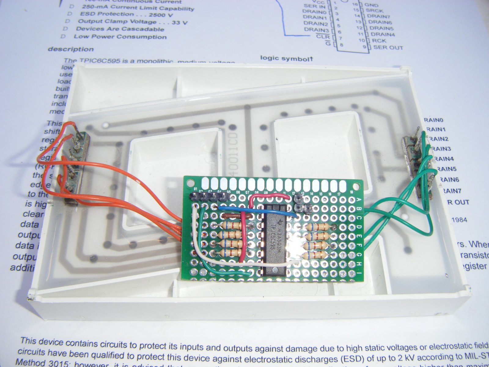

    Hi!
    Next steps :
    1/ coding arduino
    2/ testing with GameDash
