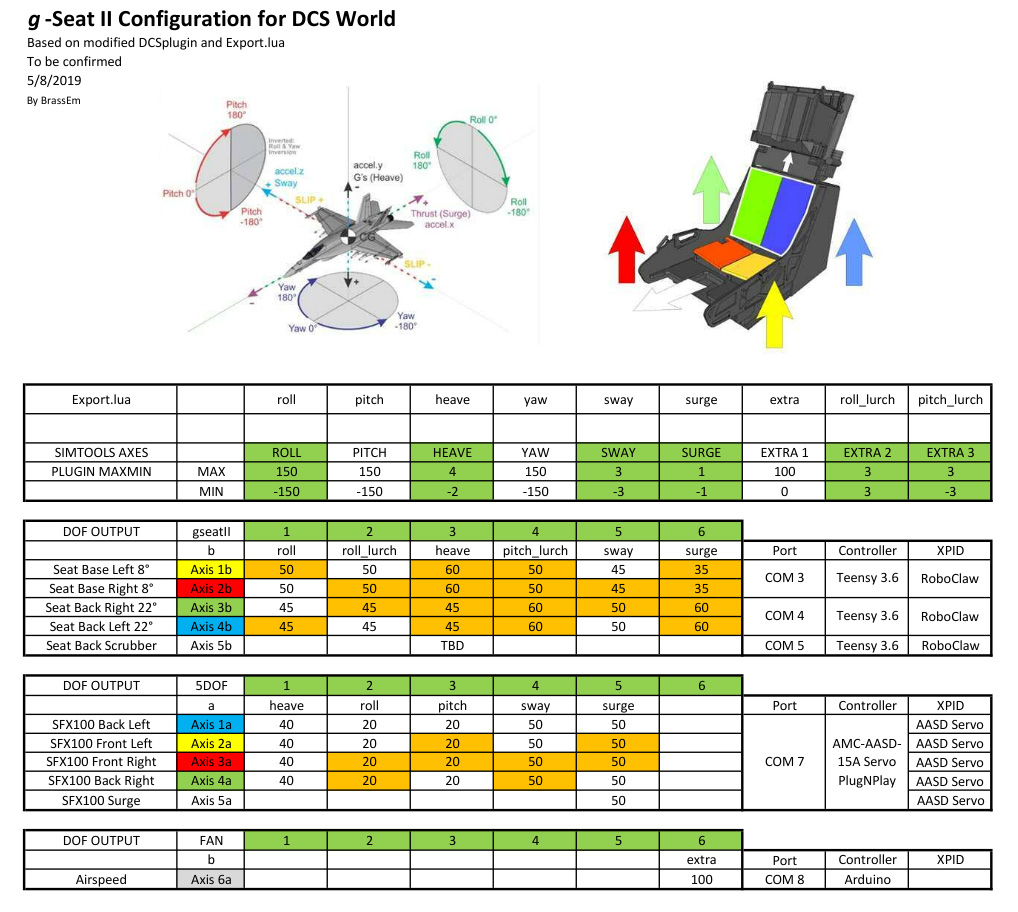

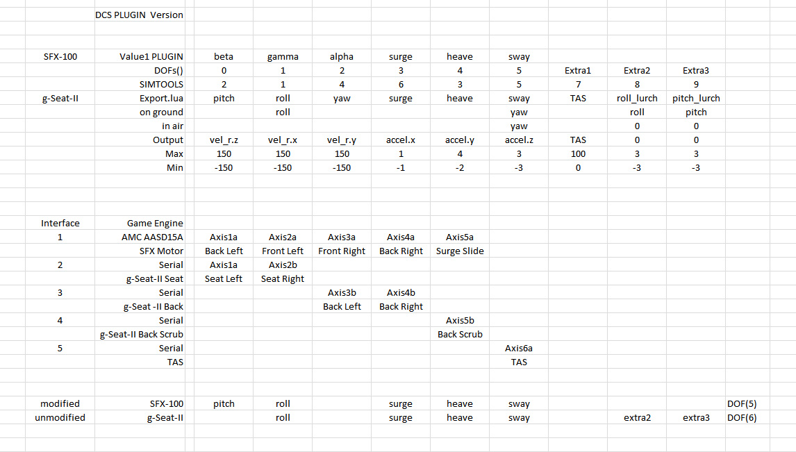

    G'day,
    I am working towards using SIMTOOLS to command my sim rig which has an SFX-100 base with my g-Seat-II on top of it.
    My understanding for SIMTOOLS for use with DCS;
    DCS -> 9 values -> PLUGIN -> 9 outputs (DOFs) -> GAME ENGINE -> Axis1a-Axis6a/Axis1b-Axis6b -> Motors
    For my hardware setup I need the following GAME ENGINE outputs from the 9 inputs from DCS;
    pitch, roll, surge, heave, sway. -> Axis1a-Axis5a for SFX100 DOF(5)(Matrix calculations from input, modified)
    roll, extra2, heave, extra3, sway, surge. -> Axis1b-Axis4b for g-Seat-II DOF(6) (Straight through from input, not modified)
    I need both modified and unmodified variables;
    modified;
    pitch
    unmodified;
    extra2, extra3
    I need eleven outputs all up. Is this possible?
    Do I need to create a math plugin to command GAME ENGINE with individual AxisXa/AxisXb for each DOF output (5 and 6)? Or does it still get channelled throught the 9DOF?
    Cheers,

    The trouble is I need 11 different variables/channels/DOF's to mix around to the controllers.
    9 input DOF's, from that, 6 modified output DOF's, and 5 unmodified output DOF's.

    I do understand portioning the output to axes, which I intend to do so in GAME ENGINE as per the diagrams above. The problem is getting all the data output.
    So for my plugin as per the 2.0 Plugin API example;
    Output from DCS; (***** NOTE 9 VALUES HERE ****** )
    socket.try(c:send(string.format("%.4f; %.4f; %.4f; %.4f; %.4f; %.4f; %.4f; %.4f; %.4f;\n", pitch, roll, yaw, surge, heave, sway, TAS, roll_lurch, pitch_lurch)))
    DCS PLUGIN CODE; (Relevant portions only)
    Private Const _PluginAuthorsName As String = "value1/yobuddy/brassem"
    Private Const _GameName As String = "DCS"
    Private Const _ProcessName As String = "DCS"
    Private Const _Port As String = "41230"
    '/// DOFs Used for Output for this Game ***** NOTE 9 VALUES HERE ****** ///
    Private Const _DOF_Support_Roll As Boolean = True
    Private Const _DOF_Support_Pitch As Boolean = True
    Private Const _DOF_Support_Heave As Boolean = True
    Private Const _DOF_Support_Yaw As Boolean = True
    Private Const _DOF_Support_Sway As Boolean = True
    Private Const _DOF_Support_Surge As Boolean = True
    Private Const _DOF_Support_Extra1 As String = "TAS"
    Private Const _DOF_Support_Extra2 As String = "roll_lurch"
    Private Const _DOF_Support_Extra3 As String = "pitch_lurch"
    'Used by GameEngine to Process Incoming UDP Packets from DCS.
    Public Sub Process_PacketRecieved(Text As String) Implements IPlugin_Game.Process_PacketRecieved
    'Split incoming UDP packet to their appropriate variables. Incoming packet data is Pitch, Roll, Yaw, Surge, Heave, Sway, TAS, roll_lurch, pitch_lurch.
    Dim Pitch_Input As Double = CSng(DOFs(0))
    Dim Roll_Input As Double = CSng(DOFs(1))
    Dim Yaw_Input As Double = CSng(DOFs(2))
    Dim Surge_Input As Double = CSng(DOFs(3))
    Dim Heave_Input As Double = CSng(DOFs(4))
    Dim Sway_Input As Double = CSng(DOFs(5))
    Dim TAS_Input As Double = CSng(DOFs(6))
    Dim roll_lurch_Input As Double = CSng(DOFs(7))
    Dim pitch_lurch_Input As Double = CSng(DOFs(8))
    'SFX-100 Calculation code here;
    6 DOF Rock and Roll Platform vector calculations
    'g-Seat-II Calculation code here;
    G Seat vector calculations
    (***** NOTE 9 VALUES HERE AND CLASH OF DESIRED OUTPUTS ****** )
    Roll_Output = Roll_SFX-100_Calculation-Result OR Roll_g-seat-II_Calculation_Result ?????
    Pitch_Output = Pitch_SFX-100_Calculation-Result
    Heave_Output = Heave_SFX-100_Calculation-Result OR Heave_g-seat-II_Calculation_Result ?????
    Yaw_Output = Yaw_SFX-100_Calculation-Result
    Sway_Output = Sway_SFX-100_Calculation-Result OR Sway_g-seat-II_Calculation_Result ?????
    Surge_Output = Surge_SFX-100_Calculation-Result OR Surge_g-seat-II_Calculation_Result ?????
    Extra1_Output = TAS_Input
    Extra2_Output = roll_lurch_g-seat-II_Calculation_Result
    Extra3_Output = pitch_lurch_g-seat-II_Calculation_Result

    You may be right Thanos. It all started with DCS and g-Seat-I only. The original plugin does matrix rotation for a resultant normal to the seat plane which is 6 modified outputs. Brilliant for SFX-100. I just needed pure surge, heave and sway output for the g-seat which is another 3 outputs, (normal to g seat plane?). I found that the fidelity of motion for the g-Seat-I was not proportional while on the ground. in the air, and between aircraft. This was accentuated when I started flying the prop aircraft. Hence the two extra output channels of data to feed into the seat to compensate. Now there is need for Fan control, belt tensioning system, etc. I was very happy with how things were progressing that way. The SFX-100 motion platform is new to me and a real game changer! Unfortunately I am still in the build stage with my g-Seat-II and SFX-100 rig and cannot start testing fidelity yet. Just laying out some ground work now. (BTW your AMC-AASD15A controller was a dream to setup, all I need to do is bolt the motors onto the frame and job done. Thank you!!)
