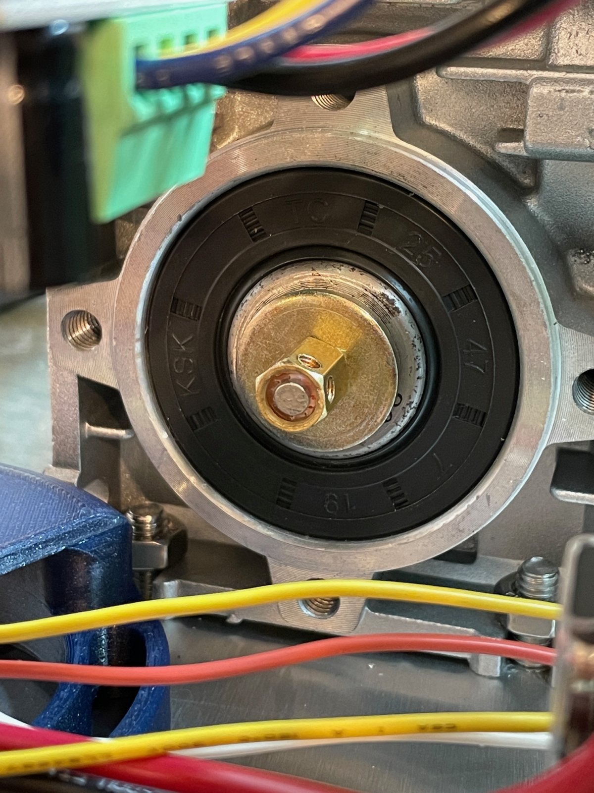

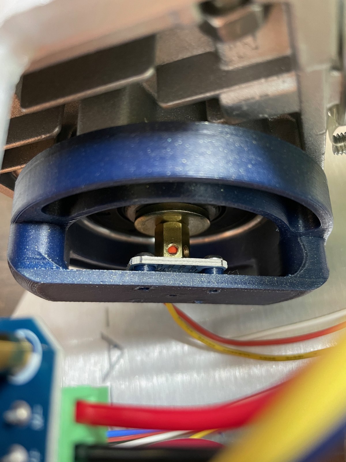

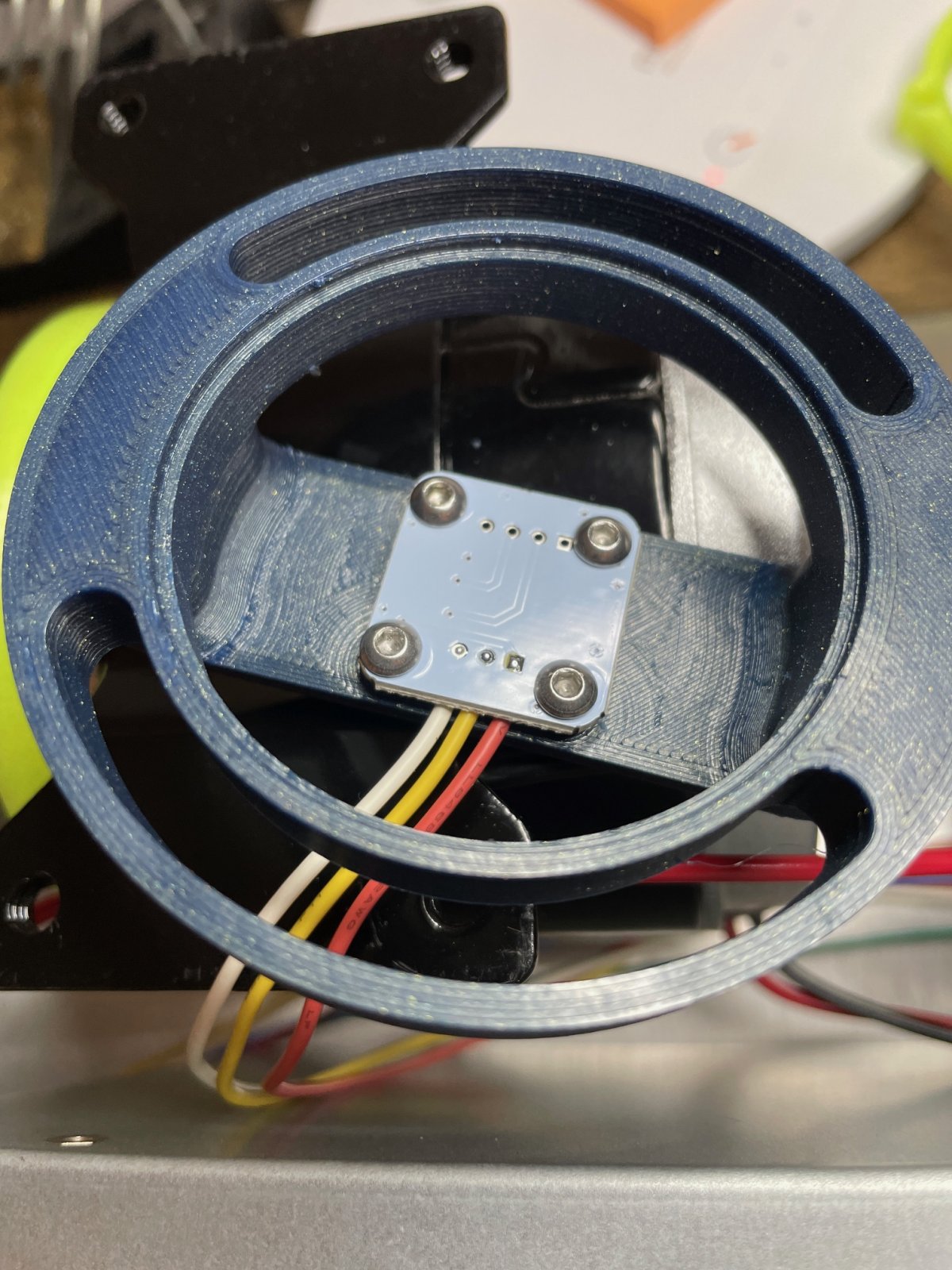

    I do not feel good with a potentiometer, especially the lifetime, as I can imagine the contacts are gone real fast as the back and forth motions.After a quick Google I am happy to share what I learned, and it seems to work so well up to now. I love this system because the 'contactless mechanism' hope will last much longer and less drifting quality issues.

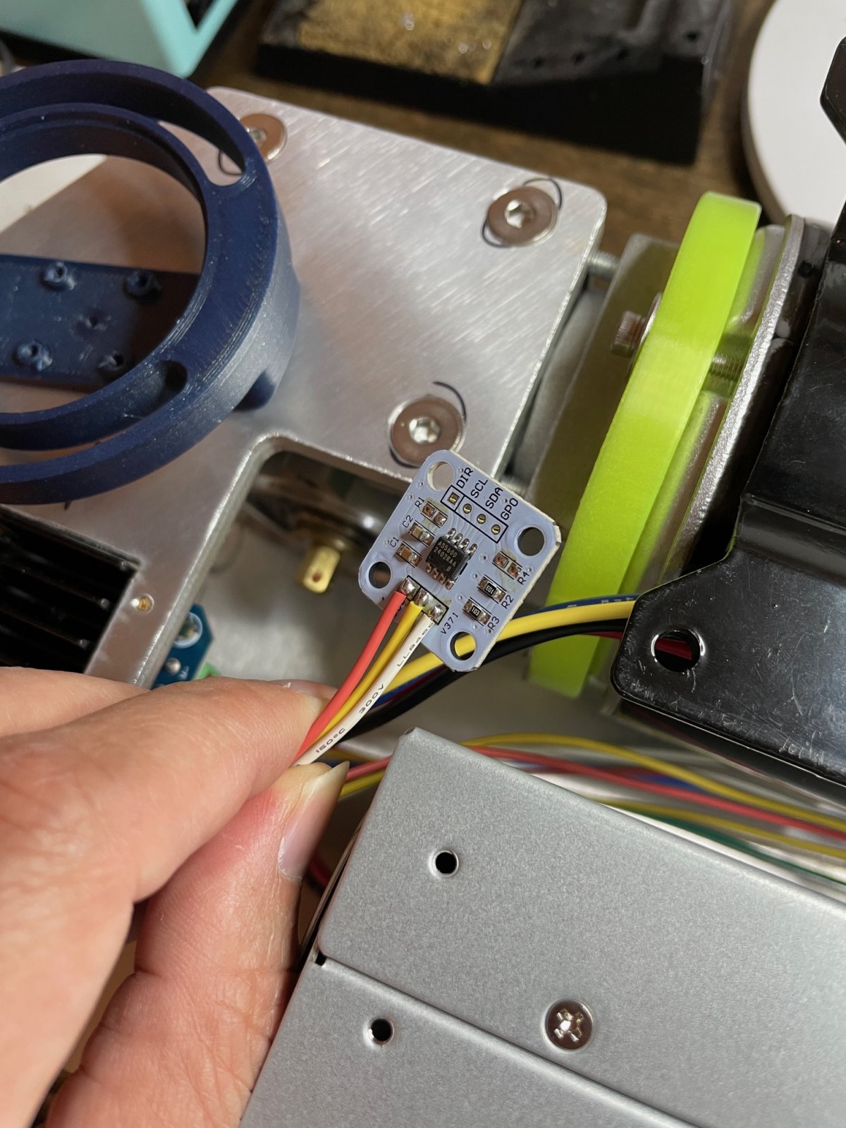

    I am using AS5600 High Precision Magnetic Encoder.
    Here is the link where I source them: https://amzn.to/4eWzKAQ
    $15 for 6 pcs (I built a 6dof stewart platform using an SMC3 Arduino).
    Very important: Remove the R1 and R4 when using the 5v Arduino (ie Uno) board and using it as analog 0-5v input.
    I share the STL file here (zip file). Hope this help! Happy simrig!

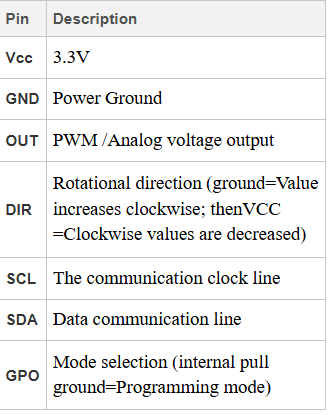

    Why did you remove those resistors ?
  3. prophet.id
    prophet.id BOSeTAMPER's Rotary Servo 6dof Build
    Mar 11, 2024
    65
    285Coins
    +31 / 0 / -0
    to make it Vcc 5v.
    And to make it like a standard analog output on a potentiometer.

    And what if you simply connect VCC to GPO like in this video ?
    It works for me
