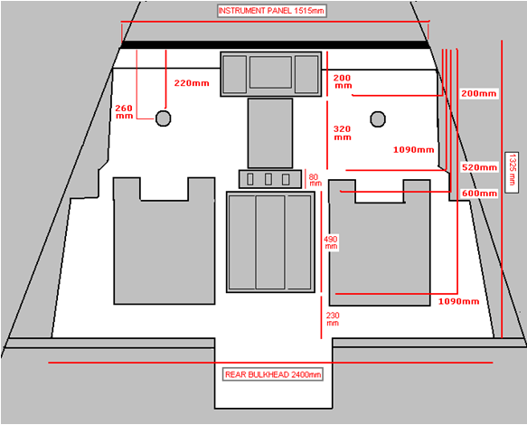

1:1 737NG Floorplan Dimensions for Motion Platform
Discussion in 'DIY Motion Simulator Building Q&A / FAQ' started by Cyberklutz, Mar 18, 2017.
  1. Cyberklutz
    Cyberklutz New Member
    Jun 22, 2012
    10
    35Coins
    These are the actual dimensions for those of you building a 1:1 scale 737NG simulator. I found this helpful when scoping my dimensions for the motion platform base.
