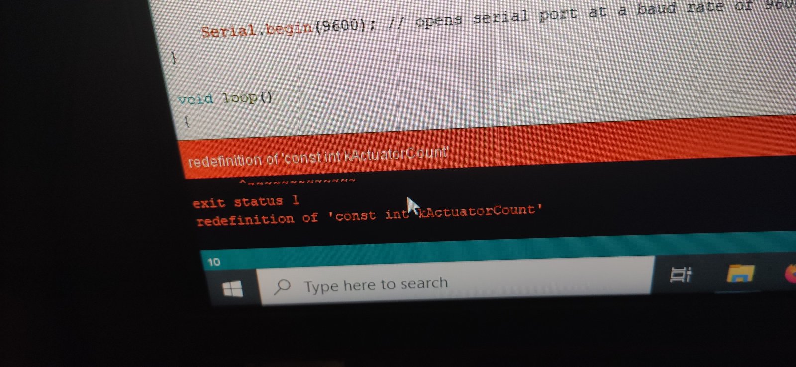

    Where is the problem?

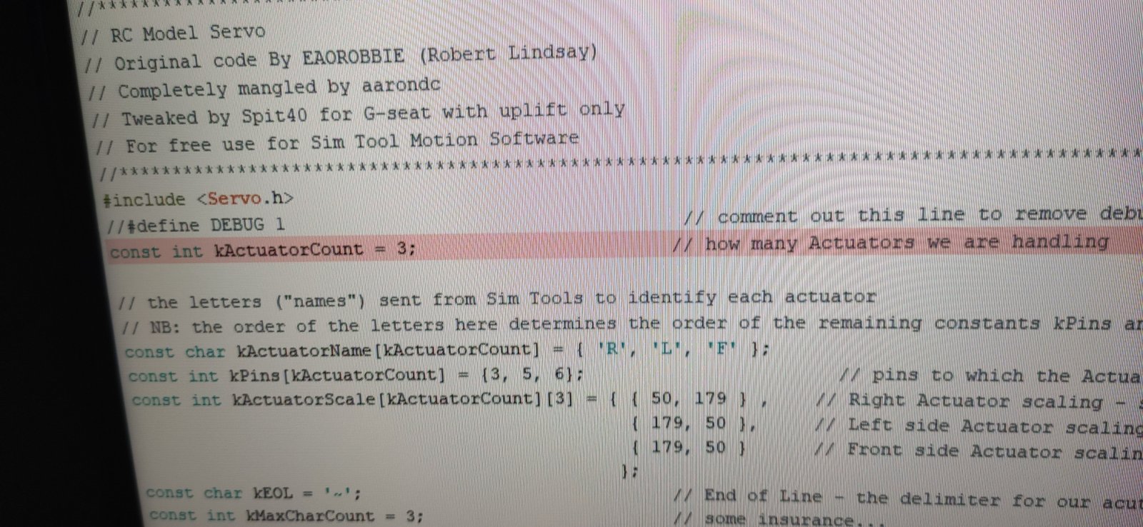

    Actually the error message says where the problem is. The variable 'kActuatorCount' seems to be defined multiple times. Search the code for "int kactuatorcount" and delete all occurrences except (the right) one.
    If this does not work, upload the code that you are using, so that someone can have a look at it.

    Thanks my bad becouse I don't realize that all I change in code saves instantly. I mess with this so I downloaded again and it's working

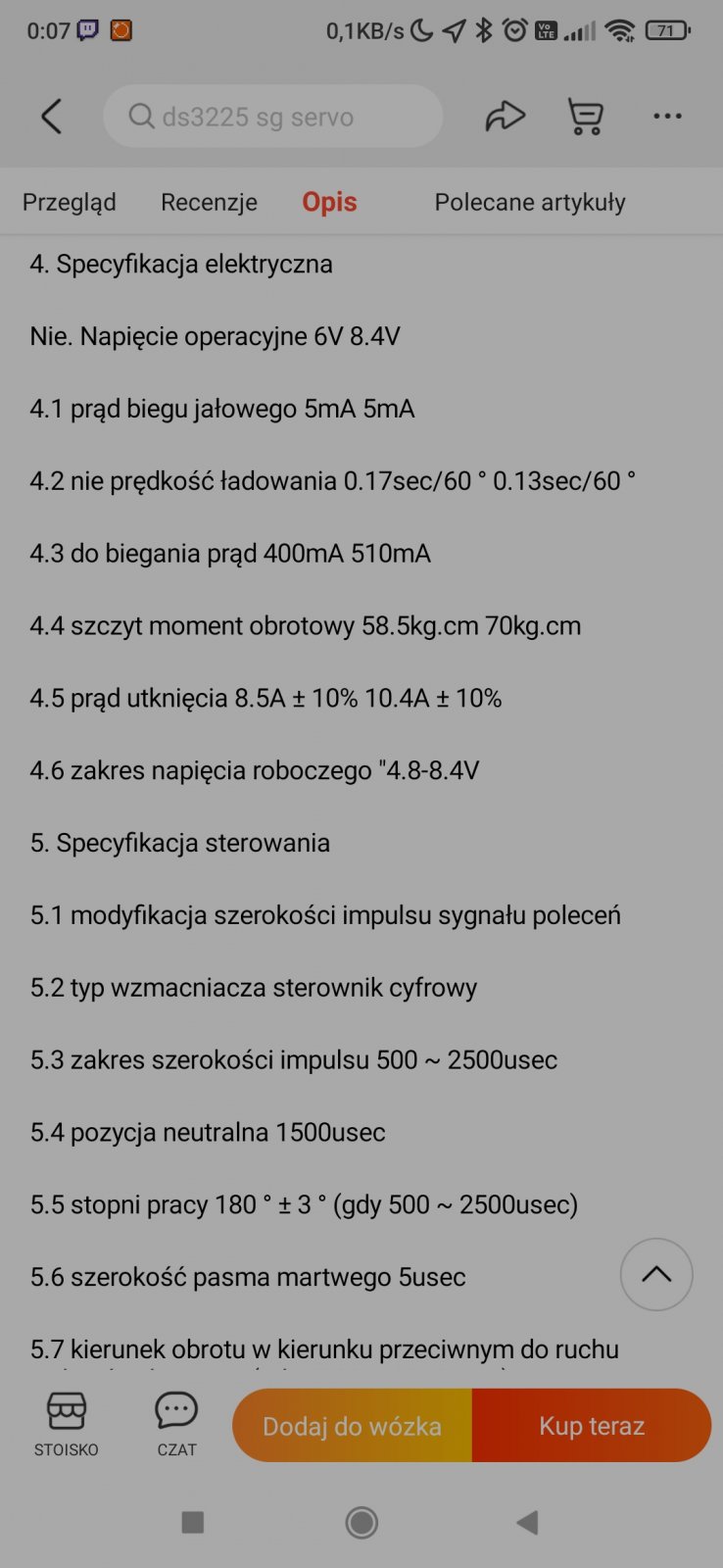

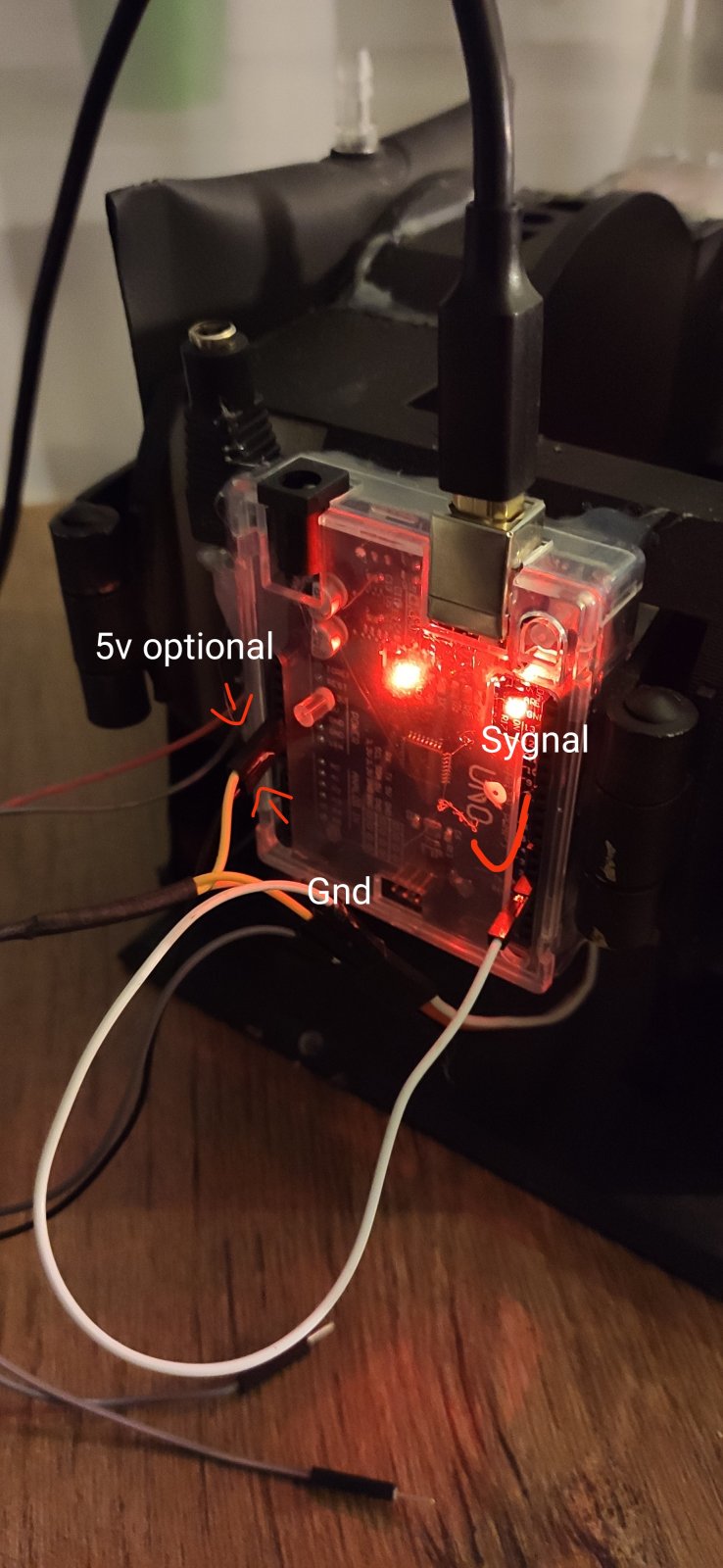

    But I have another problem. I have 2dof with belt tensioner. I try to add gseat but I buy serwo 35 kg and it stop working. I thought it was to weak and buy 60 kg like on belt tensioner. Make this arduino code for lift only, wired and put power 7 volts and it's working, its working well, fantastic feeling on surge (throttle) but stoped I don't know even when on dirt rally play. What is the problem? (maybe on my previous 35 kg was the same)
    I try to change power to arduino 5 volts to check maybe it help, but only I have archive is that when I move serwo arm and powered serwo it goes to start point but on sim tools when I try to check it it, it doesn't move
    I use power supply Adjustable from 3 to 12 volts 2.5 amperes

    Curent load

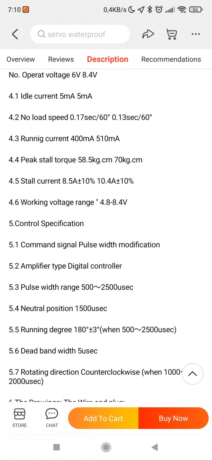

    Serwo spec on the pic and power supply :
    • Input voltage: 110-240 VAC 50/60 Hz • Output voltage: 3 / 4.5 / 5/6 / 7.5 / 9/12 V • Output current: 2500 mA • USB port: 5.0 VDC / 1.0A • Power: 30 W

    This is a valid question, and the answer seems to be „No“. The PSU spec says 2500 mA, and the servos have a stall current of 8.5 to 10.4 A each, depending on the applied voltage.
    So if the servos stop moving when they are under load, the reason could be that the current provided by the PSU is not sufficient. Even when not stalled, they can easily exceed the 2.5 A limit.
