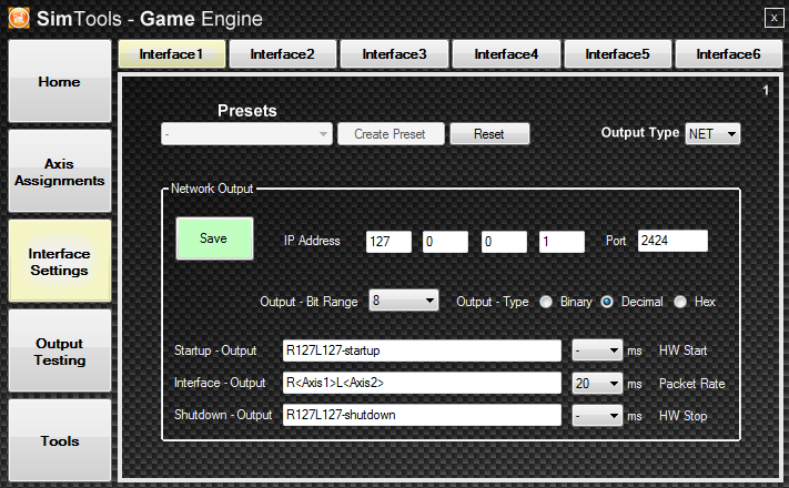

    One of the big unknowns for me initially was what exactly was output by the GameEngine and fed to the microcontroller, so I wrote a super simple little perl script to capture the output and print it to the screen so I can actually see it. Hopefully this is helpful to others down the road if they have the same kinds of questions.
    This perl script acts as a simple UDP socket server. It simply opens a socket, listens for UDP packets on port 2424 and prints out the messages it receives. To make the output a bit more readable, I am only printing the output when it changes.
    In order to run this utility, you need perl on your computer. For Windows, you want ActivePerl. Note: I had to change the file name from simTest.pl to simTest.txt in order to upload it. Just change the extension back to .pl and then perl will recognize it. To run it, open a cmd prompt, browse to the directory where you have the script and run it by typing 'perl simTest.pl'. Now open GameEngine and setup the Interface Settings for output type of Net, IP address of 127.0.0.1 and port to 2424. (see attached screen shot of Interface Settings for an example) Now when you turn on Output Testing, you should be able to move the sliders around and see how the output changes. If all went well, you should see something like this:
