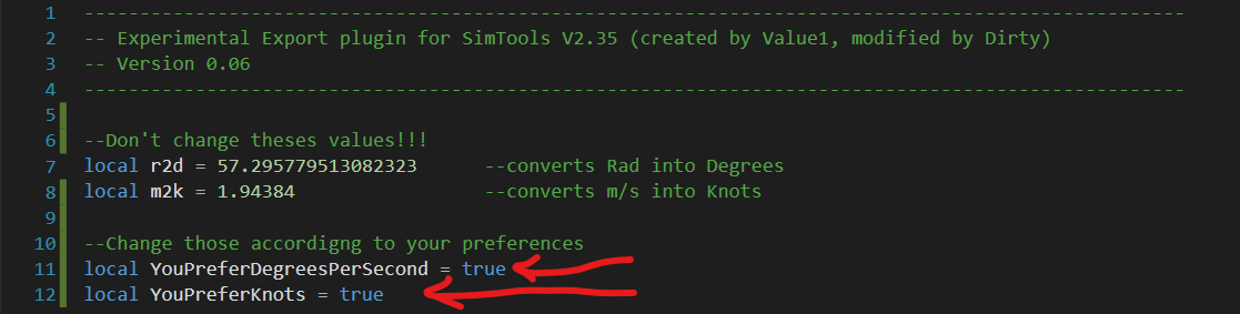

    Since I wanted users to have full control over the data, in this version I have removed all unit conversions from inside the plugin, and have instead exposed the algebra in the Export.lua to allow users to tinker with it.
    The default is:
    • Rotations in °/s
    • Airspeeds in Knots
    If you don't like that, after patching DCS, go to...
    C:\Users\<yourname>\Saved Games\DCS\Scripts\Export.lua
    ...and modify these two lines according your preference:

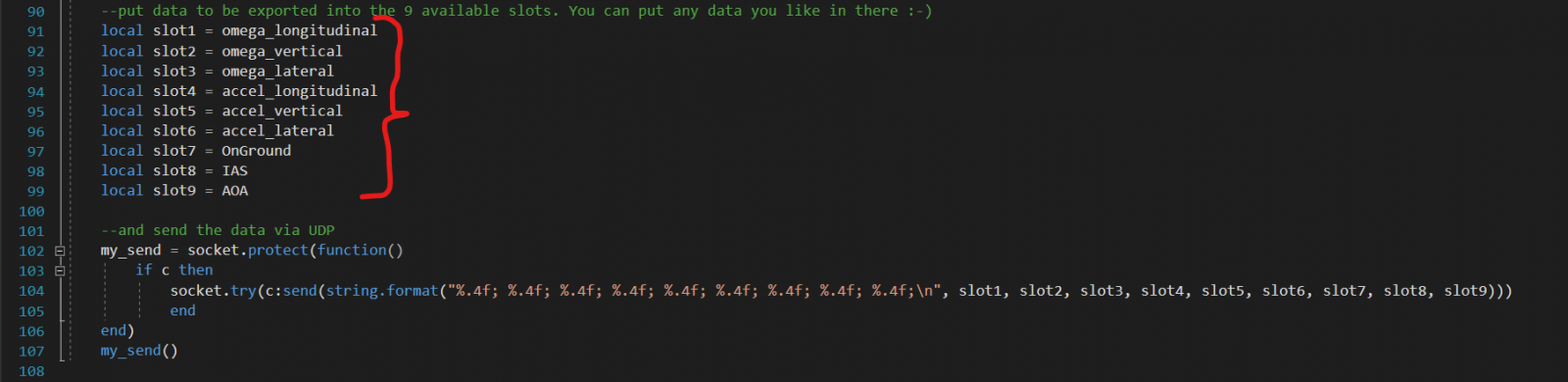

    The plugin is now "almost generic", in the sense that whatever you write into the 9 available slots will show up in SimTools as raw data:
    ...even if you want to use the 6 motion data slots for something other than motion you can do that now.

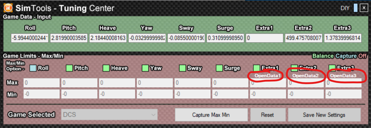

    To represent this change, I called the three open slots "OpenData1,2,3". You can see it in Tuning Center:
    DON'T FORGET TO CHECK YOUR MIN AND MAX VALUES!!!!
