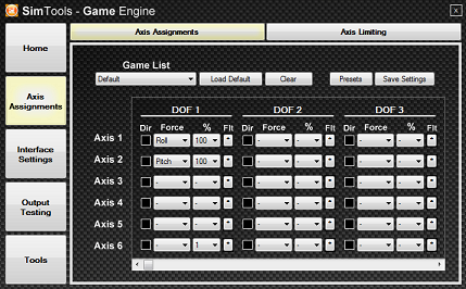

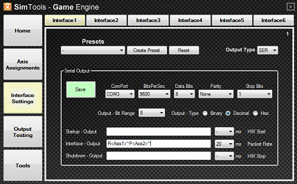

    Axis Assignments:
    Interface setting for SimTools 2 is
    Remember to press save after changing.
    Now Start with the Output Testing and you can move the Roll and Pitch slider to do what you have set in the code at present nothing.
