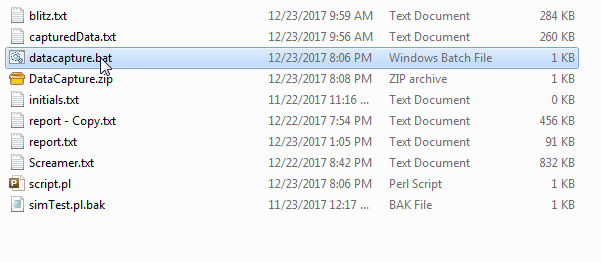

    Extract DataCapture.zip (Should have a datacapture.bat and script.pl file inside)

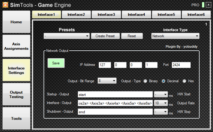

    SimTools Interfacing Settings
    Interface Type = "NETWORK"
    IP = "127.0.0.1"
    Port = "2424"
    OutPut Bit = "8"
    OutPut Type = "Decimal"
    Startup - Output = "start" -ms
    Interface - Output = "<Axis1a> <Axis2a> <Axis3a> <Axis4a> <Axis5a> <Axis6a>" 10ms
    ShutDown -- Output = "stop" -ms
    SAVE

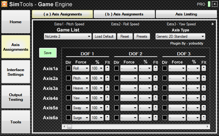

    SimTools Axis Assignments
    **VERY IMPORTANT TO DEFINE ALL AXISES for Video Ride Creator
    Define Each Axis (The Axis order above is the standard order in which most programs read data columns)
    SAVE!

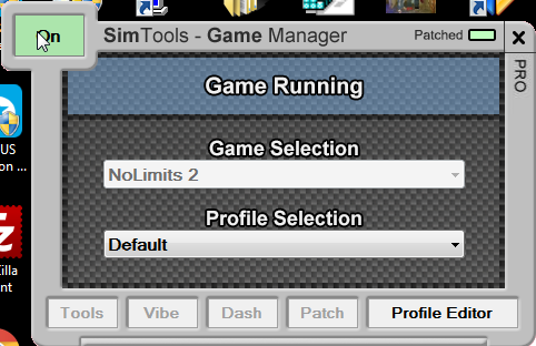

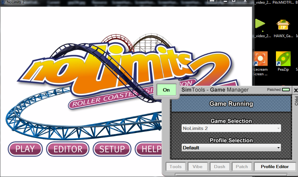

    Start the Game of your Choosing
    Verify SimTools is Reading Game (Game Manager should say "Game Running")
    Run "datacapture.bat" (double click to run)
    Once you captured the game YOU MUST TURN OFF the GAME MANAGER (By clicking the ON button) - This will finalize the captureData.txt file (Below)

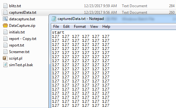

    In the SAME location as "datacapture.bat" look for a new file generated named "capturedData.txt"
    This is the captured game data, ENJOY!
