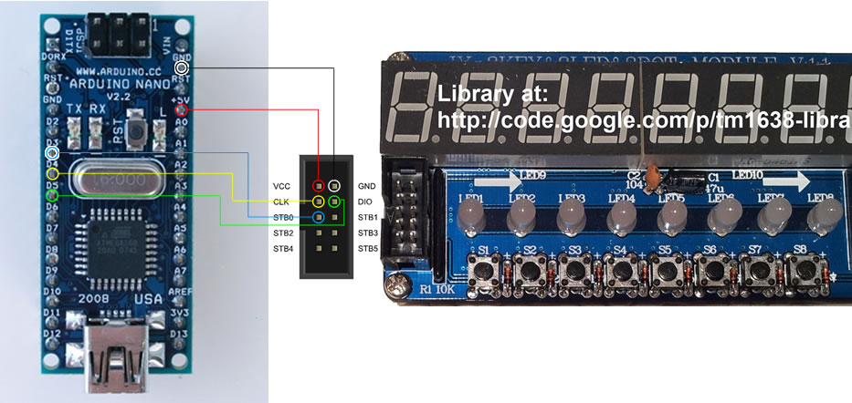

    You must connect only 5 pins from TM1638 to Arduino :
    TM1638 .../... Arduino
    ... pin 1 .../... 5V
    ... pin 2 .../... 0V
    ... pin 3 .../... D4 (Clock o CLK)
    ... pin 4 .../... D5 (Data I/O o DIO)
    ... pin 5 .../... D3 (Strobe0 o STB0)

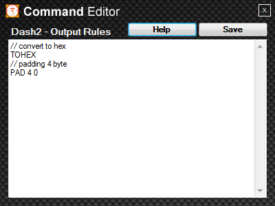

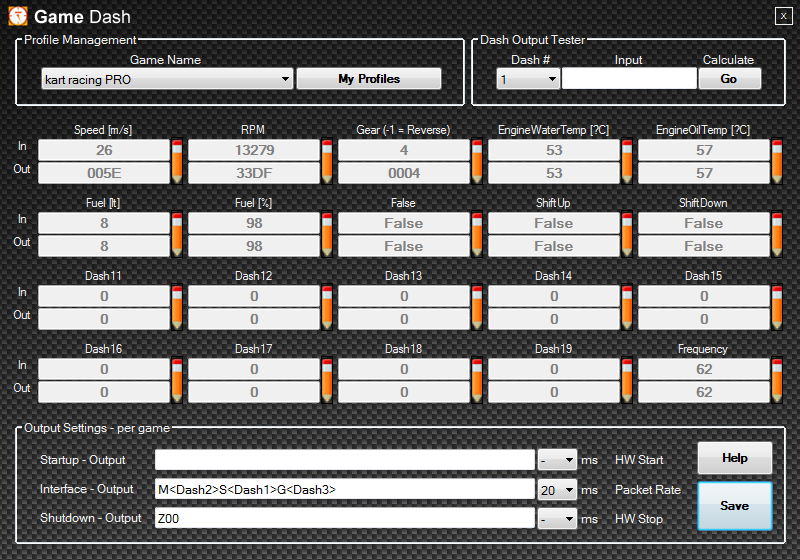

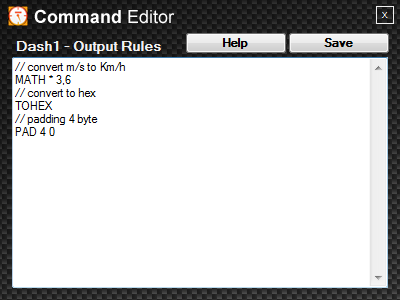

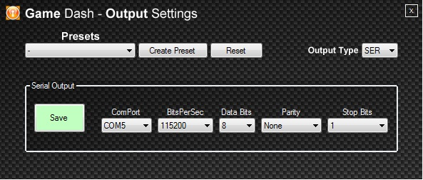

    Install GameDash, set Serial output, set Output Settings, edit command to adjust out value according arduino code.
    Here a sample configuration for Kart Racing Pro
    - With version 2.0 -​
    valid output :
    - S<DashX> - Speed
    - G<DashX> - Gear
    - M<DashX> - RPM
    - O<DashX> - Oil
    - W<DashX> - Water
    - F<DashX> - Fuel
    - L<DashX> - Lap
    - P<DashX> - Position

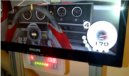

    by default display show gear on left and speed on right, leds show only RPM.
