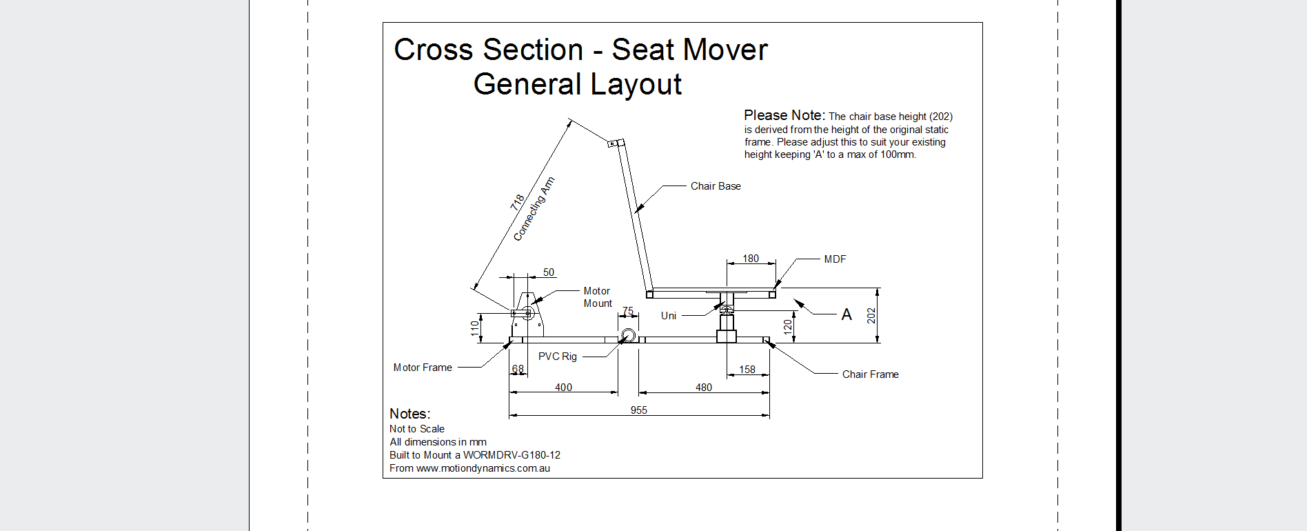

    Where are ya mate , Im in WA. I actually build a seatmover for that purpose. Easy to copy. or right price i can sell ya mine and build another.
    yes i have full plans.

    Eaorobbie, is a seat mover any good, I have only tried static and 4dof and a 6dof, and think a seat mover just would fell real..??
