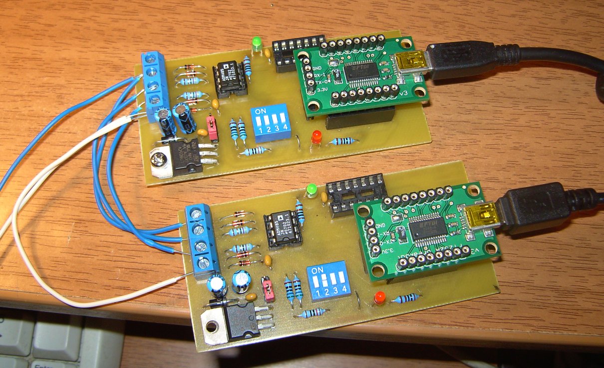

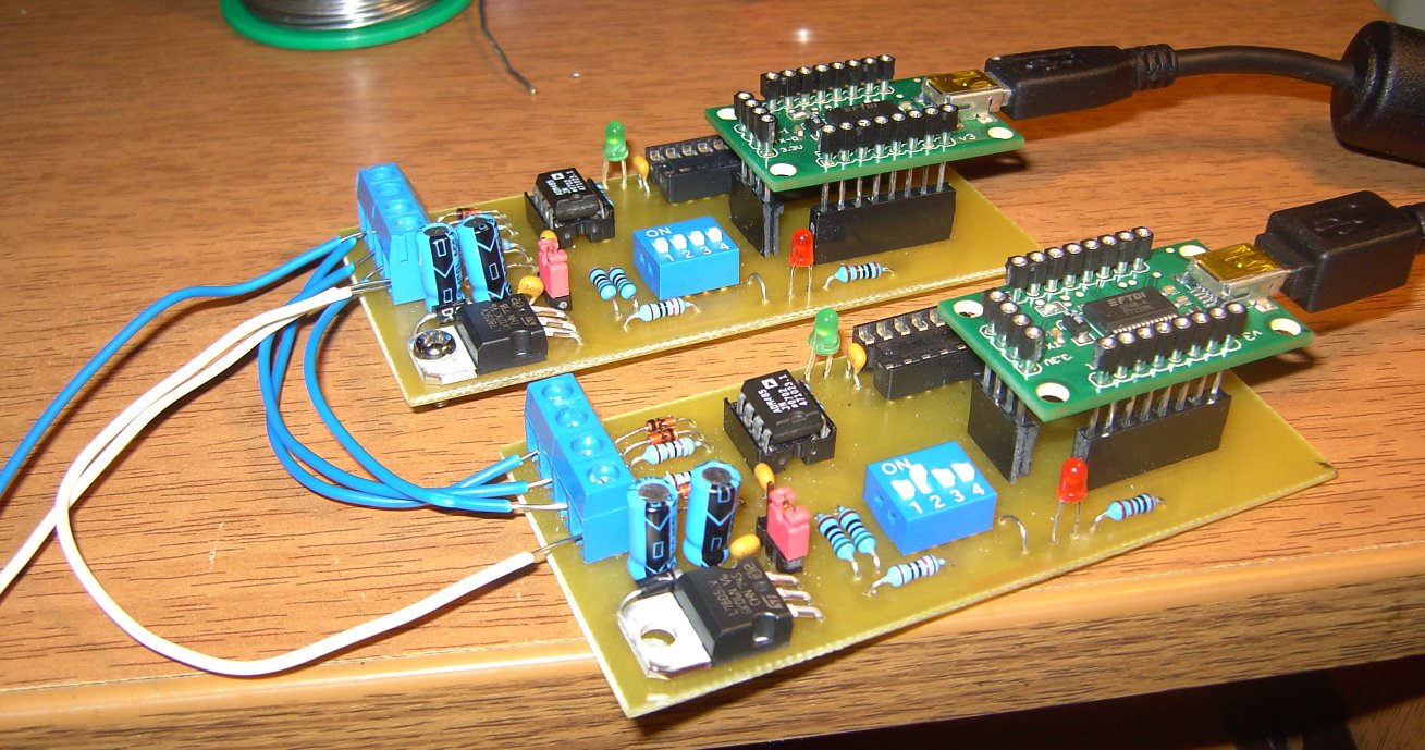

    Hi to all,
    I just finished testing my DIY USB_to_RS485 adapter from my part (without scn5 attached yet). Next step is to send one of these adapters to Sirnoname test it with a SCN5 motor.
    I did loopback tests with simple text thru hyperterminal, and even transfered files thru one adapter to the other with success in every possible speed available. It worked flawless even with 1Mbps connection speed!!!!!!!! :eek:
    Here is a list of speeds I tested it with:
    115200 bps
    230400 bps
    460800 bps
    921600 bps
    :yippiee:

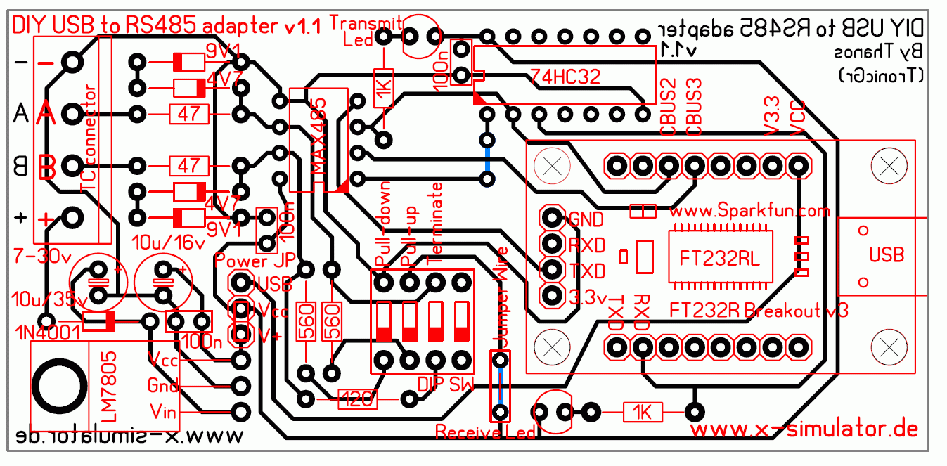

    Latest version v1.1:
    I had introduced the board and some info about it in the link below:
    post9152.html#p9152
    post9142.html#p9142

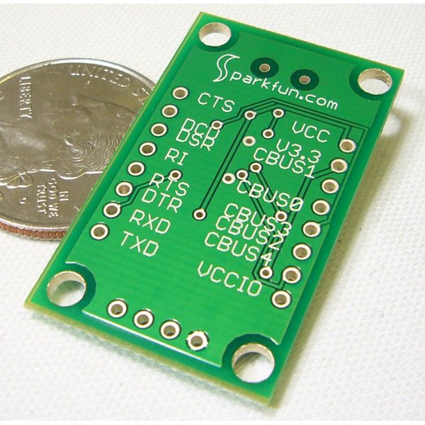

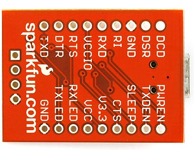

    But I might have to revisit the layout a little, as I noticed that Sparkfun has changed the pinout and the spacing of their FT232R breakout board lately:

  2. tronicgr
    tronicgr
    The enable control for the Send direction is done by the FT232R chip!!!!!! Also the Receive direction control is done by the FT232R chip automatically!!!! This means that will enable the listen mode as soon it stops sending data. 8)
    The 74HC32 is just an OR gate that prevents the data from being echoed back to receive line. I removed it as I found it unnecessary in the tests. I believe that you can program the x-sim software module for the SCN5, to automatically remove the echoed data if you haven't done yet so!
    Send me you mail details in PM (address, postal code, etc...) when you can... :thbup:
    Regards, Thanos

    @hoopstar
    I don't think you can use the Iduino board for the current project. The sparkfun FT232 module gives access to lot more ports and features of the FT232 chip that are needed.
    The Iduino board gives access to only RX - TX ports that is all Arduino needs to communicate thru a serial port protocol.
