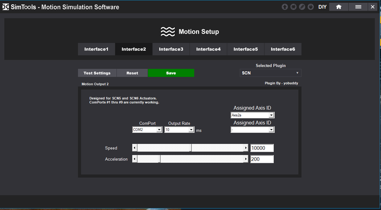

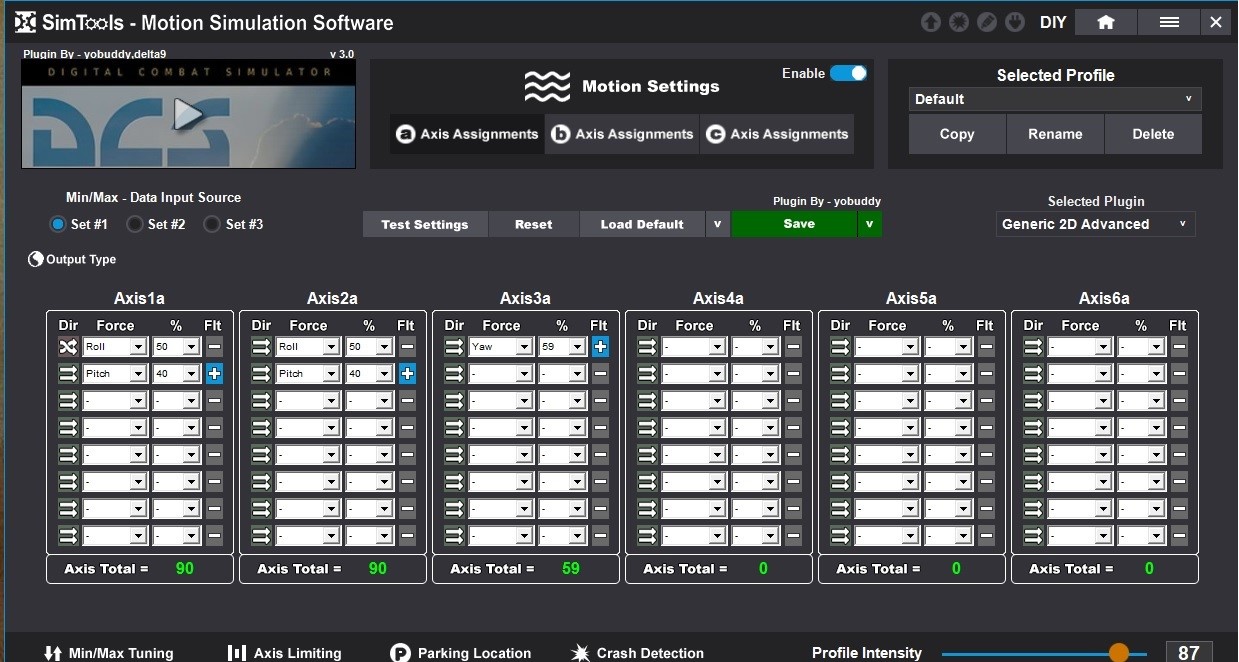

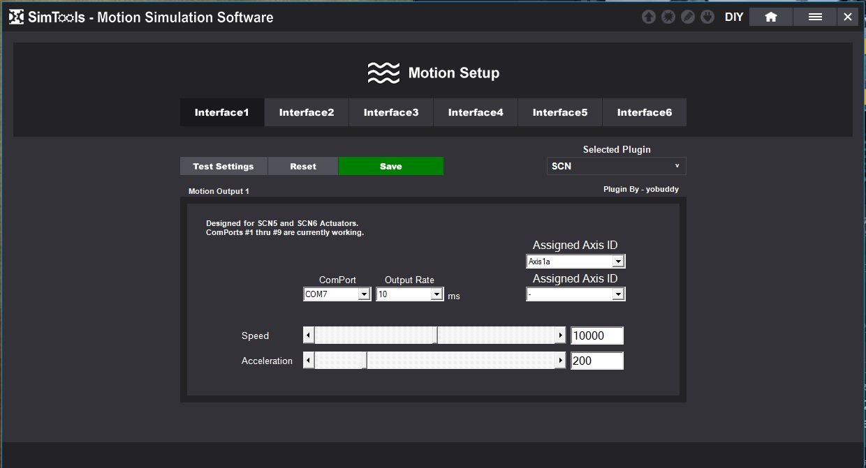

    Good evening everyone. I am using FREX's MOTION SIM with SIMTOOL3. The reason is that there is little airplane software in the FREX plug-in. I think SIMTOOL3 is easy to use and has a smart appearance. However, when using it with DCS, I am suffering from the phenomenon that the pitch and roll become strange.
    in particular
    When the nose of the aircraft is up, the seat rolls to the right.
    When down, the seat rolls to the left.
    When you roll to the right, the seat faces up.
    When you roll to the left, the seat will face down.
    Is there anyone who is having trouble with a similar phenomenon?
    Is there a solution?

    The DIR settings determines which way each axis moves, so it seems yours are reversed for pitch and roll, just swap them around and you should be good to go.

    Thank you for your advice. With the modifications you suggested, it now works properly. However, I think this plugin needs some modification, but this problem may only be in my environment.
    thank you very much.
