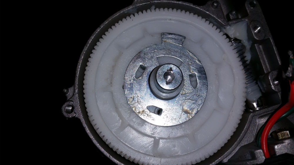

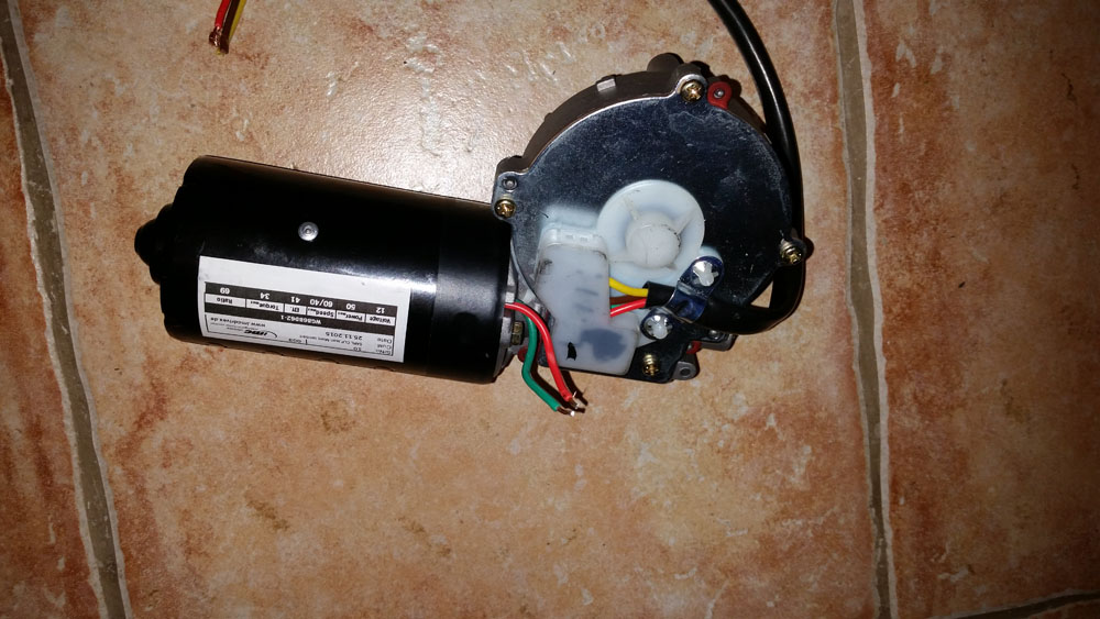

    Hello I received my new motors from ebay.
    They look good.

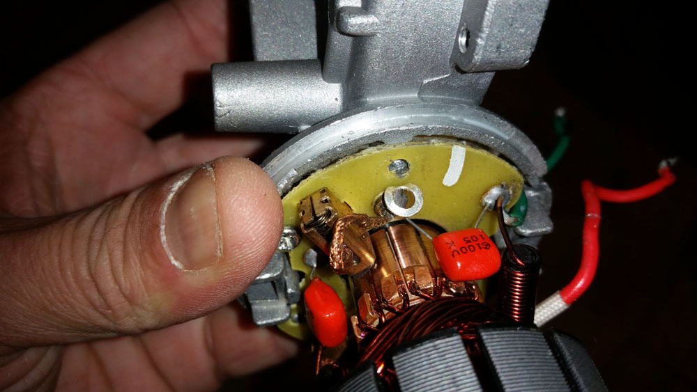

  11. nikitojm
    nikitojm New Member Gold Contributor
    Nov 25, 2015
    21
    manosque
    127Coins
    I must remove the ground inside the motor.

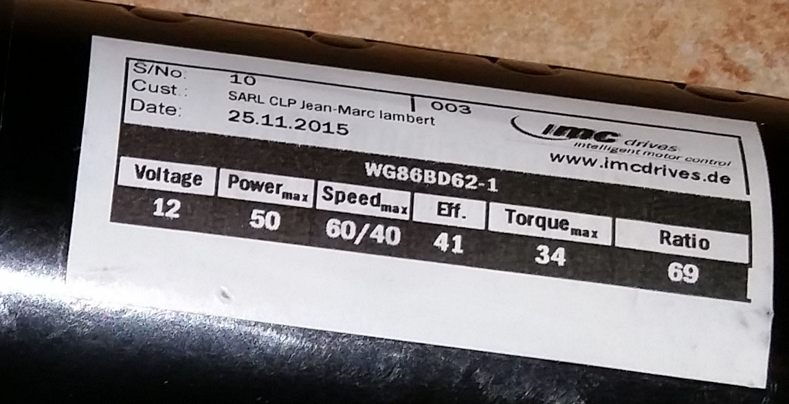

  13. nikitojm
    Nov 25, 2015
    21
    manosque
    127Coins
    Thank you for your message.
    50W It's a mistake. I try the motors, for 12V I use 26A for the max torque that I mesured 18Nm. P=UI = 320W
    the motors use 50W about 4A without load. I put a controller between the battery and the motors.
    I just finish to control them. I Put potentiometers on the back and they look like good.
    but 18Nm it's about 1.8Kg at 1 meter and 40kg at 4.5cm. Perhaps it's not enought.
  14. Pit
    3,012
    30,418Coins
    +3,088 / 31 / -0
    Please can you upload a better photo taken by the specs?

  16. Pit
    3,012
    30,418Coins
    +3,088 / 31 / -0
    These motors are rated as 50W motors. Even if I would use the rated current of 10A ("Nennstrom") seeing on the specs for my calculations I would not get more than 120W. The 50W is the estimated continuous power, the other values stand for peak and braking. Sorry to say that and you can hope that I am wrong (which is pretty seldom...)
