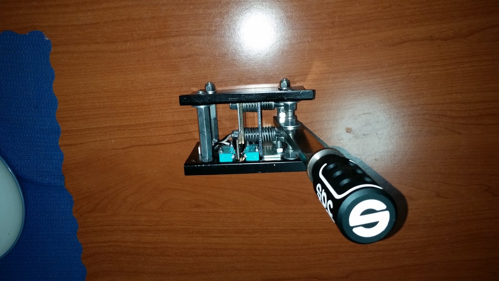

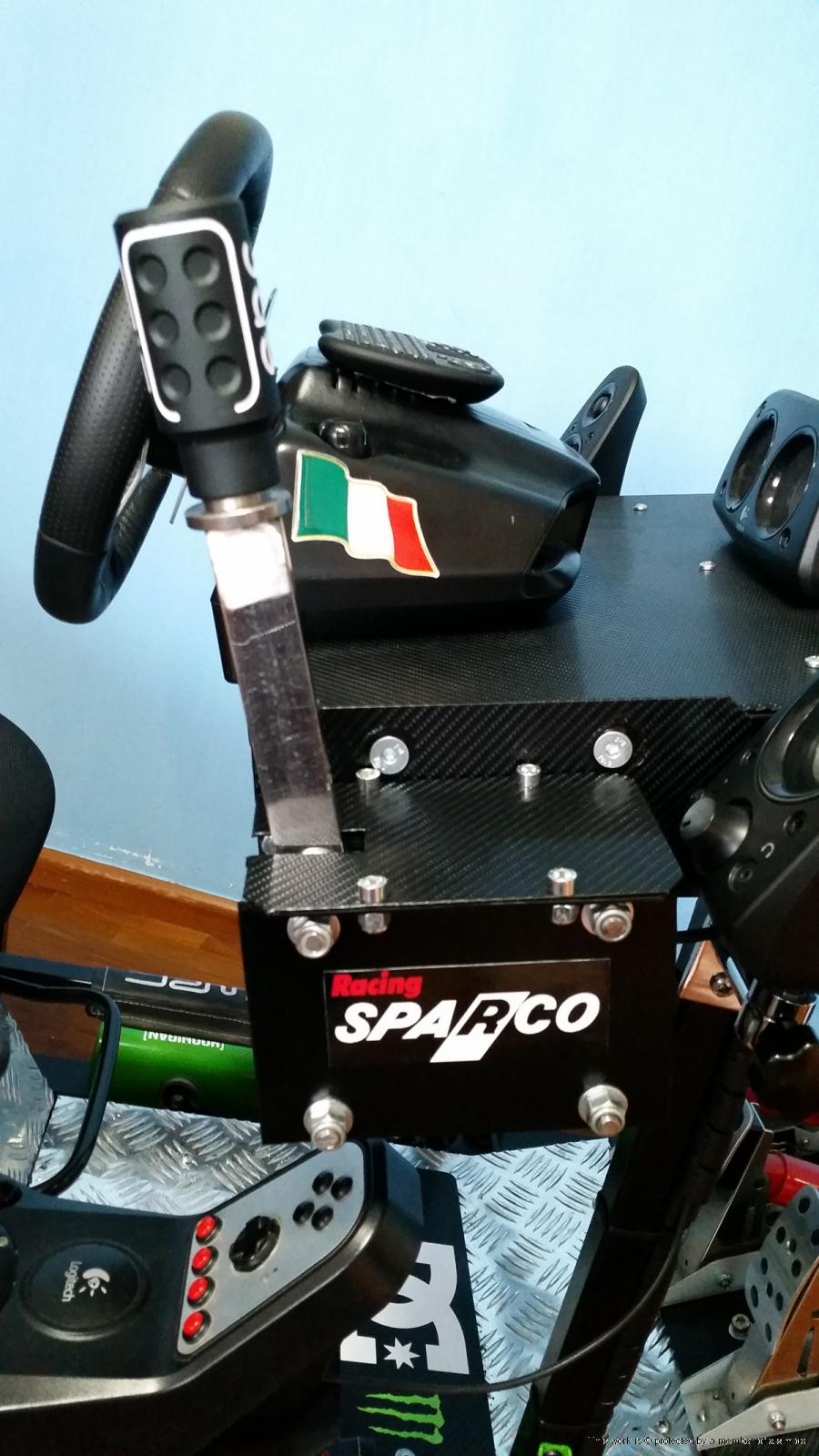

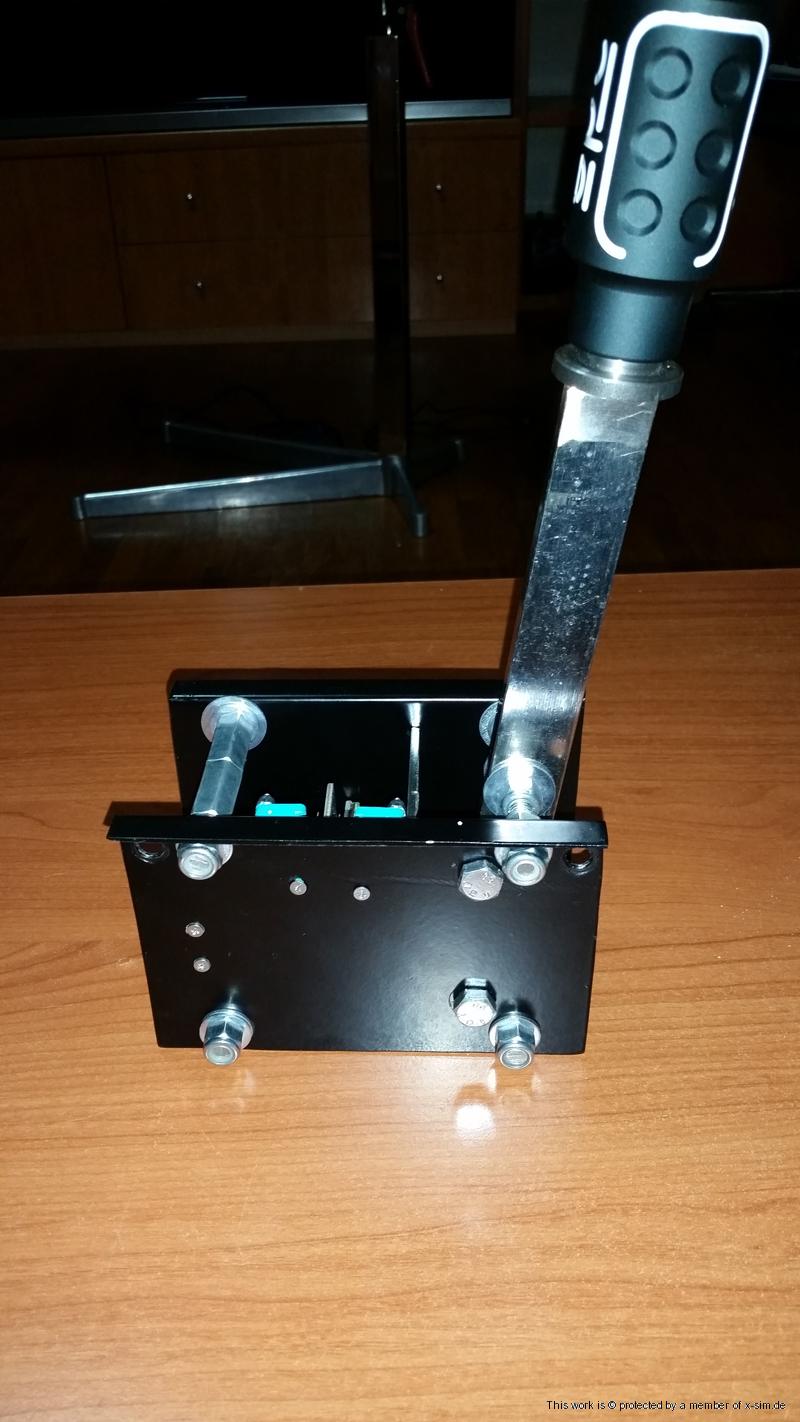

    This sequential gearbox and was made with the following materials:
    needed:
    2 iron plates of 15x10 cm with a flap bent 1cm
    a threaded rod M8
    4 springs from 5cm
    2 microswitch
    8 extensions for threaded rods M8
    a lever recovered from 30cm
    a knob Sparco
    here are some pictures is a video of the operation is unfortunately the only video I

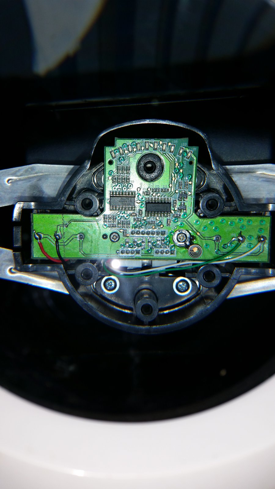

    not to add external devices, I connected the wires to the sequential gearbox g27
    From the photos you can see the various details of construction
    Video

    Could you please describe the mecanism: what part is articulated or fixed?
    I would be great if you could draw a simple sketch!

    The gearbox is simple and economical
    I ask my friend if I billo creates a 3D drawing and then share it here, because I'm not good with the drawings.:(

    I soldered my sequential shifter to the G27 paddles, too. It is a bit of work but it is absolutely worth it.

    Hello. I have a problem with the gear shift. I have a fly speed. I want to connect my Sequential gearbox to the steering wheel G 27. Do you think it will help me? Sorry for my English
  14. rattler
    rattler
    Yes you could, I remember seeing a document ages ago. I think it was a matter of opening the G27 shifter and re-soldering wires off 2 switch points and then solder them to your switches in your sequential shifter
