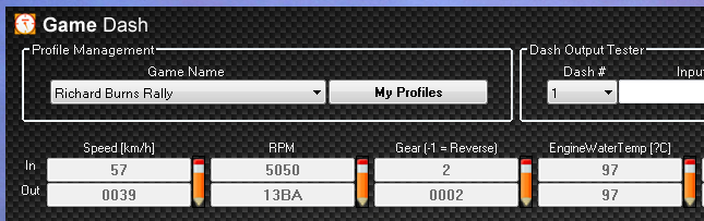

    hi,
    today for help @Chosa4 i test my project and found a problem with gamedash.
    i have Windows 7 64bit, Simtools 1.3, Gamedash 1.1, a fresh RBR installation patched to 1.02 in original path and patched for motion with plugin 3003
    when run game simtools and gamedash recognize running game but the value in game dash remain all 0.
    i also test istallation in c:\rbr and run exe in compatibility XP mode and/or administration mode without success.
    thanks for any advance

    another test, running simtools and game with or without administrator flag have same result.
    i see slide movement in virtual axis in output testing.
    i also trace udp comunication, but all value are 0
    <_Dash_1_Output>Speed,0</_Dash_1_Output>
    <_Dash_2_Output>RPM,0</_Dash_2_Output>
    <_Dash_3_Output>GEAR,0</_Dash_3_Output>

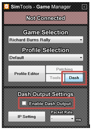

    hi,
    waiting of an upgrade from @prilad, i write this exe to send dash-data to game dash received from gauge-server plugin for RBR (http://topdrive.cba.pl/)
    you must disable game dash function in Game Manager and if you want only dash data without movement, you can run only gamedash and rbr2dashboard.
    regards

    now we waiting for a new version of plugin, but me too received same error in wrong patch sequence.
    the right way is install rbr, install patch 1.02, patch the game.
    if already patched you must update plugin and remove-patch before.
