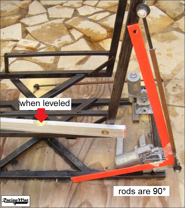

    does the mounting point on the platform always have to be a certain distance accross from the end of the motor shaft?
    Is it that the motor shaft is directly below the platform mounting point when the platform is level? Or does it not matter?

    Great thanks, can you see the new picture I have uploaded above? I mean the actual rod that connects the motor to the platform, does the top mounting point always have to be at a certain point compared to the motor shaft?

    When the platform is level the actuator arm should be halfway through its arc of travel.

    Exactly what I needed, thanks! So the position of the vertical rod is not really relevant as long as it can move all the way along its arc of travel?

    Another note as you will see in picture it is not recommended to have the connecting rod at 90 deg when motor arm and platform is level, try to avoid this as when it goes to 90 deg ,the connecting rod can tip past 90 deg , plus the angle actual helps to lessen the force on a motor, basic physics of levers.

    with a picture!
    Nice work, mitchellmoxo!

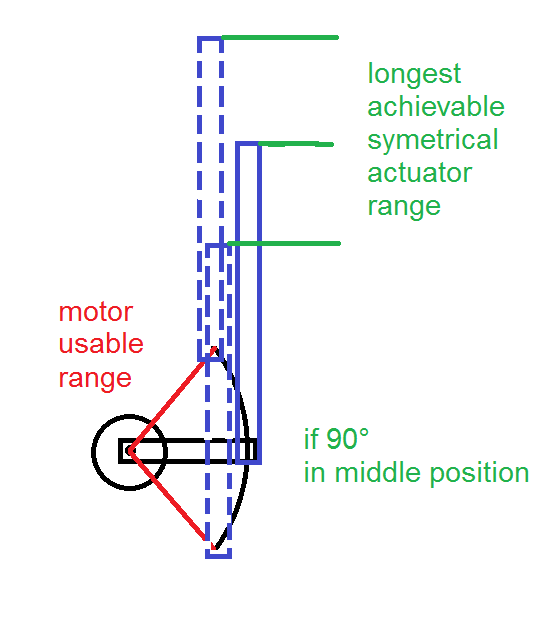

  10. RacingMat
    2,234
    20,895Coins
    +2,084 / 21 / -2
    Tell me more as I don't understand :confused:
    here is my tought
    yours

    Simple physics of leverage at 90 deg you are supporting 100% of the weight on the lever. at 45deg you are only have 50% of the weight leaning on the motor arm. This allowing for better speeds as the motors have to work less, a bonus on any sim. Plus at 90 deg like the picture above you are inviting radial movements as the lever will not stay dead vertical, it will always try to fall over which in turn will stress the pivot point. I completed 3 years of a Mechanical Engineering degree but left it in the final year to support a growing family plus I really do enjoy building things then dealing with the politics of an office.
    Back to the question. Yes please aviod the arm being vertical at rest and max movements even layed over at 80deg will be fine, the frame above is a copy of the CKAS unit which they fail badly at the motors are way too slow to be used in a race scene as they advertise. Their software doesn't help either. 26rpm way to slow for motion cues always lagging behind missing a lot of the feeling.

    I wish I could see a sketch about angles! as I don't see what you mean :)

    A sketch sorry not my post and I think i clearly explained myself.

    150 rpm under load, it's really great! what was the lever length? as load matters in N.m (torque=force x distance)
    it's a pity for the sketch... sorry to bother you if I'm the last one who hasn't understood
