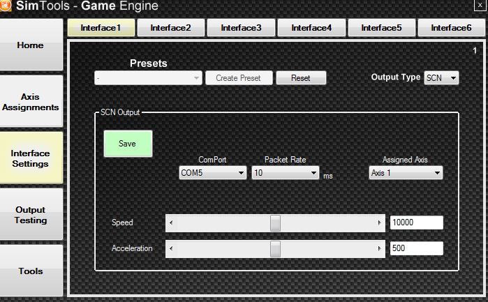

    Hi !!
    at first sorry my English iss not perfect, I am from Germany, and I have sucessfull convert Frex to XSim..
    My first Test Assetto Corsa works fine, but with Project Cars it dosent Work :(
    Here my Worklist:
    1. Loaded the Plugin 1.0.0.0 from here in the Game Manager
    2. Patch the Game
    3. start PCars and set MMF on
    4. Start the Game but nothing work on my Seat
    5. I have Startet it in Window Mode to See the Game Manager (Game Running) but he says Connectet
    Please Help me I am very Disapointet :( :(

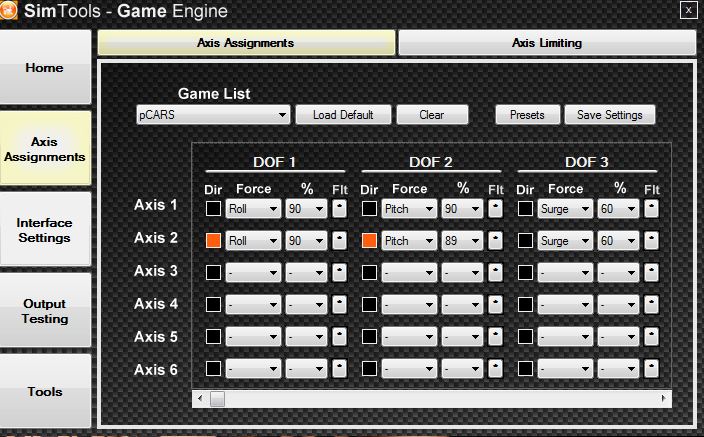

    Ok Thx to Lars for plugin.. my Next Problem iss The Roll, when I am start PCars i feel the track going up and down, but the Roll Effect in Corners iss very Minimal
    Can anyone show me how to Setup ist for a better Roll effect ??

    Thx, but iss anyone here to help me in German Language ?? It would Help me More to understand the Game Engine and Game Manager, I ary Sm very Sad that its dont Workng like the Simcom Base there i had better Response in the Game for the Effects
    But I try to Post it in English....
    When I drive in PCars my Seat dont give me a Feedback of Throttle and Break it only will be Moved minimal...
    In a Corner the same, no Feedback for Right and Left Roll, only minimal... But when I am in the Green the Seat will be Shaking and you have the Effect ..
    Sorry for my English but I try to keep it better ;)

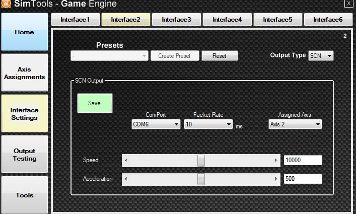

    Here are my Settings....

    need to see tuning centre numbers please
