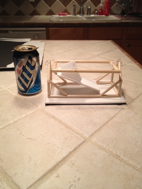

    So I decided to build a little model so I can play around with. She is about 1/10th scale and seems to move fairly well. Tomorrow night I hope to get a couple little mini servos hooked up so I can make her move!

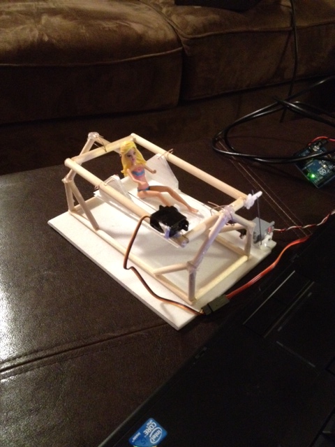

    I've made some good progress on my little model. Not only have I rigged up servos and got it moving, I hacked RacingMatt's arduino code to drive the servos using input from SimTools!
    Oh yeah, I found a hot little model to take it for a spin too :)

    Marvellous! Beautiful! :popcorn
  7. eaorobbie
    20,463Coins
    +1,686 / 23 / -2
    Looks like i need to sticky my rc model code , it can run upto 6 servos with a little modification.
    Cool idea on model, love seeing them, till mine very few people tried it. Makes the whole build process a lot easier.

    thanks guys! I'm a hands on learner, so making this little model really helped me visualize how it would need to work. For instance, once I started trying to add the servos, I quickly realized the motor for the pitch really needs to be mounted on the roll frame in order to work. Little things like this will help me plan the full size build much better!
    As a bonus, I was able to very quickly get SimTools up and running with FSX so I got a nice little emotional boost from seeing the whole thing working with the real software!
