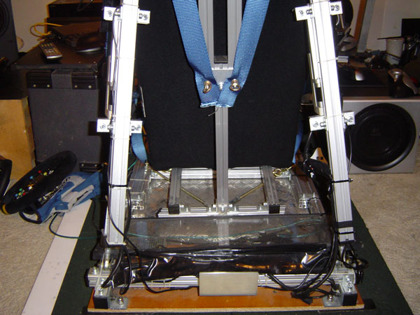

    Splendiddd, would it be possible for you to take a picture of your simulator so we can see the current setup. Is your setup like the FREX. (i.e angles)
    It can be good for people to know HOW NOT TO SETUP thier motion sims. Anyway it is a good job you can easly fix your actuators yourself.

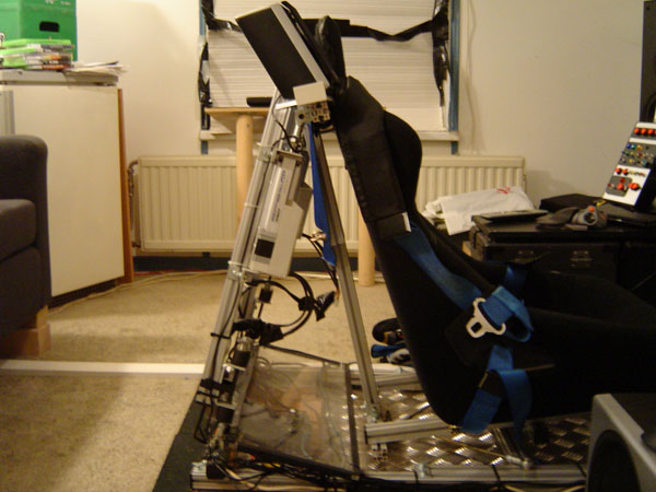

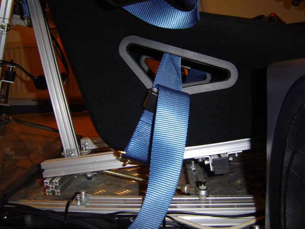

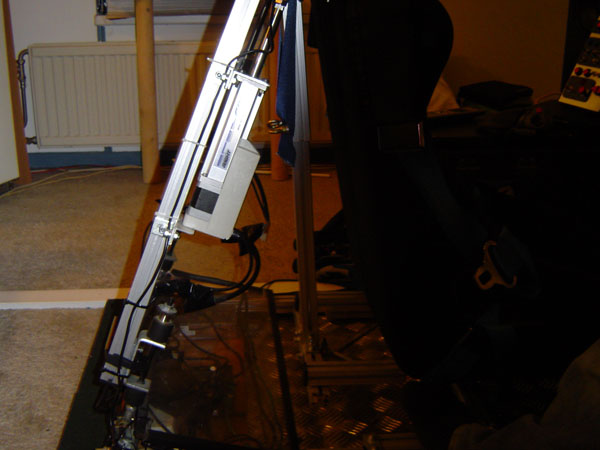

    Thank you guys for all the replies, i will try to adjust my actuators more to the back 10/15 cm?, though it won't be easy because i have a metal plate on the bottom of my rig. I test that tomorrow (took a day off hehe). This is my current setup:
    If Mike or Bernard could make a example picture please post this for reference.
    Thank you in advance :yes:
    Rob

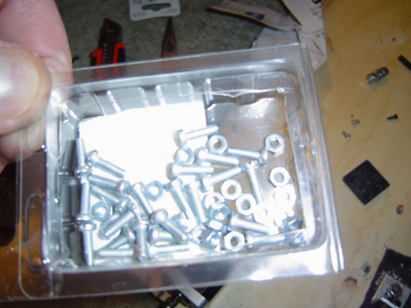

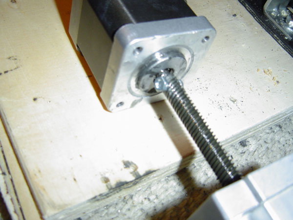

    One way or the other i need to get me new actuators in the near future, after a frustrating day yesterday, they both broke 8 times (!) I managed to come up with a radical solution. the pins i used just fell out because they don't stick too well in place. now i've drilled holes of 3mm thru the rod and placed a bolt and nut in them, if this brakes its all over i think.....

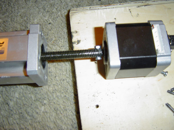

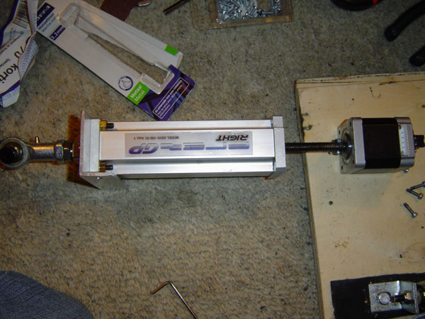

    Here some pics how i did the fix....only i need to replace the normal nut to a locknut. Stores are closed now i will buy some tomorrow and test the actuators.
    EDIT: It works, now i hope they last long enough till i have some cash for 150mm..... :uups:

    today my pin broke.
    Can you explain me, how you removed the old pinout of the Motor shaft and the spindle? Was there only a hole on one side of the spindle? Mine has only one...
  17. Henning Piez
    Henning Piez Member
    Jan 18, 2010
    110
    Stuttgart
    17Coins
    Found it,... had to drill into the motor axle to remove that securing epoxy.

    Just fixing the SCN5. When you drill the hole for the pin and use a screw with a nut, isn't there a problem / crash with the overlapping hexhead and nut while initialization the SCN5 (going to the lowest position)?

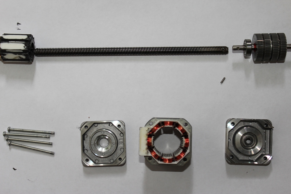

    pitstopp Active Member
    Feb 12, 2009
    116
    Dortmund
    634Coins
    +55 / 0 / -0
    3DOF, SCN5, SimforceGT
    Hello
    I had an issue with my SCN 5 Actuator .
    The motor bearing failed!
    With some skills and Tools it´s easy to disasassemble the actuator.
    Remove the Plastic Caps
    Loose the Screw from the Light sensor at the back
    remove The Light sensor.
    Be carfull with the segment disc! it´s only very thin Plastic. I avoided to touch it.
    loose the Sement Disc, make sure to use the correct Hexwrench. The srew is very Tight!
    Bring the rod to it´s max length, loose the Motor from the rodhousing.
    You can spin the jacksrew out of the rod by hand
    loose the Motor srews
    fix the aluminium Endhield in a bench vice. with some carfull beats with a plastichammer you can drive out the shaft out of the bearing.
    To remove the Frontshield you have to disassemble the Jackscrew form the Motorshaft.
    There is This small pin which ist glued on the jacksrew.
    to remove the glue warm it very very Carfully with a gasburner . not above 100° .
    It´s nessacary to warm it cause the Jacksrew is glued with the Motorshaft also.
    Now you can turn the shaft by hand.
    remove the bearing.
    The Bearing is very Cheap 1€
    it´s a 625ZZ r normally used in Inline Skates. You can get it easy on Ebay!
    IMPORTANT
    The Bearing (in The Aluminumshield) AND the jacksrew/ Shaft MUSt be glued together with
    Loctite 638/ 648, refer to the Tech Specs Sheet!
    let it dry 24H
    Glue the pin with 2 Componet Glue
    Make sure the Motor spins easy and has no mechanical resistance. ( Do not confound with the Magnet resistance)
    Be carfull that there is no metall abrasion / parts on the Motormagnet. it´s hard to remove cause the magnet is very strong .
    I used adhesive poster tape , chewinggum will work too.
    Assemble everything in the inverse way.
    If there are any questions feel free to ask!
