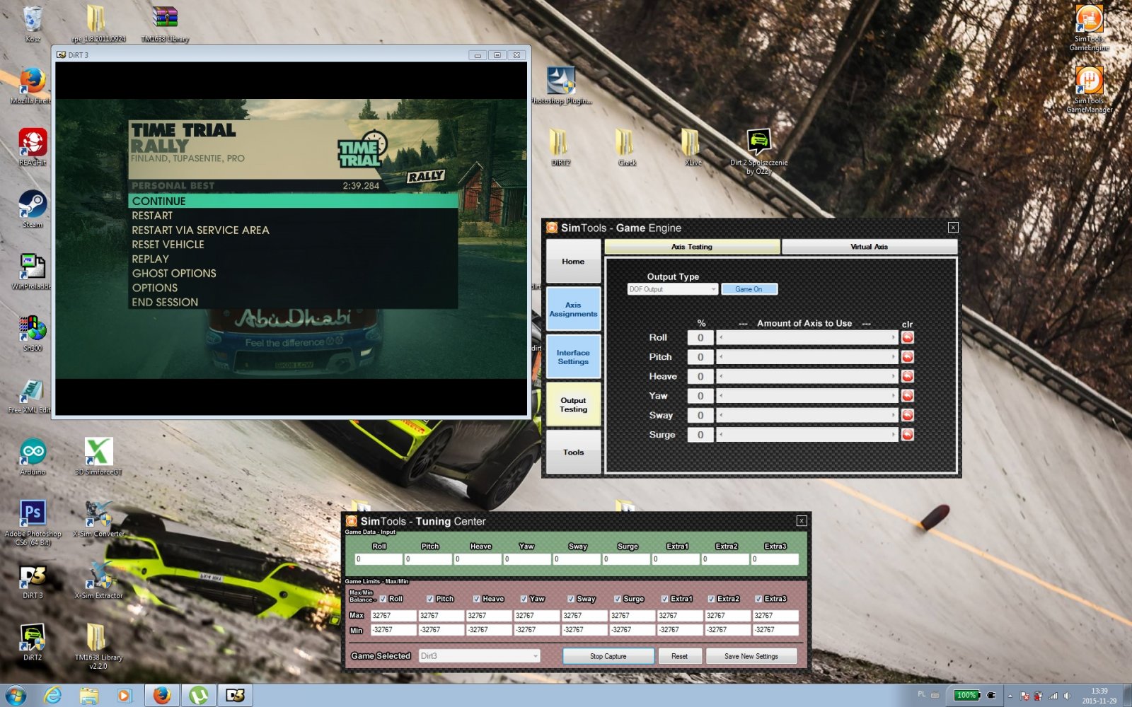

    I am a beginner and too much do not know what settings to use .
    What settings should be ?

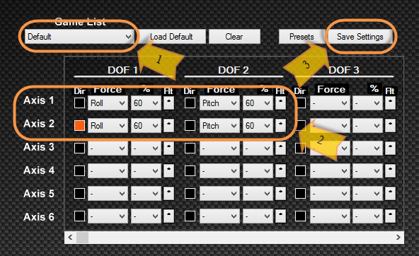

    I agree with @bsft, unless there is some reason for it turn the Axis Limiting back to 100%.
    Are you following the manual: http://www.xsimulator.net/simtools-complete-documentation/
    I ask because you would normally have the same axis, say pitch, on DOF2 for both axis in the Axis Assignment tab, with the forces running to extra columns, like this:
    but yours are set like this:
    Download @bsft's guide and follow the SimTool part, do sway first starting at 20%, then surge, once those are right add heave: http://www.xsimulator.net/community...-set-up-simtools-jrks-and-write-profiles.112/

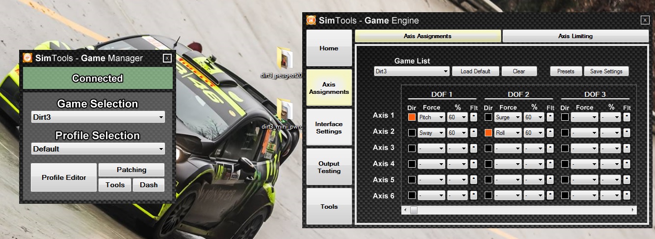

    I changed the settings as pictured .
    As Press " Turn On " is " Roll" and "Pitch " as moving the motors work.
    How to Run the game I have a blue icon "Game on ," but did not react , the engines do not want to work.
    Anything else you need to change ?

    Can you confirm that you have followed the advice already given, including using @bsft's guide starting with sway and surge?
    Have you patched the game for motion with Game Manager?
    Does Game Manager turn blue and say 'Connected'?
    You need to run a base setting for the Tuning Center: http://www.xsimulator.net/community/faq/set-base-tuning-motion-values-in-the-tuning-center.122/
    Then you can manually tweak the Tuning Center values further: http://www.xsimulator.net/community/faq/tuning-center-entering-manual-values.210/

    Have you patched the game for motion with Game Manager? YES
    Does Game Manager turn blue and say 'Connected'? YES

    try this path for patching game
    C:\Users\X_USER\Documents\My Games\DiRT3

    Done
    Running, now I'm gonna consisted of a small model , and the time frame welded to the chair .

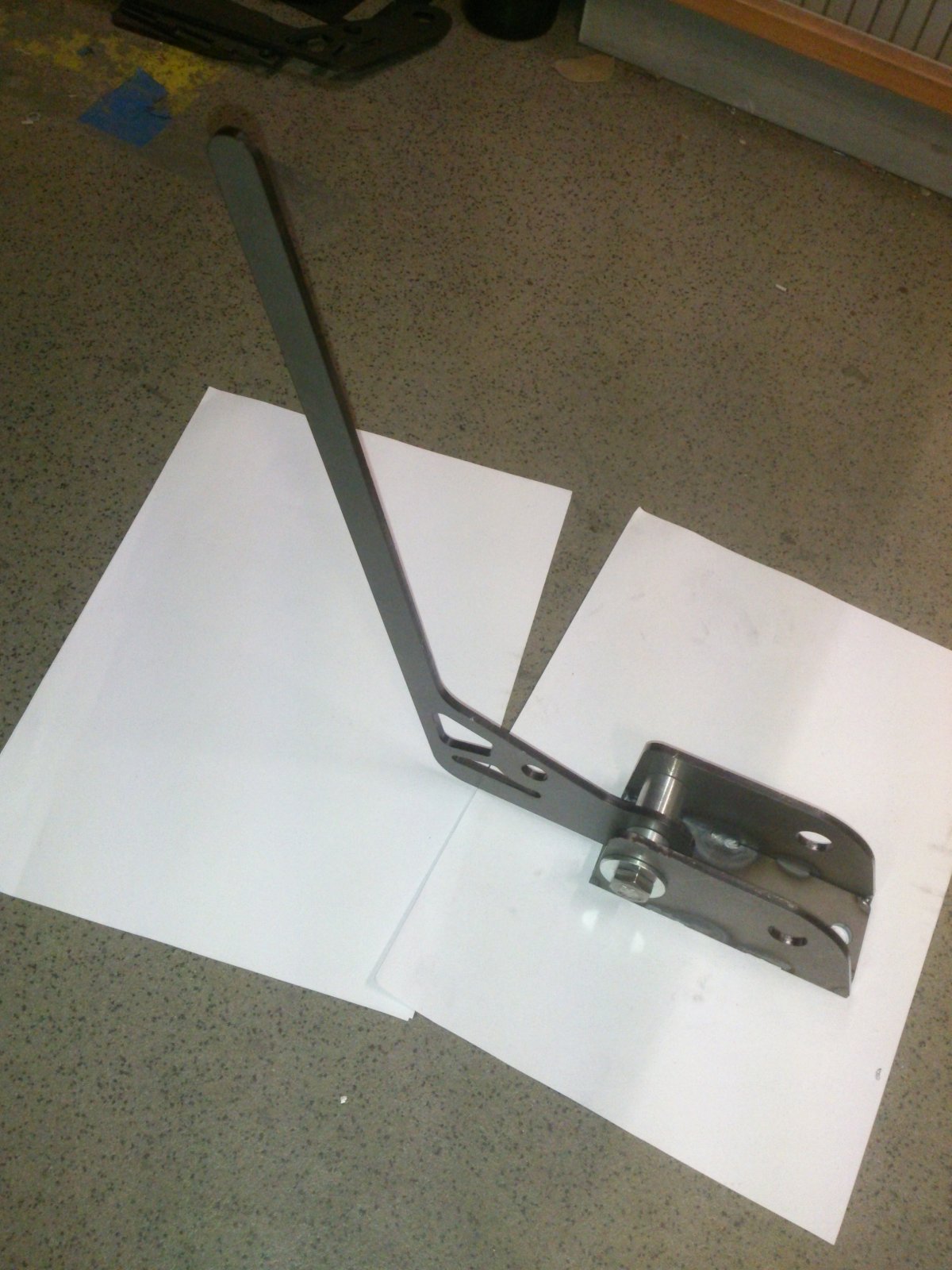

  17. lukas12
    lukas12 Member
    Sep 16, 2015
    52
    Poland
    118Coins
    +35 / 0 / -0

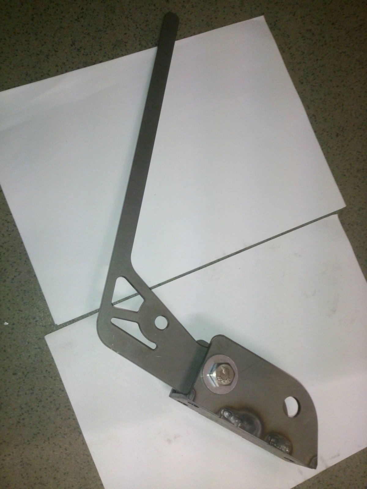

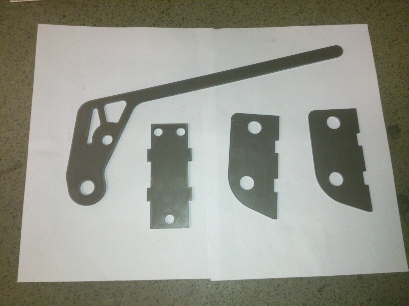

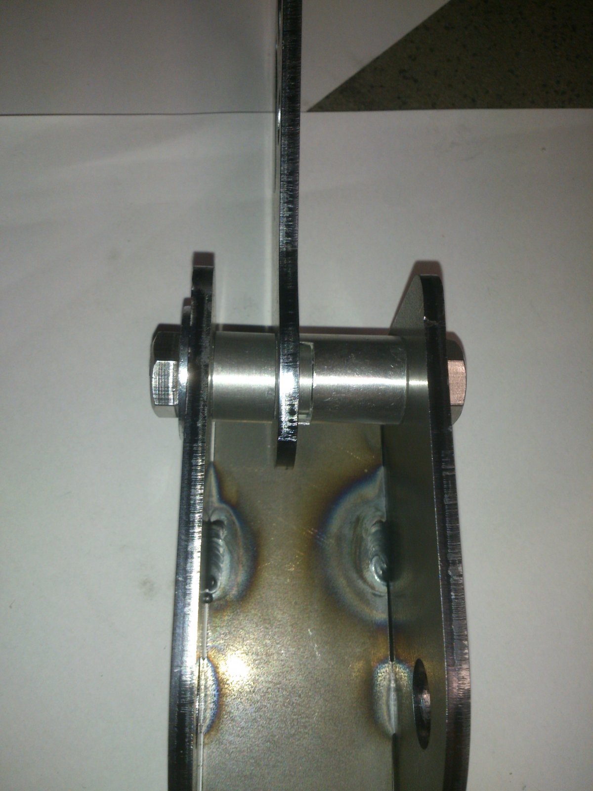

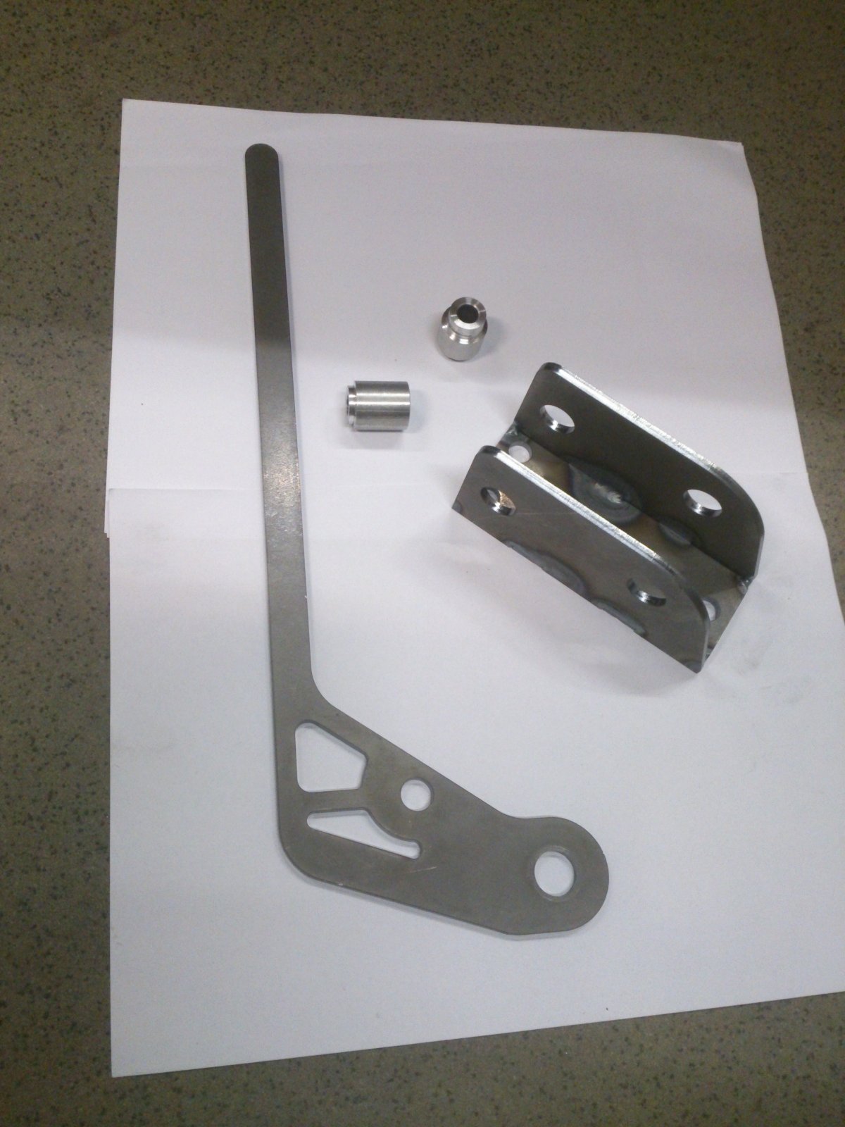

    hand brake

  18. noorbeast
    20,565
    145,262Coins
    +10,782 / 52 / -2
    Nice work on the scratch built handbrake.
    Will it include hydraulics or some other form of resistance for feel?
  19. lukas12
    lukas12 Member
    Sep 16, 2015
    52
    Poland
    118Coins
    +35 / 0 / -0
    aluminum shaft and spring . Tomorrow I will continue what he thought. :)

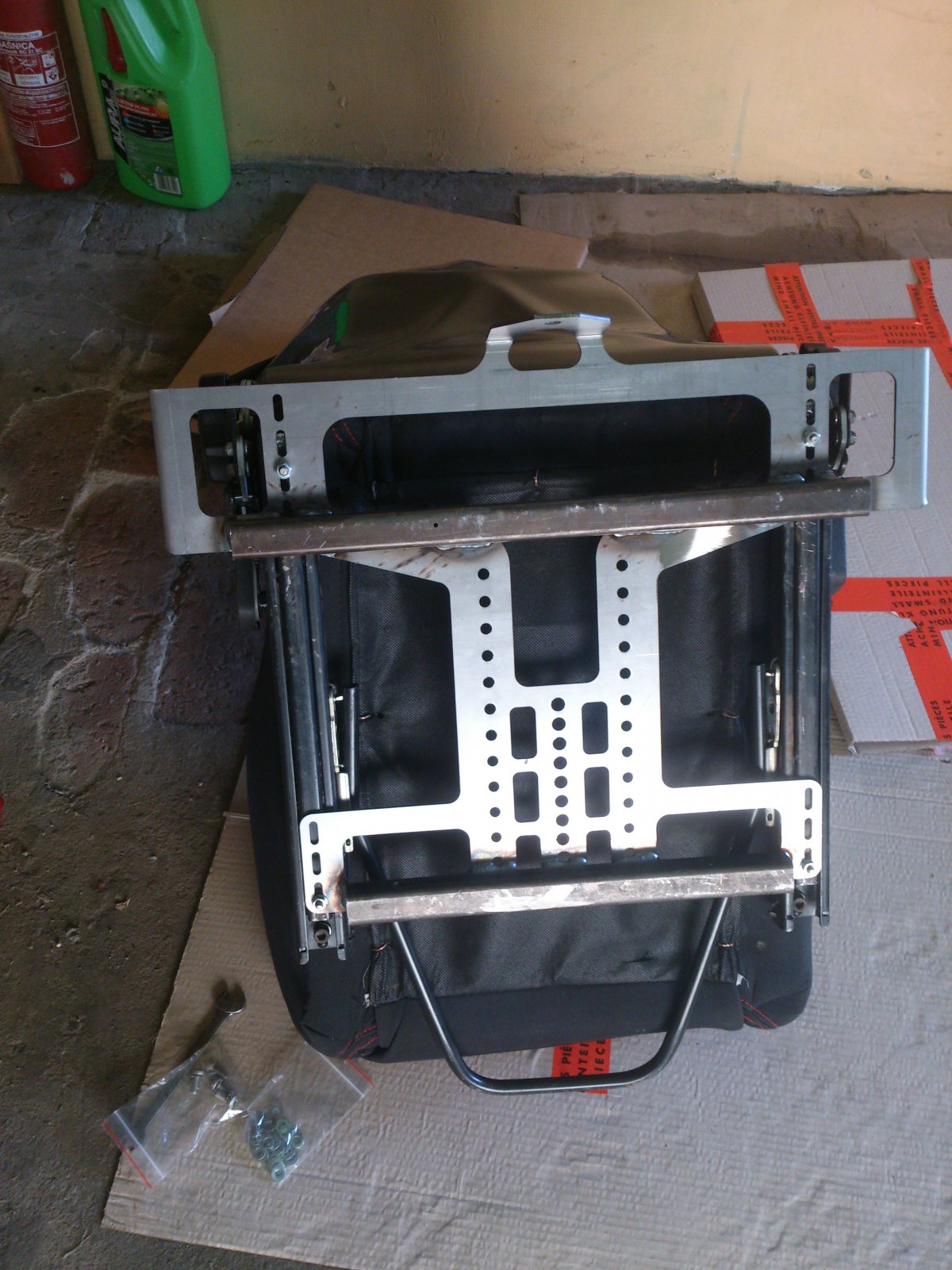

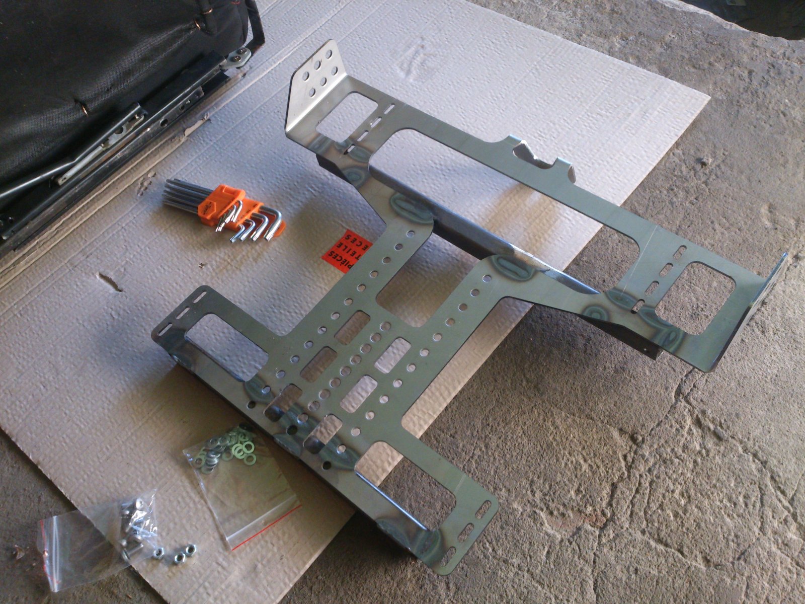

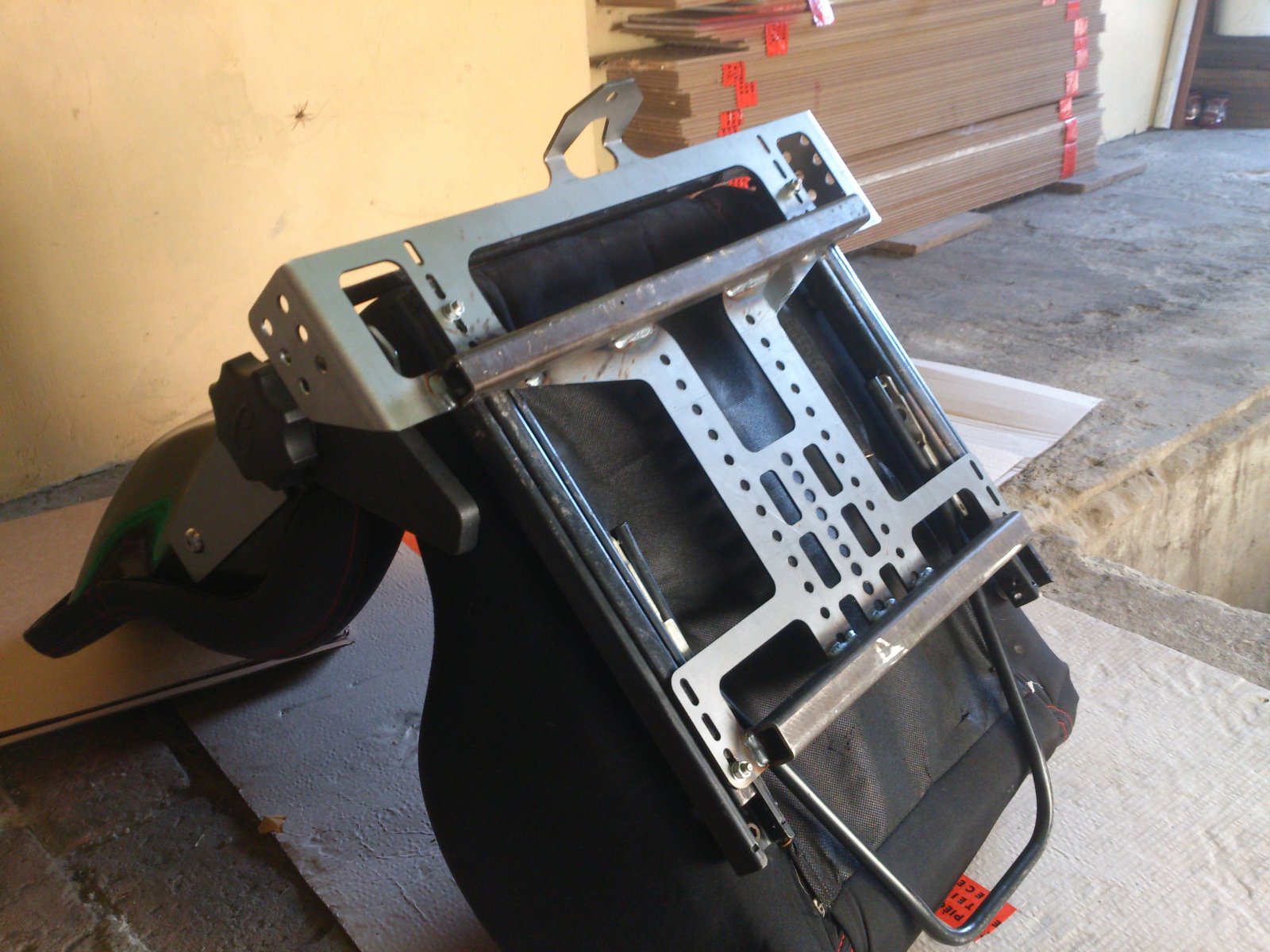

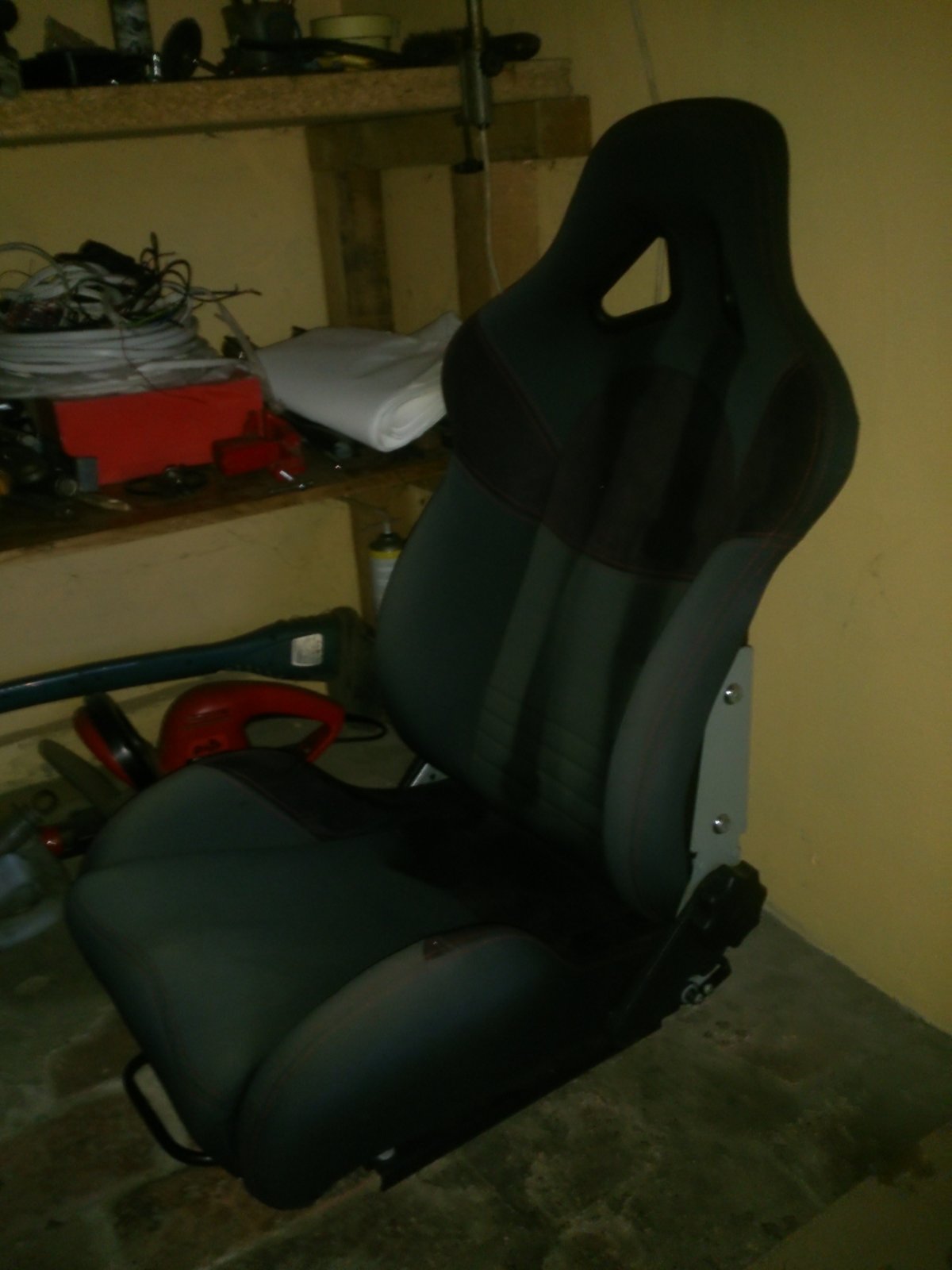

    Holder seat , 3mm steel had to add two sections to not bent . The screw holes fit perfectly. Seat adjustment works without a problem .
    Now I'm doing the drawing frame.
