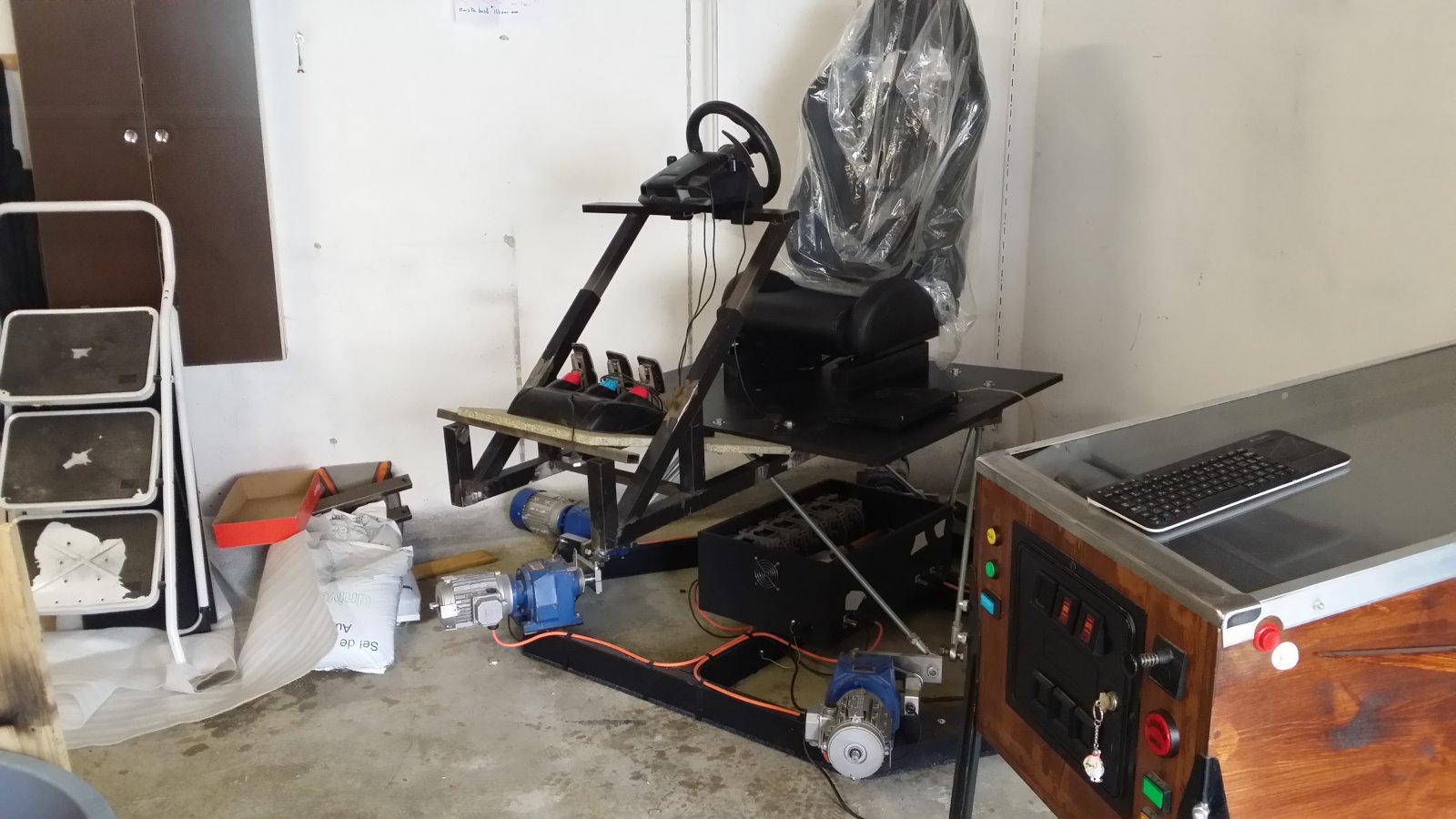

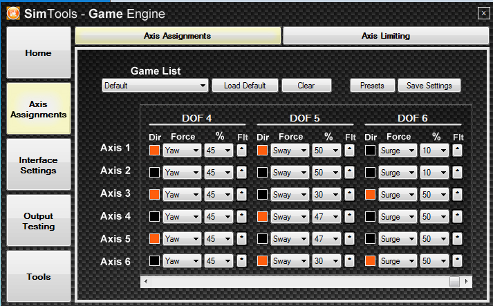

    dof-simtool-1-3.PNG dof-simtool-4-6.PNG honestly, I do not know answer to this question.
    sorry :(
    it depends engines can be used ...
    I set the dof. I have a problem with surge
    a demo with rfactor

    That really is a nice 6DOF sim, well done:thumbs, but are you really using SimTools by itself to calculate its movements?

    AC motor, 6DOF
    yes yes of course
    I'll make a video to show

    IMO,it seems for Roll DOF you should reduce the values for the front pair motors
    good job and regards

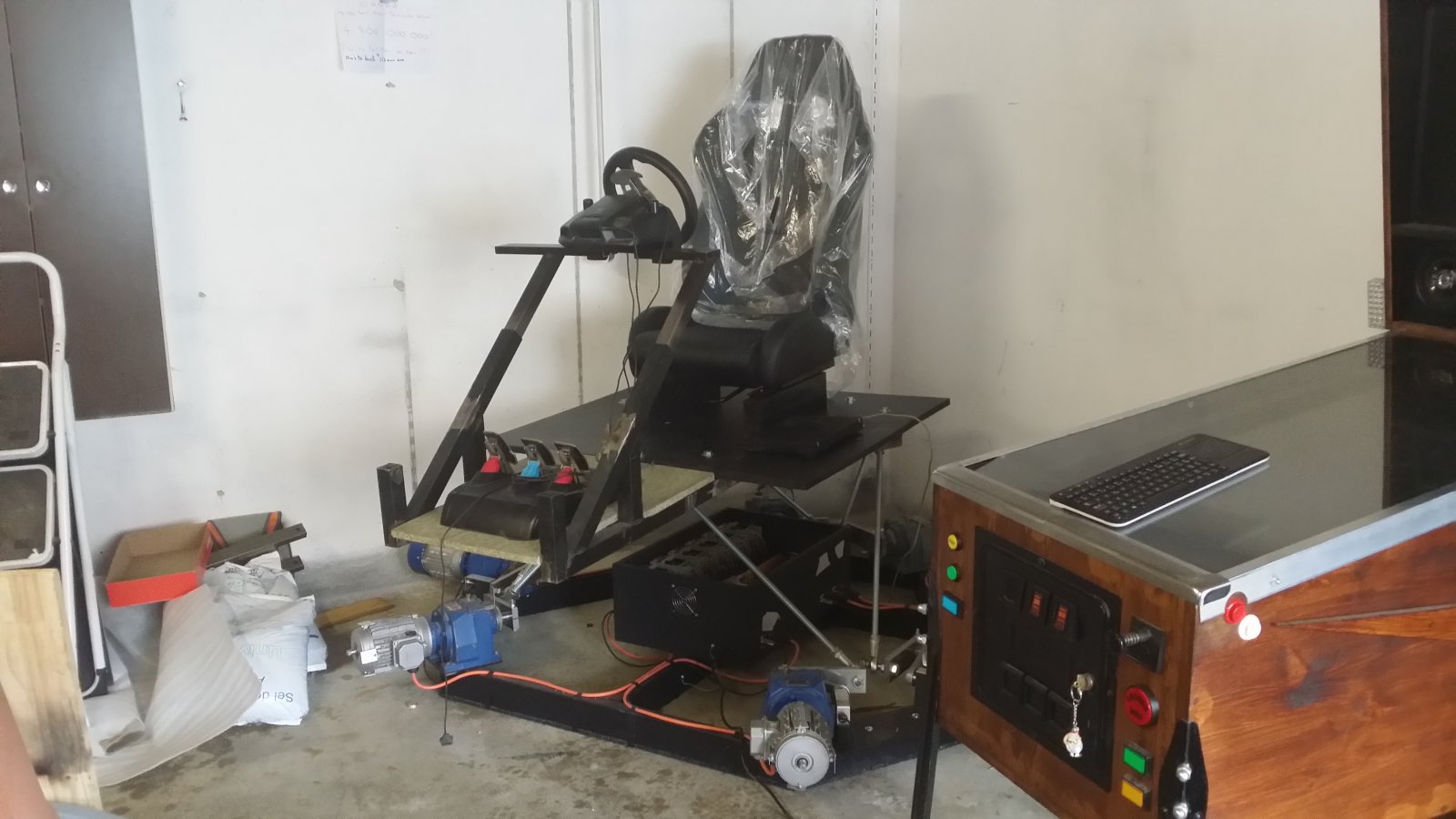

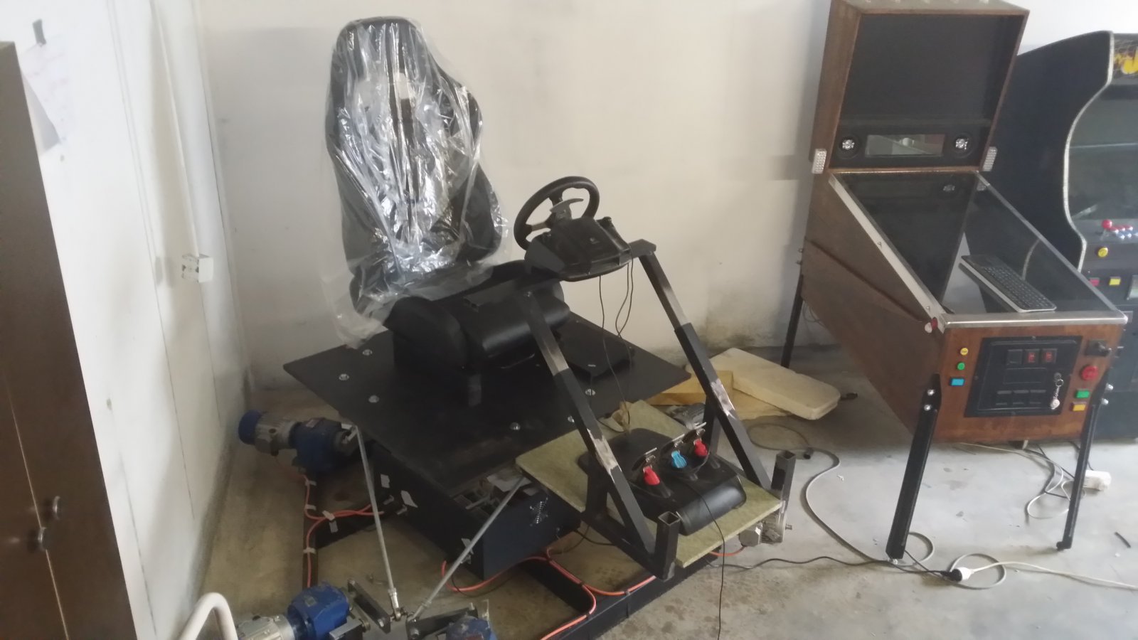

    20140826_180255.jpg 20140826_180312.jpg 20140826_180333.jpg 20140826_180530.jpg

    stress test
    300kg 70hz 20rpm

    I think I can go up to 100hz. 32rpm
    but I think it will be too violent
    i use amc1280usb
    PC => amc => inverter => motor

    they are gear motor.
    in my case,
    a) coaxial Gearmotor
    AC three-phase motor 0.55 kilowatts. 1500 rev / min. 230/400 V. IP55 Cl F.
    (Standard motor without brake)
    Ratio: 1 / 99.21
    Output speed: 14 r / min
    Nominal output torque: 347 Nm
    Output shaft diamêtre 25 mm x 50 mm
    for inverter i use omron j1000
    I do not know if it is possible to use Arduino
