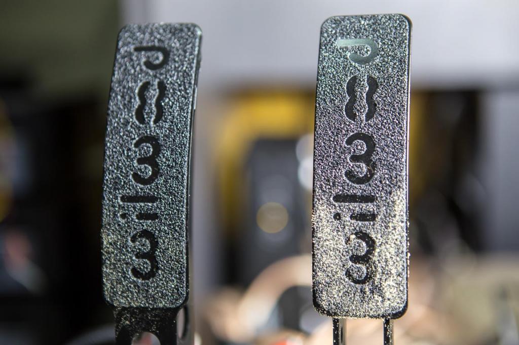

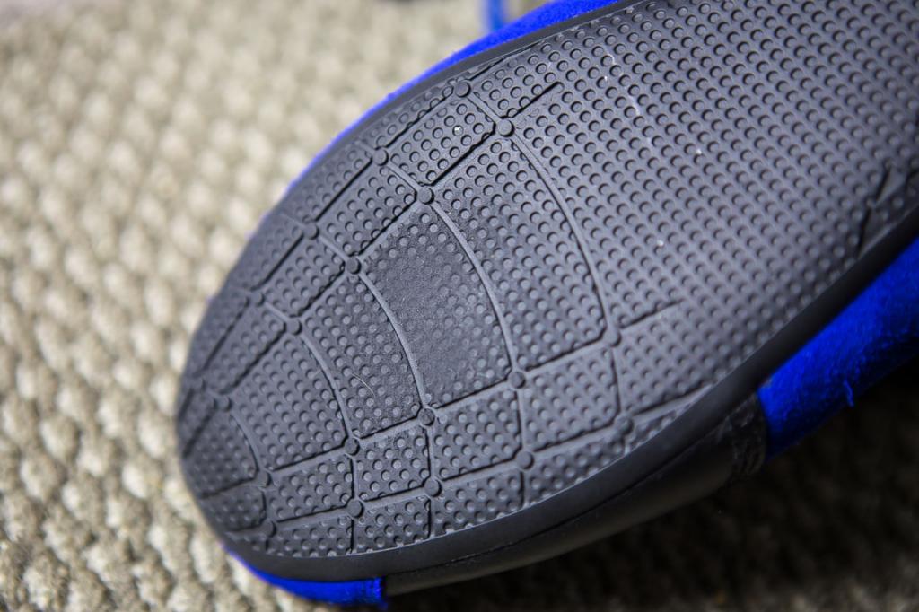

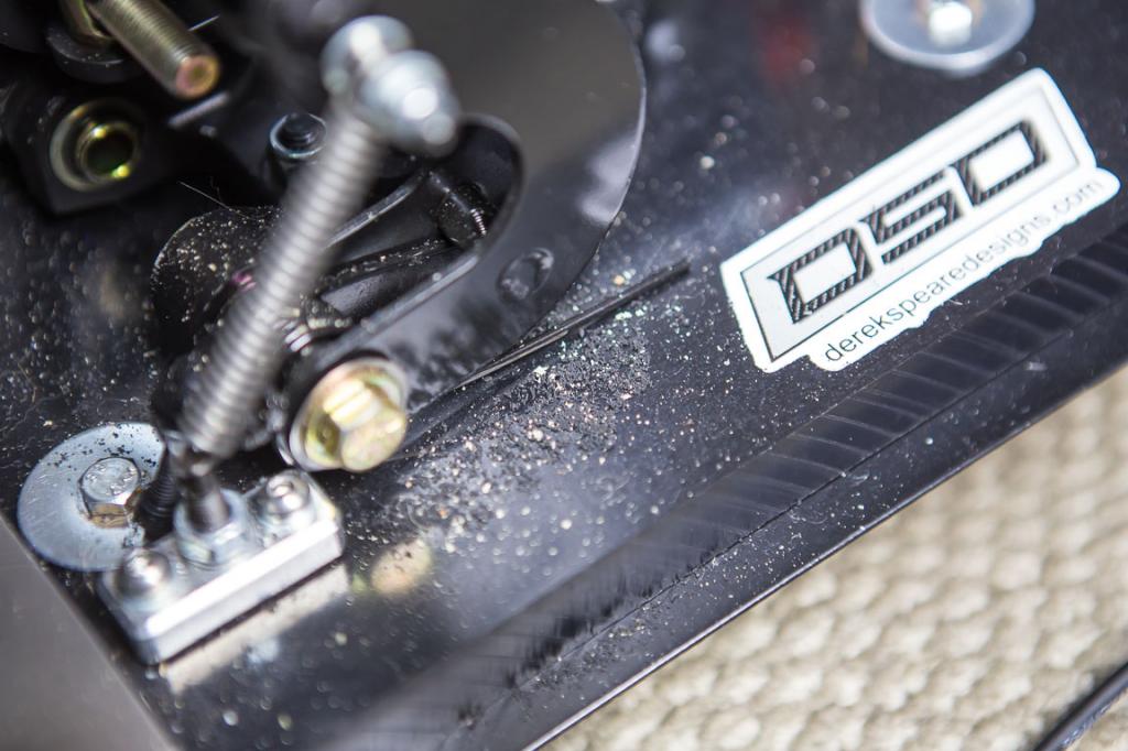

    The DSD pedals I use have really rough grip tape on them and they just rip socks apart.
    So boots are pretty much required.
    One of my friends tried out my pedals in his street shoes and you can see how much rubber it took off
    It even wears down my race boots. This was after my first couple of races
    After each race I need to sweep up all the little rubber marbles left behind
    20,565
    145,262Coins
    +10,782 / 52 / -2
    Those DSD pedals give a whole other meaning to 'traction control', they are like taking a rasp to your foot ;)

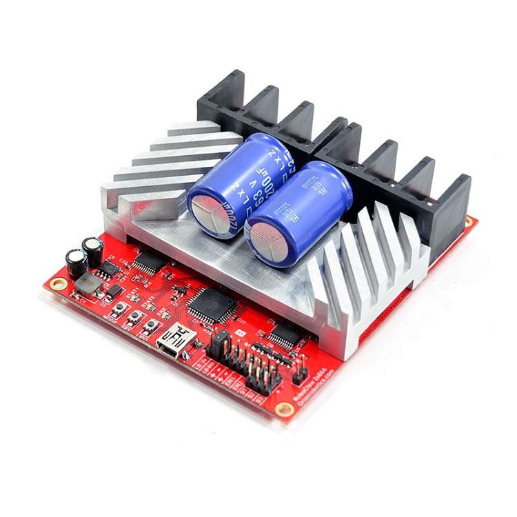

    So after a bit of use I have found that the JRK's can't quite handle to current needed to drive these motors hard. I mean they run fine if I limit the duty cycle down but even then in some more extreme corners I can hear the JRK's tripping out.
    When we did some testing we found that the motors were peaking at over 70 amps each.
    I have been looking at some more powerful controllers and I found these ones https://www.pololu.com/product/1499
    They control 2 motors so I would only need one of them and they come in 2X15A (2x30A peak) 2X30A (2x60A peak) 2X60A (2x120A peak)
    I was thinking of using the 2X60A (2x120A peak) one that way I have no problems with overloading them.
    What do you guys think? Could I get it to work like the JRK's or am I just better off limiting the JRK's and living with what I have?
