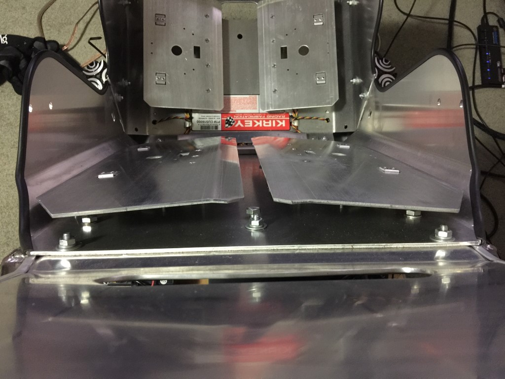

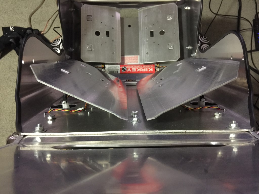

    Yes, that is exactly what it does. The seat mover is great for feeling the pressure on your ribs, especialy with the Kirkey seat the the GS-4 uses because you sit really deep inside it so as you corner your ribs press against the metal sides which have no give in them. Also it has a metal support bar on the bottom which presses against you in braking and accelerating with the seat mover. But as you said you don't feel it so much in your back or bum. That is where the GS-4 is great, it means that you feel that pressure over your whole body.
    The servos are really powerful. It has no problem pushing all my fat out of the way. And the range of the motors are crazy. There is about 80mm from full back to full forward. Anything over about 50% on both back panels is pressing me so hard that it is starting to hurt and it has not problems pushing me to 100% of it's travel, not that you would want to because it would probably crush your kidneys and a few other internal organs :p I would say in racing that you would probably use no more than 30% of it's travel. When I used to race IRL I would quite often have sore ribs after a race, I get the same thing with the GS-4.
    Here are some photos of the GS-4 range of movement.
    Fully back
    Fully forward

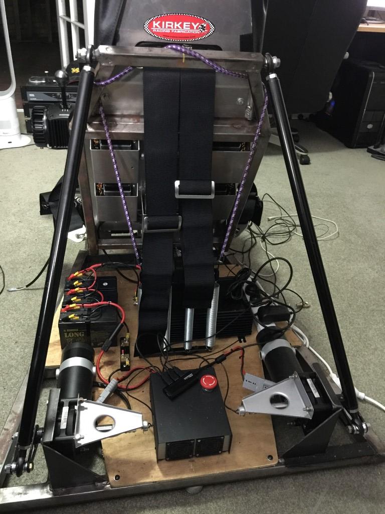

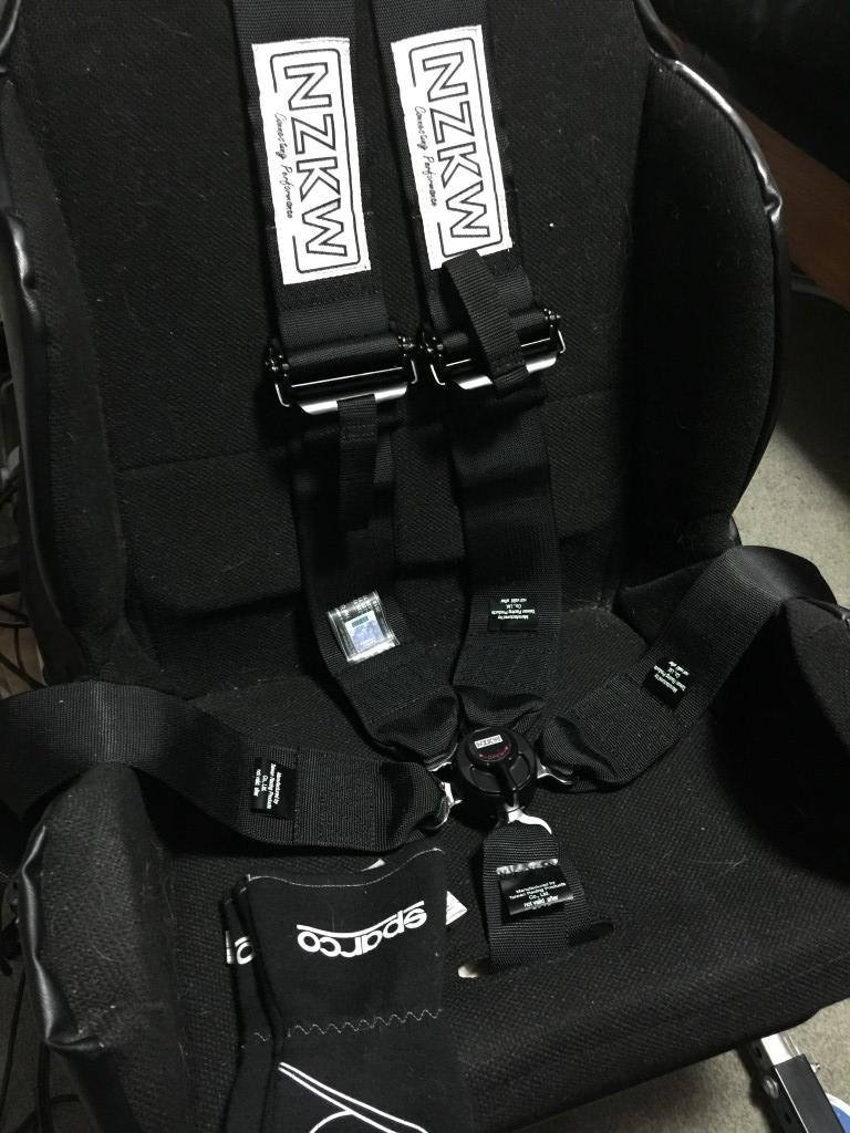

    My latest addition.
    NZKW 6 point 3" FIA approved harness.
    Why 6 point harness? Because racecar!!
    Hopefully I will get a chance to install them tonight.

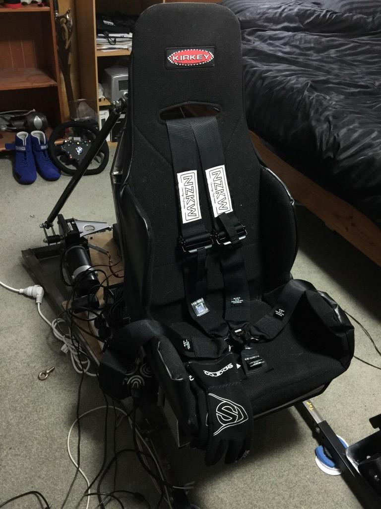

    iRacing does a Tech Inspection every time you start a session so I was a bit worried about failing that. The belts don't expire until the end of 2019 so I am golden for another 5 years :p :grin
    I got them installed and did a little test with the AI and holy crap does it make a huge difference. Especially with the GS-4. Because I am pinned to the seat then I can feel the pressure so much more.

    They really complete the picture!
