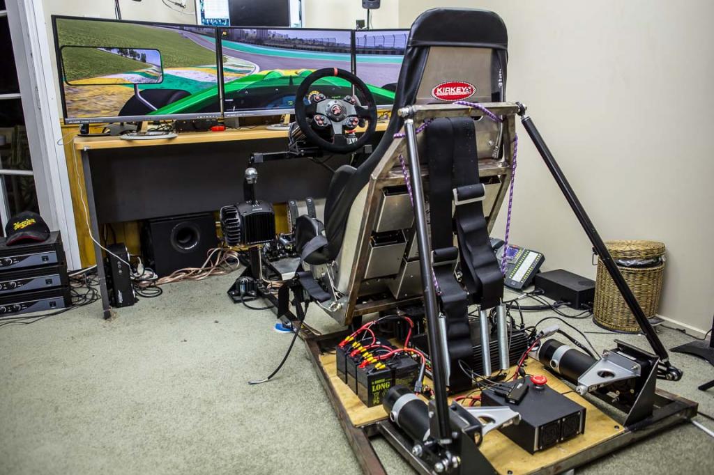

    I think I made the right call on the motors due to my size. They have no problem moving me. I just need to find the right controller later. But for now it is working well.
    Some more photos of my rig
    My front kill switch. Only cable tied on at the moment until I make my new dash
    A wide shot of my rig

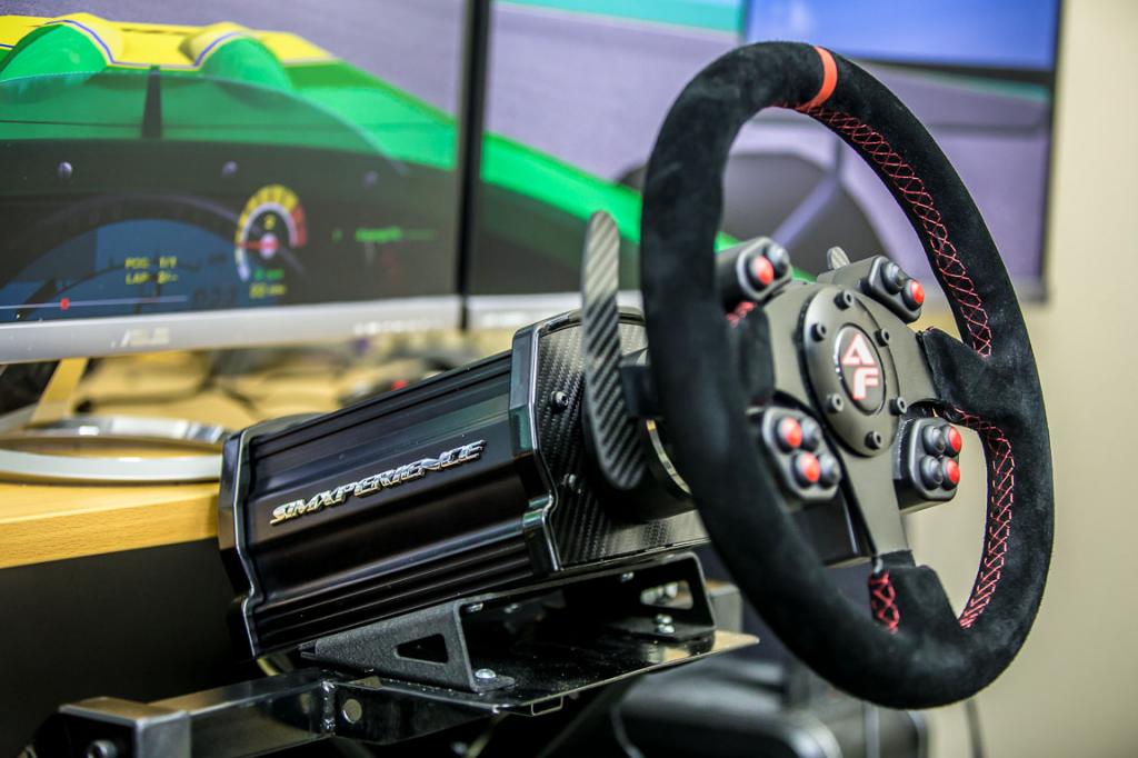

    My Accuforce Direct Drive wheel
  2. bsft
    I just had a thought, those batteries you are using, what is the voltage coming out and what is the voltage you are charging them with?
    Are the batteries bridges together in anyway to give you the combination of having one big battery?
    I had motor errors and spikes causing mine to stop until I finally took off the car battery and 13.8v psu and ran 2 x 12v psu.
  3. Avenga76
    Avenga76 Well-Known Member
    Jun 29, 2014
    518
    Network Engineer
    Auckland, New Zealand
    3,260Coins
    +853 / 6 / -0
    It is a constant 13.8v
    There is no advantage to running a bank of batteries versus one big one.
    I only used these because I got them free from a UPS upgrade at work. UPS batteries are perfect because they are designed to be always charged but capable of heavy discharges.
    They seem to cope fine. I can do a whole nights racing and they are still at 100% charge.
    They are only acting as a buffer to protect my charger from these large spikes. The charger is plenty big enough to keep the batteries topped up.
  4. bsft
    can you get a solid 12v going through it?
    Only a test, but I found in my case with my actuators, I had to go to 12v to solve a heap of problems
    I never ran out of charge, but for some reason, I stopped spikes and errors on my set up from going from 13.8v - battery to dual 12v power supplies. And they are actually 12v output

    @Avenga76
    You already got the Accuforce? Awesome!
    What have you got before?
    And does it justify it's price?

    @bsft I can't get 12V going though my systems easily. Battery chargers need to run a 13.8V or higher to charge. I turned off my charger and the batteries are holding at 13.4V. The only way to get them lower is to run them flat.
    I am not sure of that would help because if you lower the voltage you increase the Amps and the Amps are what I am trying to cut down on.
    For example, if I had a 160w motor @ 12V it would need 13.3A but @ 13.8V it would only draw 11.5A, with the peaks, a 70A peak @ 13.8V would be 80.5A @ 12v
    I checked with the supplier and he said they the motors handle up to 16V and the JRK's handle from 6-16V so I think the more volts the better so I have less amps.

    @prodigy I was a beta tester for the Accuforce so I have had my wheel for a while now.
    Before this I have a Fanatec CSW v1 and before that a G27.
    Is it worth the price? Very much so. It has completely changed the way FFB works. It is on a whole different level. I don't use in game FFB now. I disable the in game FFB and use the SimXperience FFB which uses the games telemetry to recreate the FFB using physics.
    You guys know how powerful the telemetry from games are because it is what runs our motion, it is taking that power and using it on FFB.
    And the power and speed of the Accuforce, it is unreal. I used to think the step up from the G27 to the CSW was huge, but this is a whole other level.
    I wrote a couple of reviews on the Accuforce where I go in to greater detail.
    http://www.isrtv.com/forums/topic/16563-avenga76s-simxperience-accuforce-review/
    http://members.iracing.com/jforum/posts/list/575/3293454.page#8672951

    Have a read of these 2 post.
    PID didn't seem to have much effect on the overload errors.
    Turning down the max duty cycles helped. 400 and it is mostly fine if I am driving. If I have guests over who are going to go off track then I will drop it down to 300, 250 if they are really bad. That seems to keep the errors in check well enough. I still get some but not enough to get in to that chain reaction of errors that you can see in some of my other videos.
    The braking setting will fix it BUT it is no good for simulator use. It is under the motor tab. There is a field there called "Brake Duration(ms)" that will add a pause before changing direction. So if your motor is going full speed forward and you as it to go full speed in reverse then it will wait for the amount of milliseconds that you added in the brake duration field. This can go up to 1200ms which is a 1.2 second pause between changing directions. I can run my motors full noise with a 50-100ms pause without getting any errors but that would be terrible for a motion simulator when you are changing direction constantly, a 50ms pause between changes in direction would pretty much kill the motion you feel.
    So it is not a solution at all. More just an experiment and a good way of showing exactly when and why these errors happen. With the brake setting on then it gives the motors a chance to spin down before changing direction but it is that quick direction change that you want in a simulator.
    I think the only workaround is to limit the make duty cycles.
    I think the only solution is to move to a more powerful controller like a Roboclaw 2x60a (2x120a peak)
    I just think that with these faster motors the draw needed to overcome the inertia is too much for the JRK's to handle. The only option is to slow the motors down by limiting the duty cycles or add a pause. So really the duty cycle limit is the only real workaround.

    I can get those motors locally but I am a big guy, around 130kg, plus the GS-4 is around 25kg. So I have around 155kg sitting on top of my universal. Early on I discounted using the smaller 25:1 ratio motors due to the weight they will be moving.
    My motors are great because they have tons of torque to move my fat ass. I think going down to smaller 25:1 motors is going the wrong way. I think the motors are the right size for a gentleman of my generous proportions, so I think it is best to keep my motors and find a controller which is powerful enough to run my motors.
