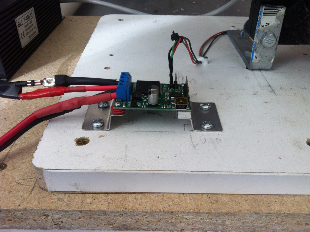

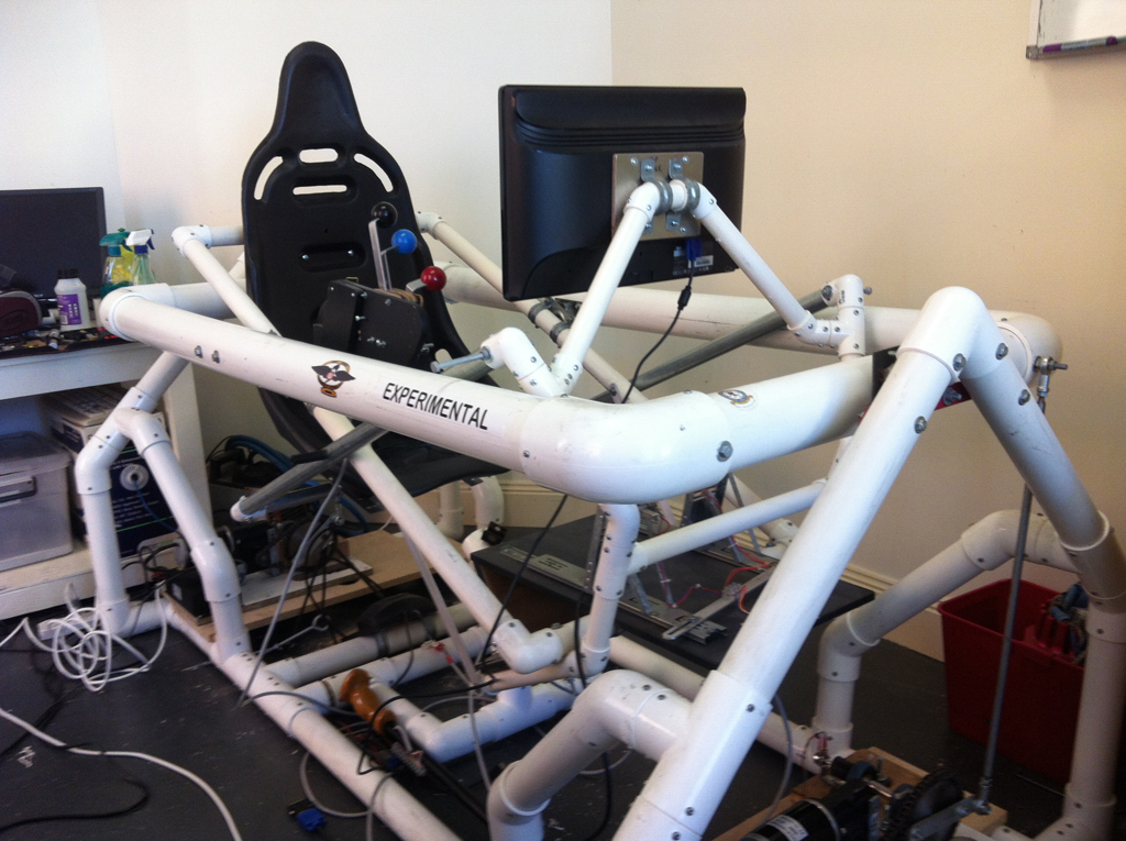

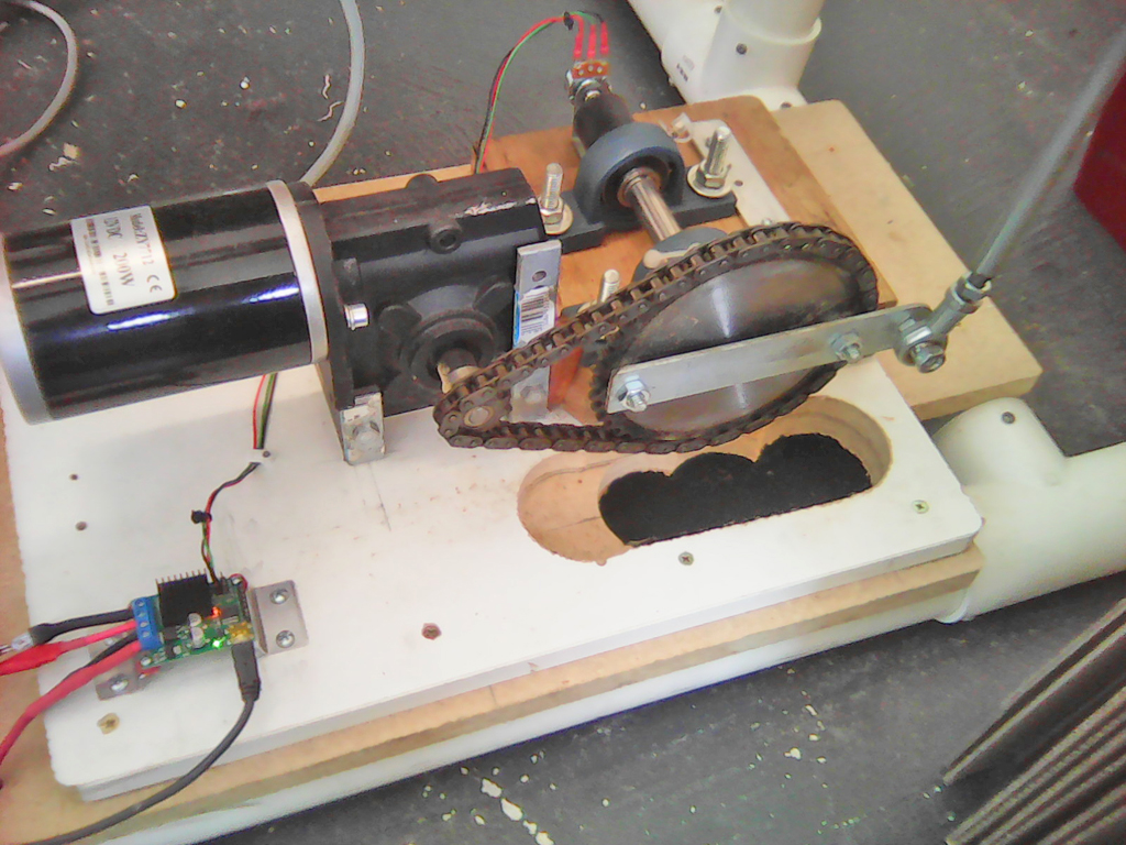

    Hi all,
    Time to document what I've done, in the hope that some here benefit from what I have learned from many others here.
    The project was built some years ago as a standard weight-shift Joyrider and served it's purpose well, including preparing me for renewing my licence a few years ago. But, I became frustrated with my strained left forearm, so embarked on motorising the beast.
    As the photos will show, I have used DC gear motors with sprockets and chains, mounting lever arms on the large sprockets, driving pushrods connected to the joyrider frame. JRKs control the motors, power supplies are 40 amp Chinese eBay specials.

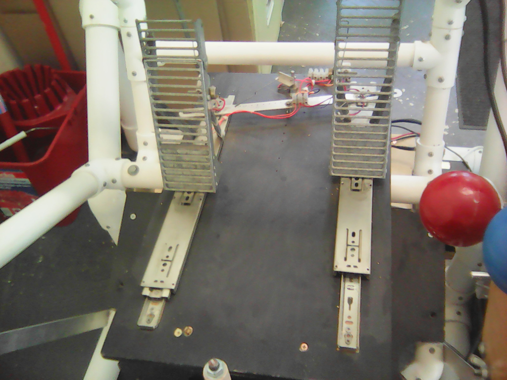

    You will also see my homebuilt throtlle and rudder pedals in the photos.

    Nice! I like the server rails as rudder pedals (or drawer slides?) I am actually building some up myself, so good to see I'm not alone in that thinking.
    Good work :)

    Yep, filing cabinet drawer runners.
