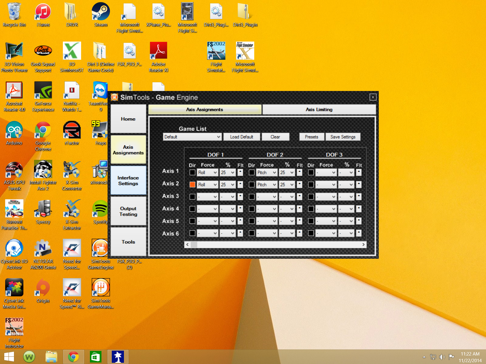

    Ok the setting can be found in SimTools already.
    Open the Game Engine.
    Press on the Axis Button, on the right.
    Set your default axis , Axis 1 being one actutor and Axis2 is the other.
    Just as a test set Roll and Pitch only. You can revisit later to add more.
    Once you have set something like Axis1 - Roll 50% - Pitch 50% and Axis2 - Roll 50% and Pitch 50%.
    The little box next to each force allows you to invert the direction of the movement, like for Roll one will be inverted.​
    Press Save settings in the top bar.

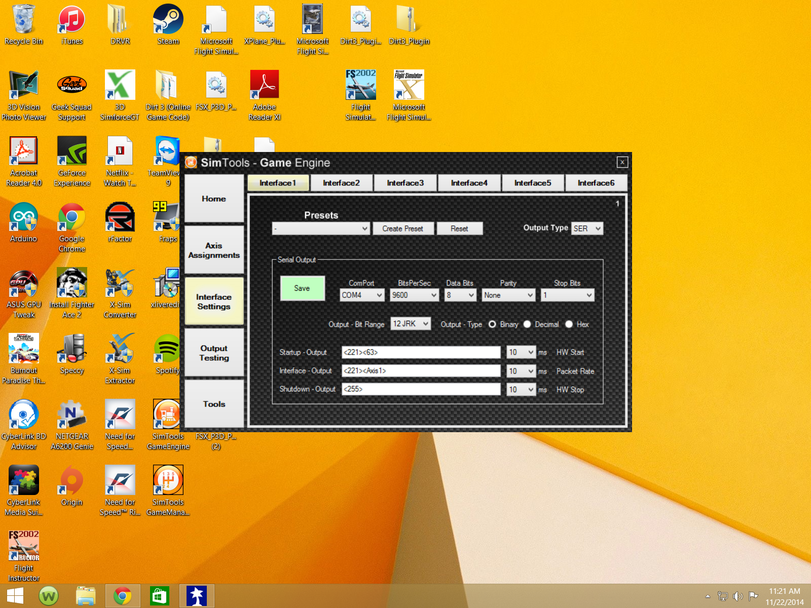

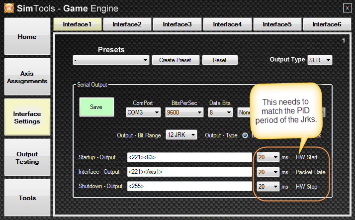

    Press on the Interface Settings button on the right.
    Press on Interface1 button on the top bar, which will be one Jrk.
    Press on the dropdown box labeled Output Type and select SER for Serial communication.
    Press on the dropdown box labeled Presets and select either Jrk12bit or Jrk7bit worth trying both depending on motors, etc.
    Now this will fill or the details in for you, except you need to select the right comport for the Jrk which will be Axis1.
    Then change the BitsPerSec to 9600 which is the default for Jrk baud rate, it will work at higher speeds , the Jrk picks up the change and adjusts itself accordinly.
    Now you need to know the PID Period setting from the PID tab in the Jrk Utility and make sure that the ms for HW Start, Packet Rate, and HW Stop is changed to the same as you have setup in the Jrk Utility.​
    Press Save
    Press Interface2 button on the top bar, which will be the other Jrk.
    Now set it the same as you did for Axis1 Jrk except the change the comport to the right one (command port) and you need to change Interface - Output to read <221><Axis2>​
    Press Save.

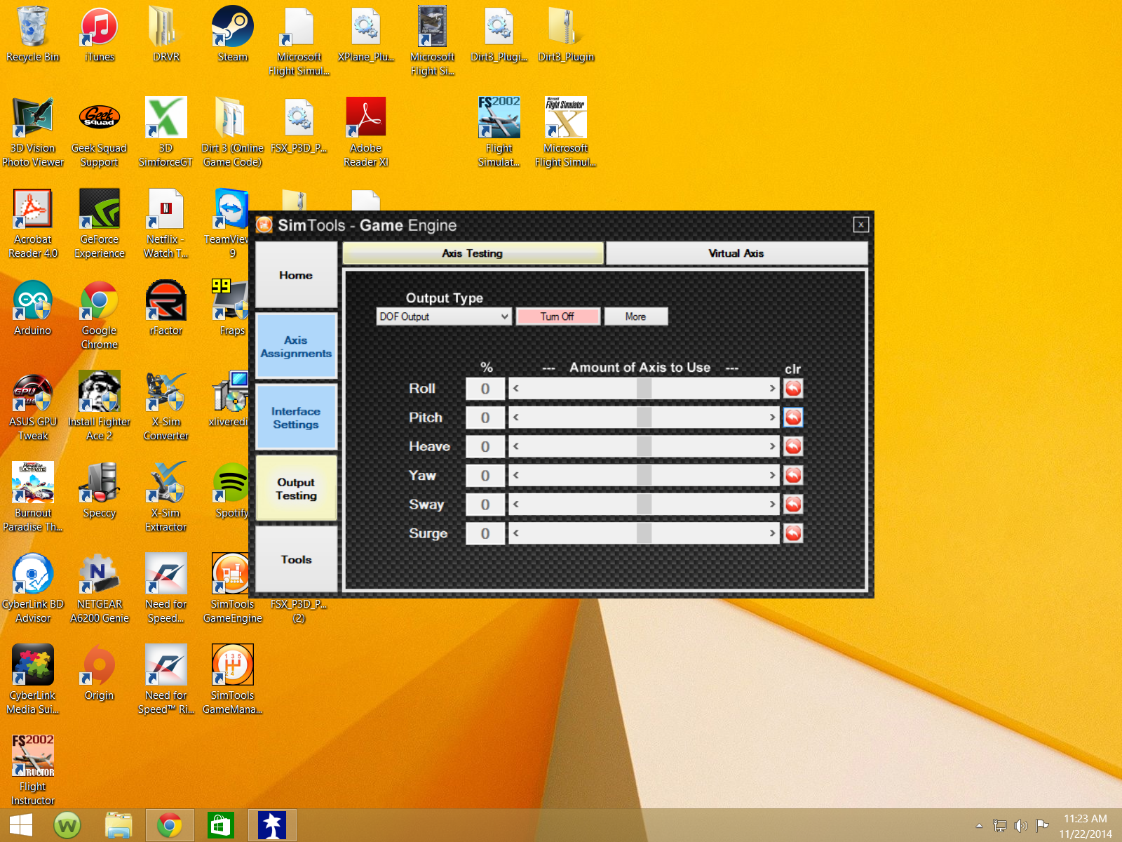

    Right now we are ready to test the Jrks in SimTools first before setting any game up, I strongly recommend getting this right first.
    Now to test all the above settings,
    Press Output Testing button on the right button bar
    Press Turn On
    The Jrks should come to life and move to there centre positions, normally very sharply.
    Now you can move the sliders and check that the Sim Rolls and Pitchs correctly, if not Press Turn Off and invert the force on the right axis in the Axis Settings. And turn back on to test the sim movement and note this only used to test the directions and the amounts of axis used by each force, doesnt represent the game movements, they are a lot faster.​
    Once we know that the Sim (Jrks and motors) are doing all the right things I will move on and help you through setting up a plugin and your first profile. I can share my Dirt3 settings which will give you a fast base to start from.
    But first let us test the Jrks and get that part right, including going back to the Axis Settings and adding in Heave, Sway and Surge the key in achieving a nice balanced motion is that the total % of each axis does not exceed 100% too far.
    Once we have a game set up we can then tune the games MIN and MAX to the Actutors easily. I will explain that later.
    Please confirm that you have them runing via the Output Settings and we can move on from there.

    Your PID setting seem a little high to me but if they work correctly then they are good. If you start the motors in the Jrk Utility and move the slider do they follow the slider nicely, ie the error between target and scale feedback in the graph should be a max of 5% for nice motion cueing.
    I use 0.4,0,0.5 , this is the decimal numbers , easier to work with. And Im using 180rpm DC worm gear motors on the JRK12v12.
    Ok the HW Start , etc is located in SimTools Game Engine - Interface setting as pictured below and needs to be set for both interfaces too. And with your setting it should be 10ms.

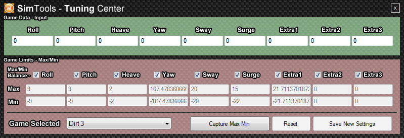

    Ah if you might have read or manual you would have read that the tuning centre is part of the Game Engine.
    Right click on the Game Engine icon in the taskbar
    Select Tuning centre.
    And you can change value while live in game.
    This process is only done once per game, when changing vechiles and you want to fine tune the motion for that particular car , we can do this quickly and live throu the Game Managers Profile Editor.
    Ok I will explain how to tune your first profile to be adjusted later via the Game Manager. This is setting the base Min Max values for your motion.
    Ok I like to concerntrate on one force at a time, makes it alot easier to feel exactly what we want out of the motion.
    Click on Axis Settings
    Turn off all dof except for Roll and leave it at 20-25% if using 5 DOForces
    Start game in a window if pc can support it
    Select the Tuning Centre
    Place that near your Window for the Game
    Start a race and go on track, preferable in practice mode and go for a drive noting how much the roll reacts.
    If there doesnt seem to be much then the MIN MAX in tuning centre is too high and we need to lower these values.
    Click on Capture Max Min change the roll values
    Press Save New Settings
    Press Stop Capture
    Now go back to game and test what the changes have done, basicly what we are looking for is that when we place the car into a big roll movement, the sim reachs the axis % set at the end of the movement and not earlier than. This will help to sync the sim movement to the screen ,etc better feel.

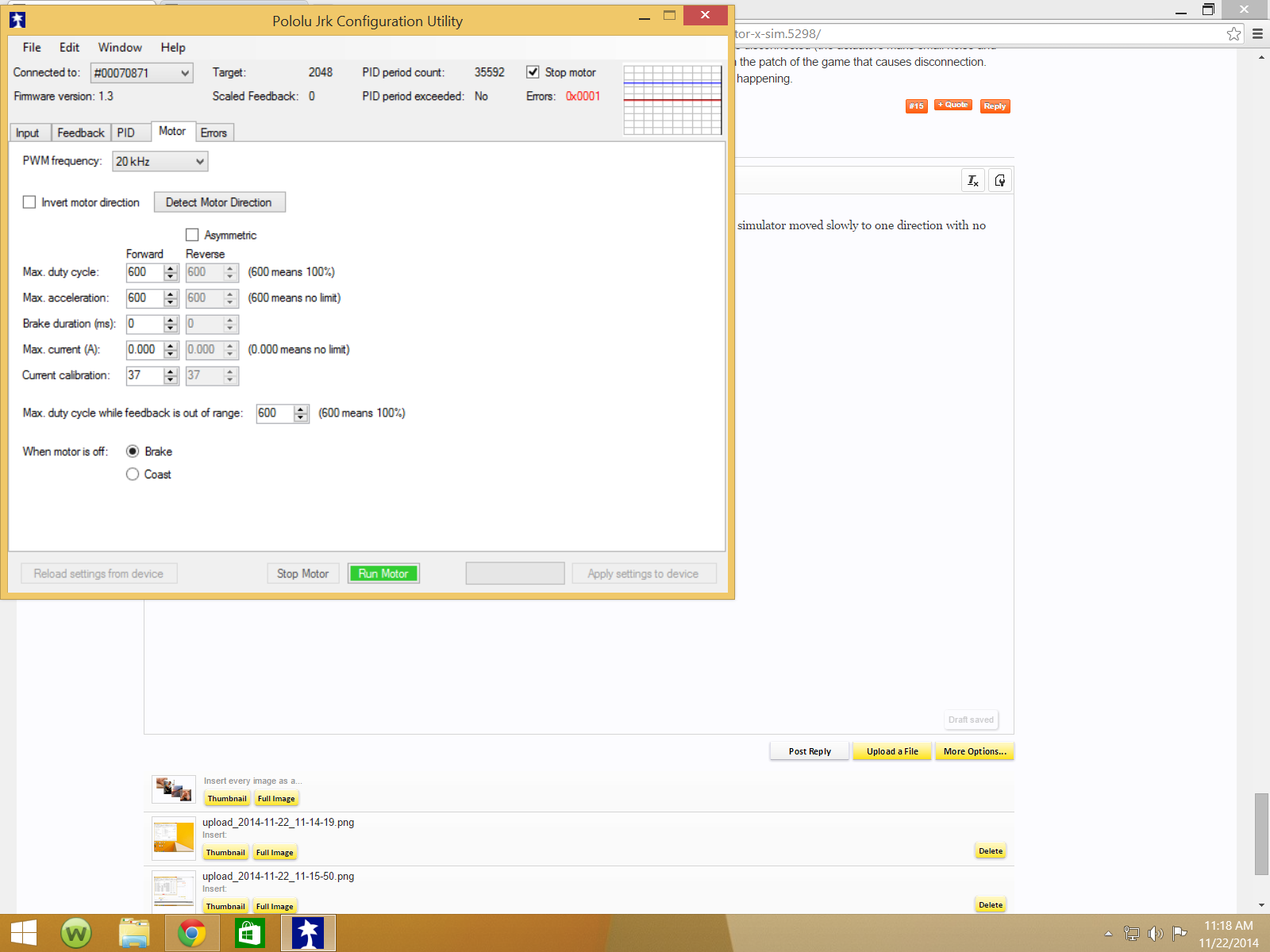

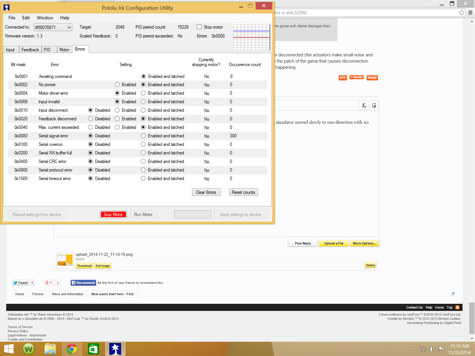

    I need help with my Dirt3 simulator. I haven't been on it for a while and the other day when I tried it, the simulator start moving slowly to one direction with no return to neural position (no-feedback). I'm not sure what it is causing this. I posted some pic from my configuration for your review.
    upload_2014-11-22_11-21-26.png upload_2014-11-22_11-22-20.png upload_2014-11-22_11-23-30.png
    The system manually moves very slowly and during the game it moves to a direction and no stop. Is there any changes that effected the plugin or something? I appreciate your input.

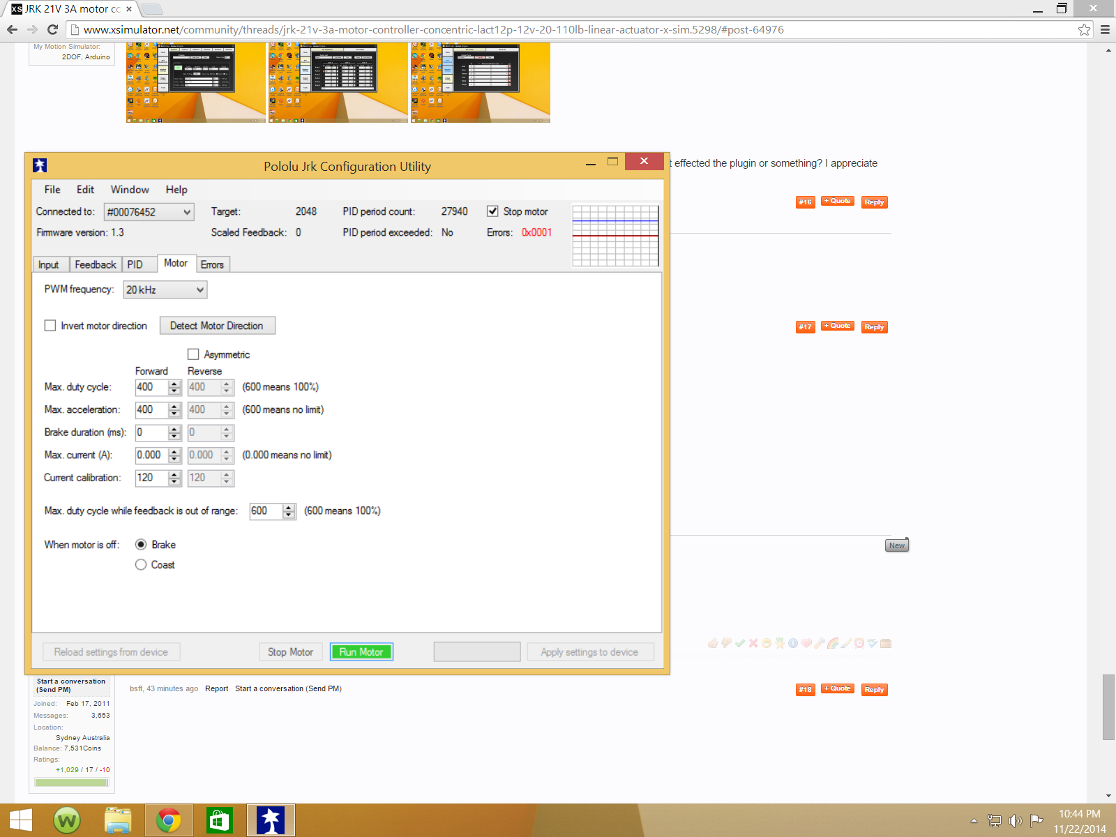

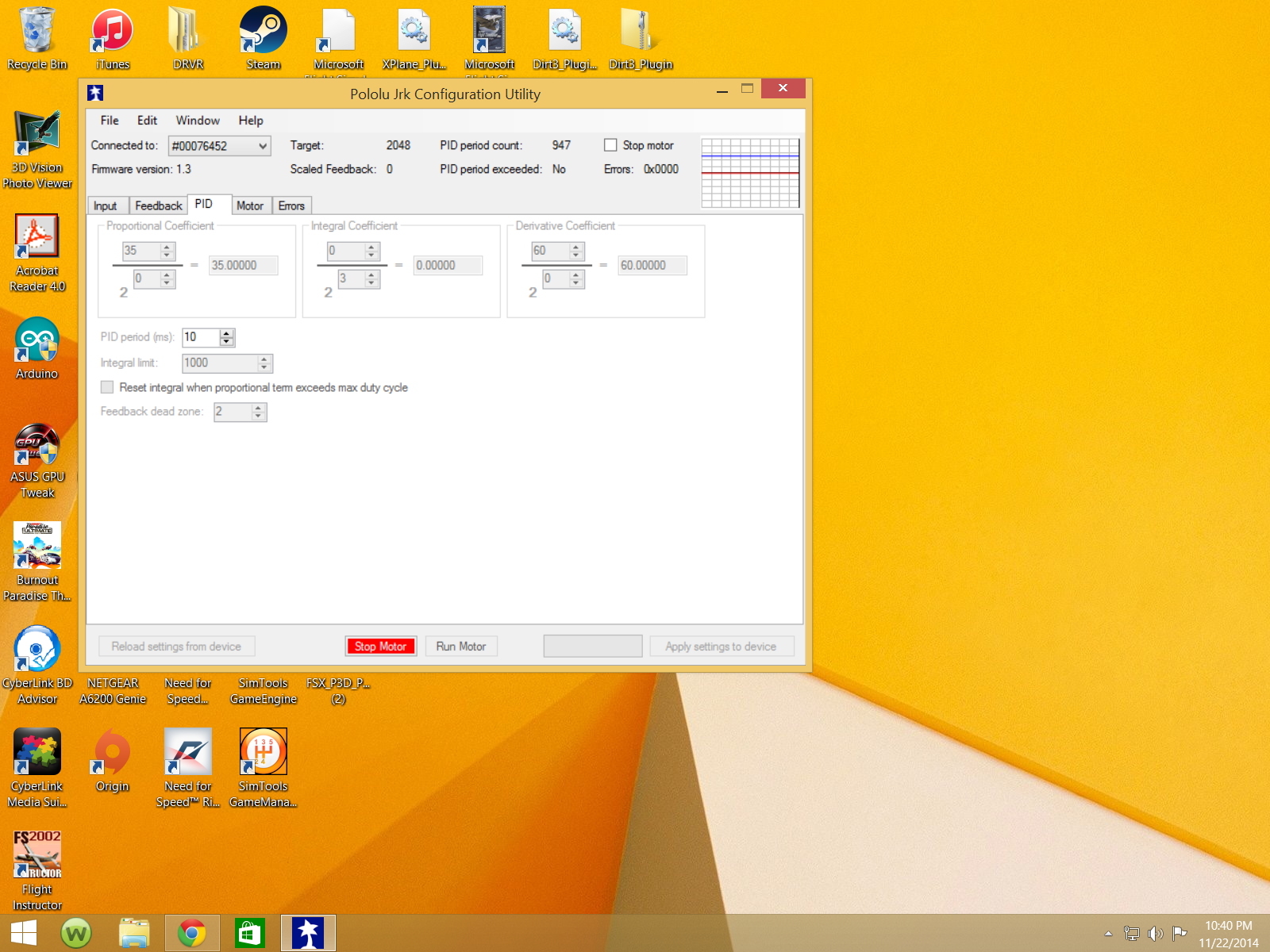

  18. bsft
    current calibration is WAY to low.
    wind it up to 120.
    Drop max accel and max duty to 400
    Can you post a pic of your PID tab please?
    EDIT, then work with numbers in tuning centre, do each force individually
  19. Deijan5
    Deijan5 New Member
    Feb 24, 2014
    18
    Las Vegas, Nevada, US
    567Coins
    2DOF, JRK
    I made the changes, however I'm not sure where the EDIT is at. thank you,
