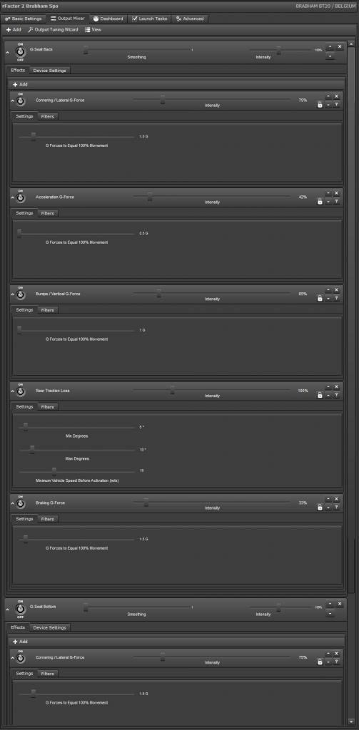

    Here is an example of one of my GS-4 profiles.

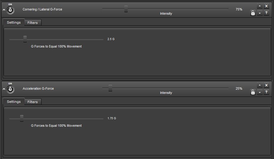

    So if we look at some individual effects we have the same thing as SimTools is doing but in a easier to understand format.
    The slider is exactly the same as the Min/Max settings in SimTools and the intensity is like our axis/profiles combined.
    So in this screenshot I am saying the I want my Sway to be at 75% intensity, this is like setting the sway to 75% in the axis in SimTools. Then I am saying that if you hit 2.5G in a corner then you will be using 100% of that 75%. It works a little differently but for arguments sake I will keep it simple. Now if I lower that G-Force slider then it will get to 100% quicker and more often so it will feel faster and more responsive but I will lose the detail in anything over what that slider is set to. The way to do it is to set the G-Force slider correctly then change the intensity so that way you are still feeling the whole range of the G-forces but you are changing how much those G-Forces move the rig.
    Now with Sim Commander it lets me save all these settings for as many profiles as you want to create. All you would need to do to get SimTools to do the same is to add a drop down menu to the Tuning Centre to let you pick what Min/Max values to use. You can already do this in the Axis and profiles. You just need to be able to do it in the tuning centre as well.
    I think being able to easily modify the Min/Max is very important.
