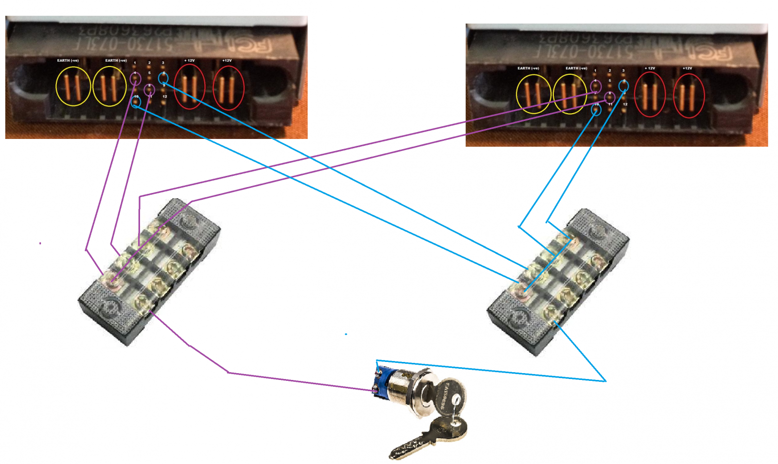

    I'm trying to modify 2 HP DPS600 to use with only one Switch. Can this schema works?
    I think yes, because I've connect together both 4&8 pin and 6&10 pin of 2 psu.
