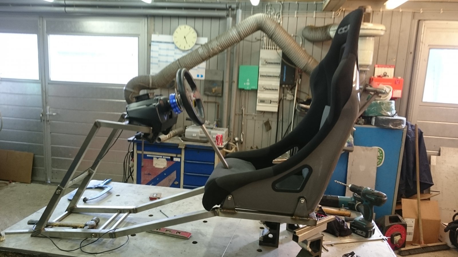

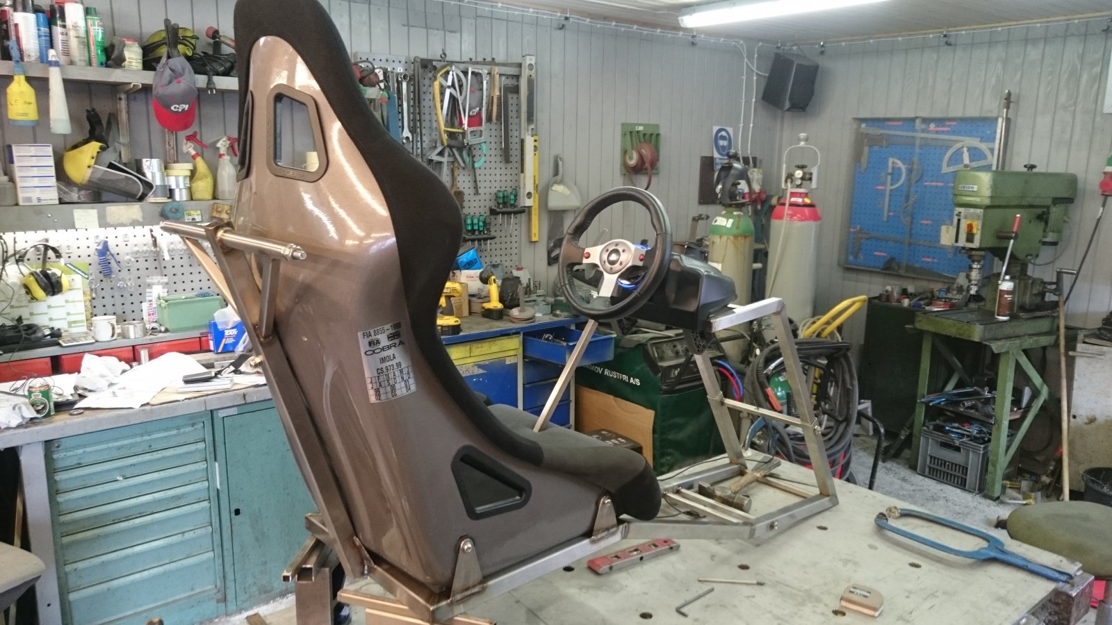

Hi there. So interesting forum you got here, that I had to do my own 2 DOF Full frame in stainless

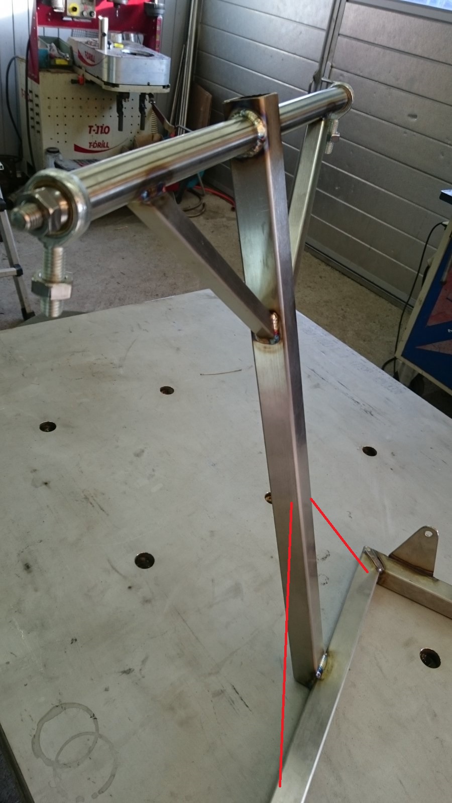

    Nice job on the welding, however, Id suggest some more steel to stiffen the back up

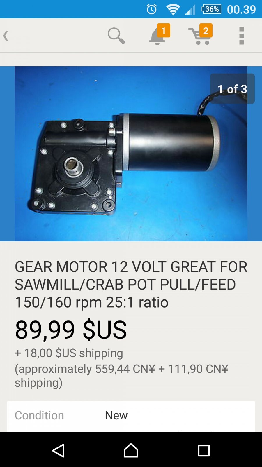

    Do anyone have any experience with these motors:

    Just for interest, are you using a TIG?

    Right you are!

    Oh,didn't no you had one, silly me!Well, I have ordered the one's with the 25:1 Ratio.

    I did what you said, not so big though, have to think about the weight! But as you maybe can see on the picture, I have also mounted a bolt and a rubber spacer further up on the back, into the seat.Now it's stiff!

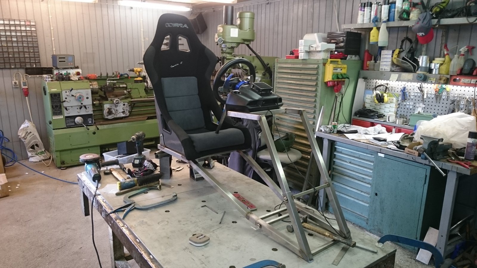

    A little progress!

    Motors ordered ,the crap pot one's from EBay with the 1:25 Ratio

    As you can see I choose to make it adjustable.

  17. bsft
    what are you making adjustable? for shorter drivers?

    Or longer,yes.I know I will move the 0-point, but it will only be for a little while, and I'm sure the motors can take it. I don't mind people trying my rig.But not too long, though!

  20. bsft
    Balance it for heavier driver, and make pedals and wheel adjustable. Keep the balance point in one place.
