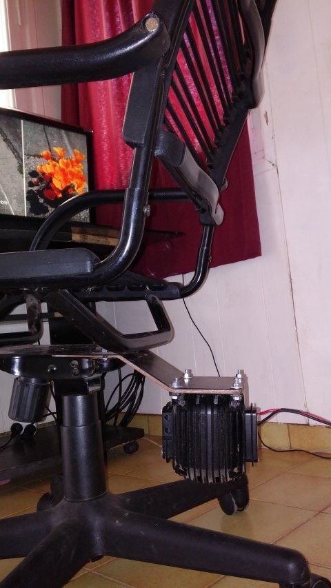

    So, after reading eaorobbie's talking about the benefits of the JRKs, I thought that's the board I need, the problem is that I can get only one now, and I will have to wait for a month or more to get another, so looks like the arduino+MM will be the way to go (if I find someone to do the electrical part for me locally)

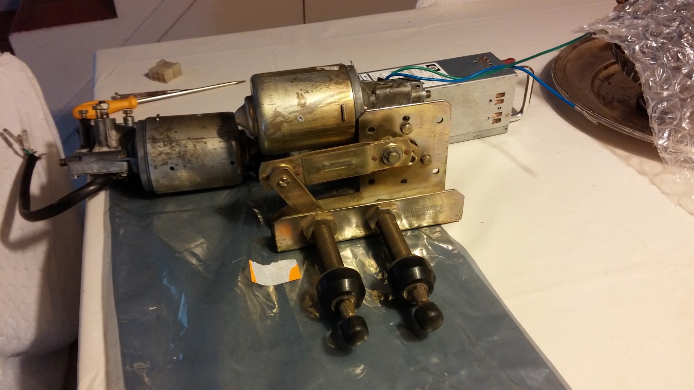

    I already got a pair of truck wiper motors that came with the holding mechanism as a great plus, and a pair of servers PSUs I modded for 12v 32amp each.
    Also this wiper motors are a lot faster going counterclockwise, 130rpm vs 85rpm clockwise.

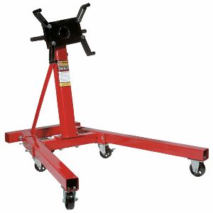

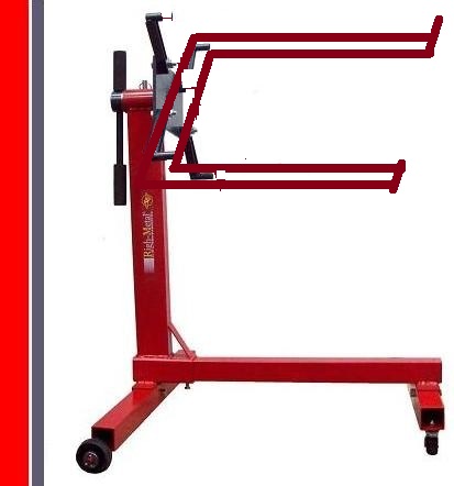

    Something I'm thinking about is to use a modified engine lifter, I can get one cheap that can hold about 1000 pounds.
    What do you guys think?
    Thanks anyway!
    PD: Excuse my English please :p
  2. bsft
    do you have a sketch of how you plan to use the old engine hoist?

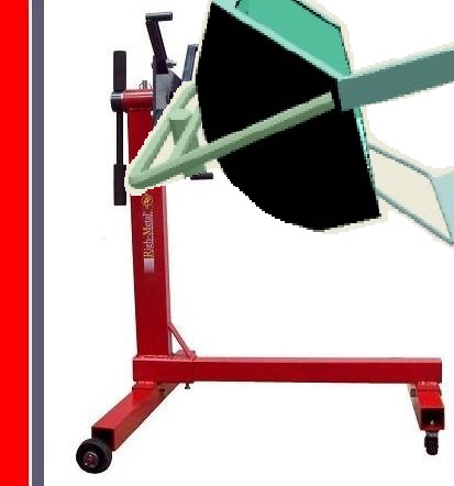

    Not yet, I'd got the idea yesterday :), but let me see...
    Something like that.

  5. bsft
    ok, something like that Id suggest DIY actuators with a long travel

    I think that is an awesome idea! It would cut out a lot of fabricating time, if possible put a bearing for the rotating mass. I have built some engines in my day, and when you get weight on it, it will turn hard and have premature ware. Possibly a wheel hub from a car would work. And by the way that's a engine stand not a hoist(cherry picker), sorry to be a stickler.

    or a steering knuckle with a hub, for pitch and roll. Sorry just thinking out loud.

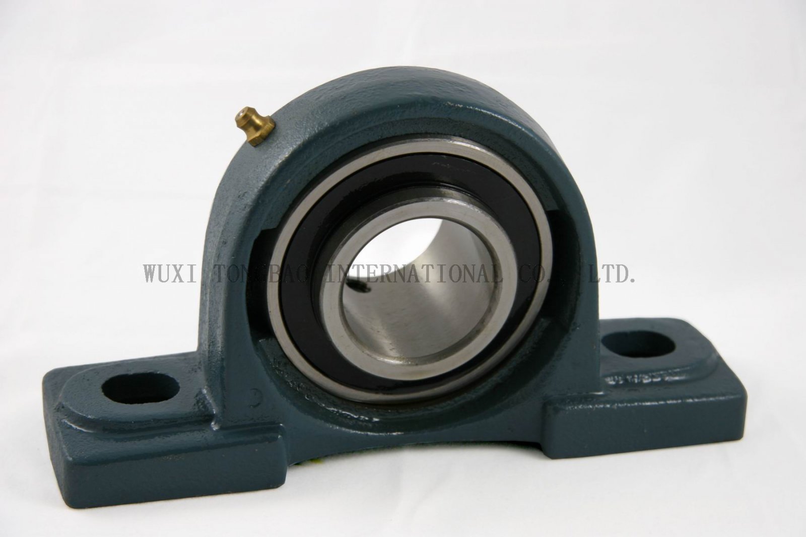

    Modding with a pillow block or spherical flange bearing (is that the name in English?)

    Yes thats the name, I have 4 here from my old joyrider I had in the beginning. Mind you m they are only 12mm shaft size.

    Then I will have to look for something bigger than that. Or just follow SeatTime advice, if my stubbornness allow me :p

    About the difference of shaft direction speed on my wipers, I think I'd read this in this forum, I copied the quote but not the name of the user:
    "It is normal that wiper motors turn faster in one direction than to the other. You should turn arround one motor, so that speeds are equal.
    Preferrably, the faster/stronger direction should point to forward/braking, while the slower direction should go backwards/accelleration
    This is fine for a 2dof, but I think it is not a fix for a rocknride kind of unit, so, is there any solution for a rocknride?

    Thanks! I saw that video long time ago, but going that way I will slow down the fastest side a lot, as the slow side doesn't get faster doing that trick in my wipers. Also found this, but I don't understand what is he talking about as I don't know what a "provision" is :p :
    There is another way but involves pulling the motor case apart. Inside you will find the motor brushes, usually spaced 180 degrees apart for a single speed motor. In my case a multi speed had them spaced one at 3 o'clock and the other at 6 o'clock. This gives you different speeds based on the phase shift induced by a change in polarity applied to the connected motor wires.
    In simple terms if your motor has provision to move one of the brushes as mine did it will give you the maximum speed you can in both directions.
    A word of warning though. That little black nipple on the end of the motor case is a self aligning bushing that can be hard to line up when reassembling, the magnetic field will try and pull the rotor off centre as you try and replace it. It can be done but requires a bit of patience.

    The reason a wiper motor goes faster one way than the other is because the worm gear on the wiper is designed to operate with the least resistance in one direction. The angle of the thread makes it easy to turn in one direction but has a higher friction in the other direction. You can see this yourself by taking the gearbox apart and you will see the worm gear tapers to a matching taper on the circular gear. If the circular gear had a straight cut gear it would be equal but it actually is cut on an angle, thus preferring motion in only one direction. Also you can see by connecting a current clamp on the motor. In the faster direction the motor will draw less current than in the slower direction. This is because the worm gear has resistance friction turning in the other direction. By twisting the body of the motor you are changing the magnets positions and de tuning it to run slower as you said.
    If the wiper is powerful enough to handle the de tune then it is something to think about doing. Or a better solution is to save your money and buy reversible motors.
    The other thing is, how do the motors behave under load? They may spin at different speeds without load but you may find that under load the difference may not be as noticeable once you are actually using it. That's just wishful thinking on my end but I've seen many wiper motor seat movers and I haven't read any complaints about this problem.

    Yes, I tried checking amps with a clamp, and yes, the faster way was 1.5amp and the slower 2.5amp, also tried twisting the body with no luck, but I hope they get equal or near under load, if i make a seat mover it wont be a problem, we will see.

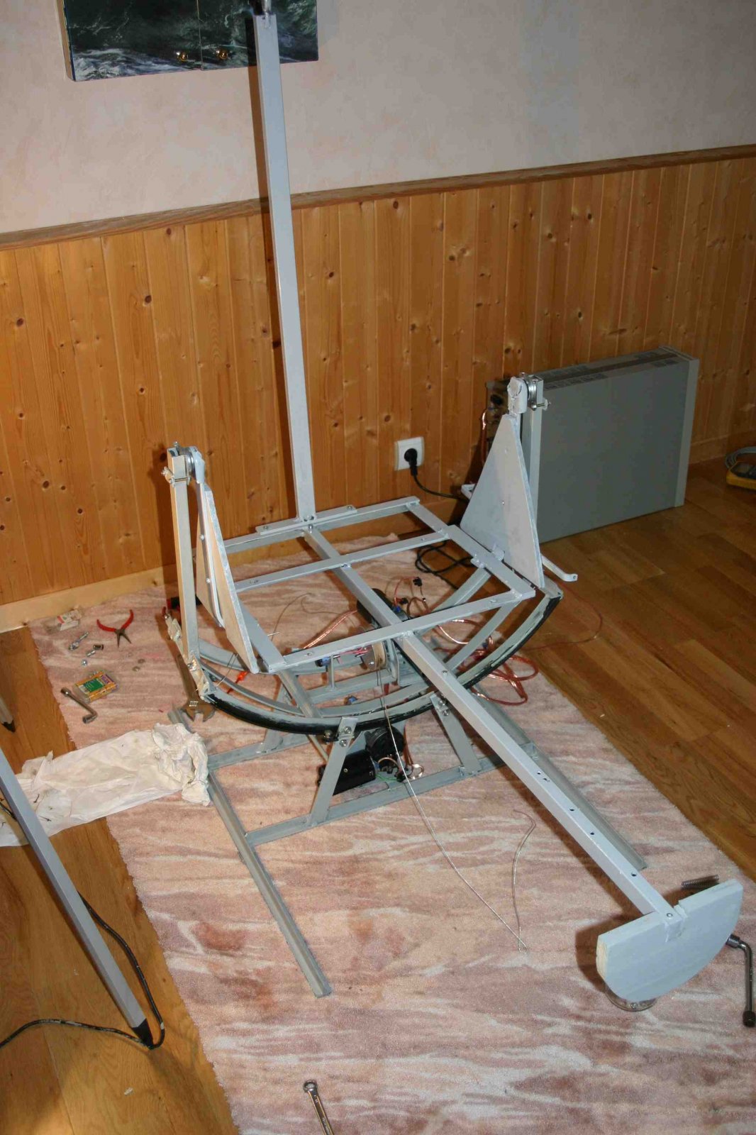

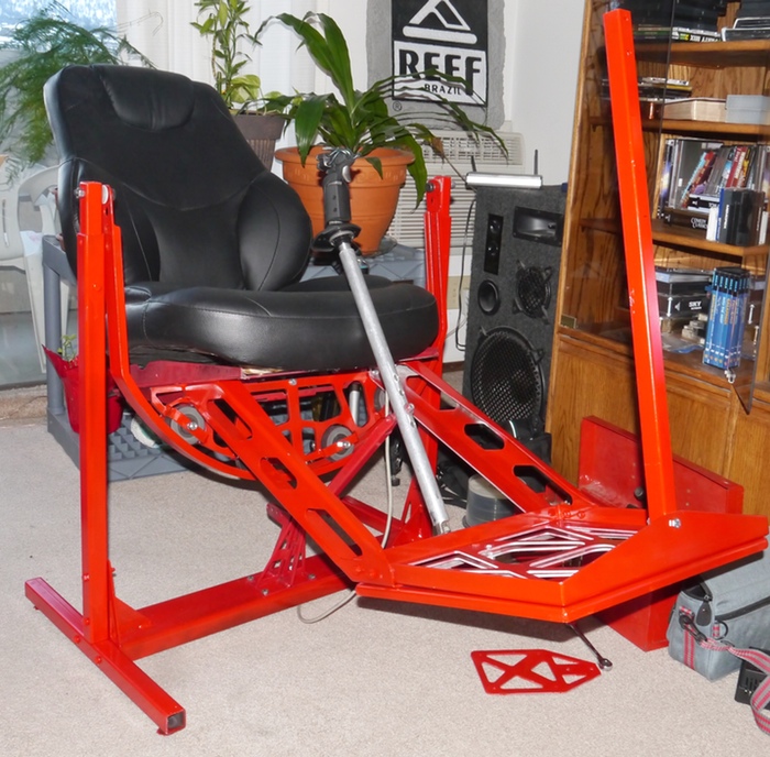

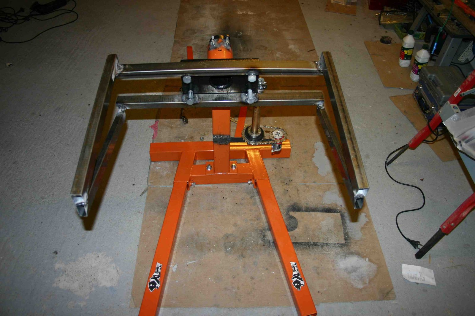

    Well, looks like the idea of the modified engine lifter, wasn't new at all, I found @OscarH already did it 6 years ago :p but I can't find if it worked fine or not :(
    Also, kind of funny to see the @OscarH also did his first 2dof with some principles of the cloud flyer phoenix (tornadoblu5 like sim).

    Hi Guys,
    I recently sold the Tornadoblue like simulator (250€ !) as it had not been used for a while (at least 2 years).
    When I started with rev B, i.e. the engine lifter, I decided to buy a CNC machine to do bits and pieces. The CNC machine brought so many new ideas to my mind, I'm now using more the CNC than the simulator...
    I made some modification to the engine lifter. I need to remove dust before taking some pictures. The principle worked well, even if there are still things to do to have it completed. I replaced wipers motor by 2 mechanical cylinder bought at surplus.
    I'll try to make picture this week, latest this week-end for you to see.
    Cheers.
    OscarH
