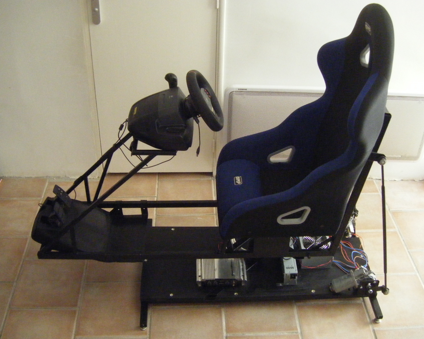

    The concept:
    A dynamic simulator which integrates the driver, the seat, pedals and steering wheel (but not the screens !)
    The two axes (2DOF: Two Degrees of Freedom) are : roll and pitch (roulis and tangage).
    The principle is inspired by the commercial model from Frex http://www.frex.com/gp/motion/motionpage1.html
    but with gearmotors (wiper motor + rod) replacing the electric linear actuators.
    A glogal overview of the electrical stuff:

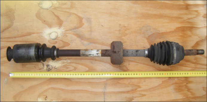

    Structure in rectangular steel tube:
    - the frame
    the frame rests on the ground and supports the movable platform via a motor drive shaft (U joint).
    - the moving part: the cockpit
    - A true racing bucket seat (tubular). The fiber seats are lighter but more expensive.
    - A harness! important to feel the seat movements and for realism of immersion
    - Force Feedback steering wheel and pedals

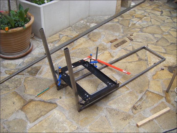

    The step-by-step pictures:
    Structure
    It was very convenient to have the bucket seat's mounting plate: I drilled the structure easily!
    Power Drill and a conical tool to adjust the hole to good diameter
    Take care to ensure the shaft 's squareness : it has to be vertical !
    http://gamoovernet.pixhotel.fr/pics_gam ... sis-3-.JPG
    Then I crossed the bars at 45 ° to triangulate my frame :
    The gimbal (U joint) is blocked in rotation along the yaw axis.

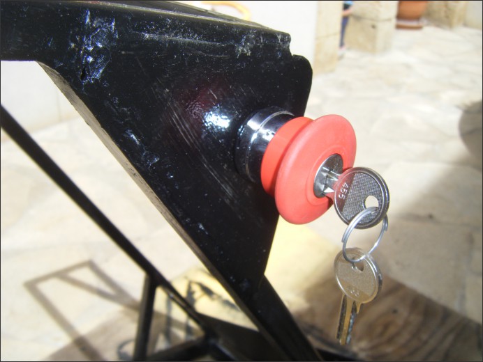

    a plate on the side of the wheel holder:
    and here is a starter / emergency stop key §

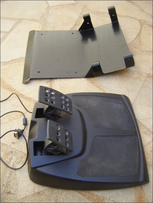

    The pedal support
    the right bracket must be folded down!
    Dirlling of the pedals and support plate at the same time
    Two-components glue bonding and 4 screws M5x16
    take the opportunity to remove the unnecessary ballast which adds to the inertia of the system :)

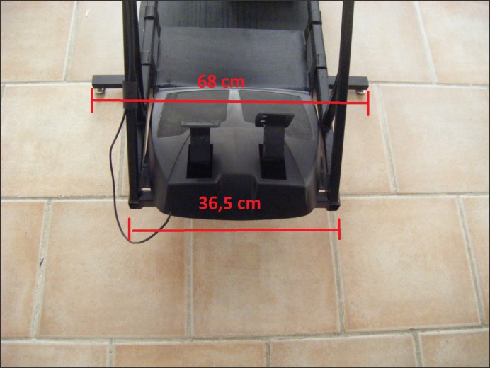

    Width of the frame, I aimed a compact size to begin with
    Edit: The first tests have shown that ... it was not wide enough!
    then I added + 11 cm on each side (it must go through the door ^ -) for a total of 68 cm
    The Center of Gravity cdg
    I determined it with precision with an assistant:
    on a tubular steel rod, roll frame until you find the balance
    with the driver in it!
    (the rod has to be perpendicular to the plateform !)

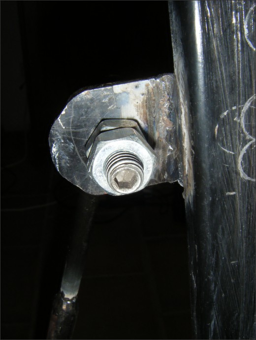

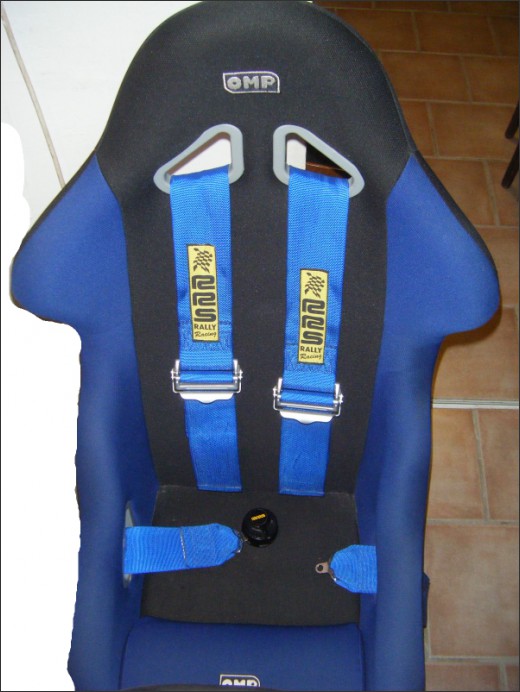

    The 4-point harness
    In fact, it is a 6 points but it's too much ! and not comfortable : 4 is fine.
    welding a small bolt
    the clip can be mounted and removed
    side view:
    Overview:
    conclusion: the harness is great!
    - For the look :cool:
    - For immersion: it feels like being in a rally car!
    - For sensations: I think we fight less against movements playseat, it is more inclusive
    but it requires a keyboard support!

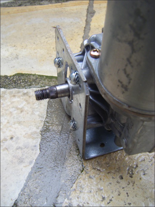

    So, the actuators are advantageously replaced by wiper motors and a system of rods (just 10 times less expensive).
    Wiper motors
    Edit : finally, this bracket is too short : I couldn't mount the 2 motors symmetrically .
    If you can, make a DIY bracket with custom height.
    Mounting with 3 screws M6 x 16 and washers

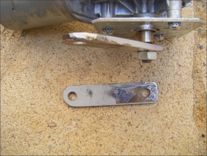

    A steering rod (15 €):
    A connecting rod:
    - Center distance 65 mm (finally)
    - 5 mm thick
    With a file, try to file a 18° cone down : it has to go well on the motor shaft.
    Tighten hard !

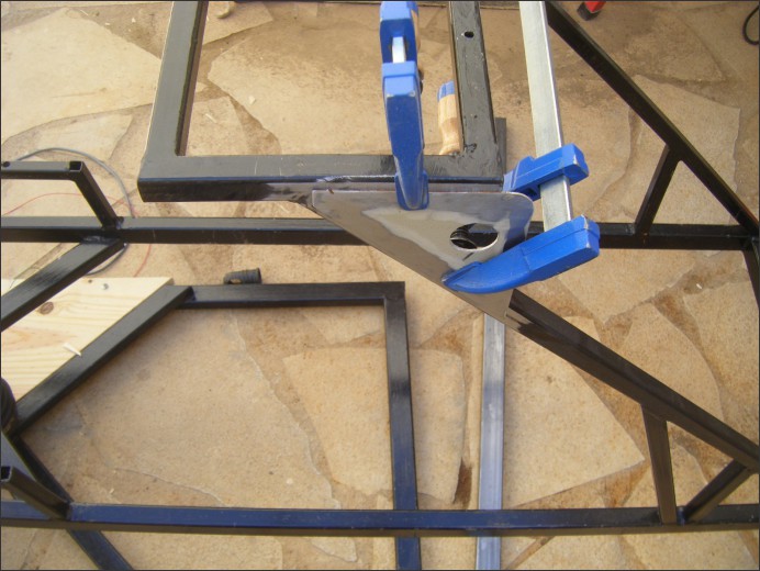

    I checked the alignment of the motors with the platform (= I conterbalanced a small angular error during the welding of the platform)
    Edit: the engine brackets are not stiff enough! they move under the constraints.
    solution :
    and I checked the rod could rotate freely at 360°
    do not hesitate to do the same (one full turn may arrive more quickly than you think :)

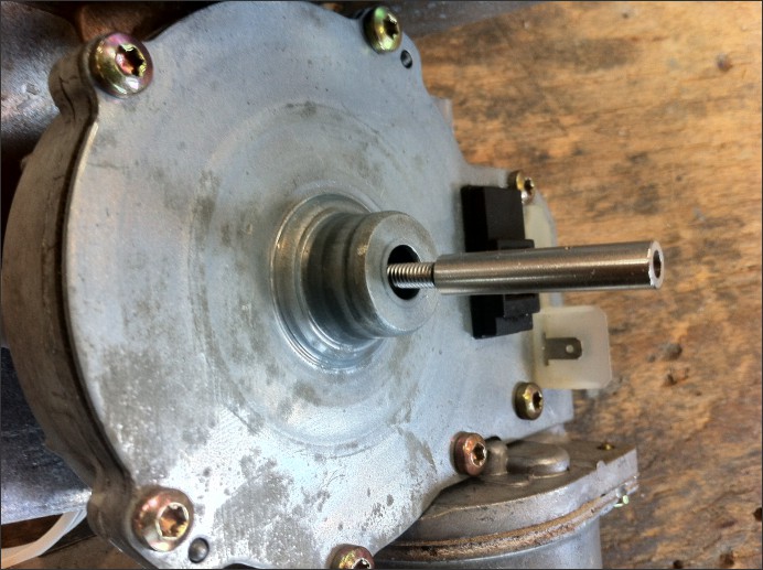

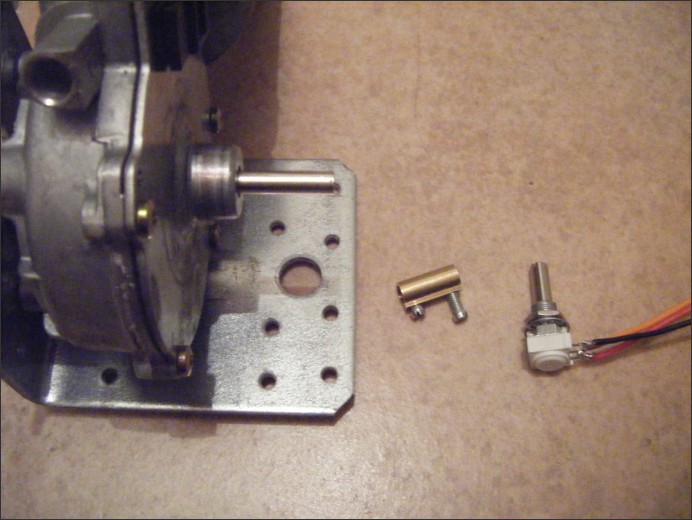

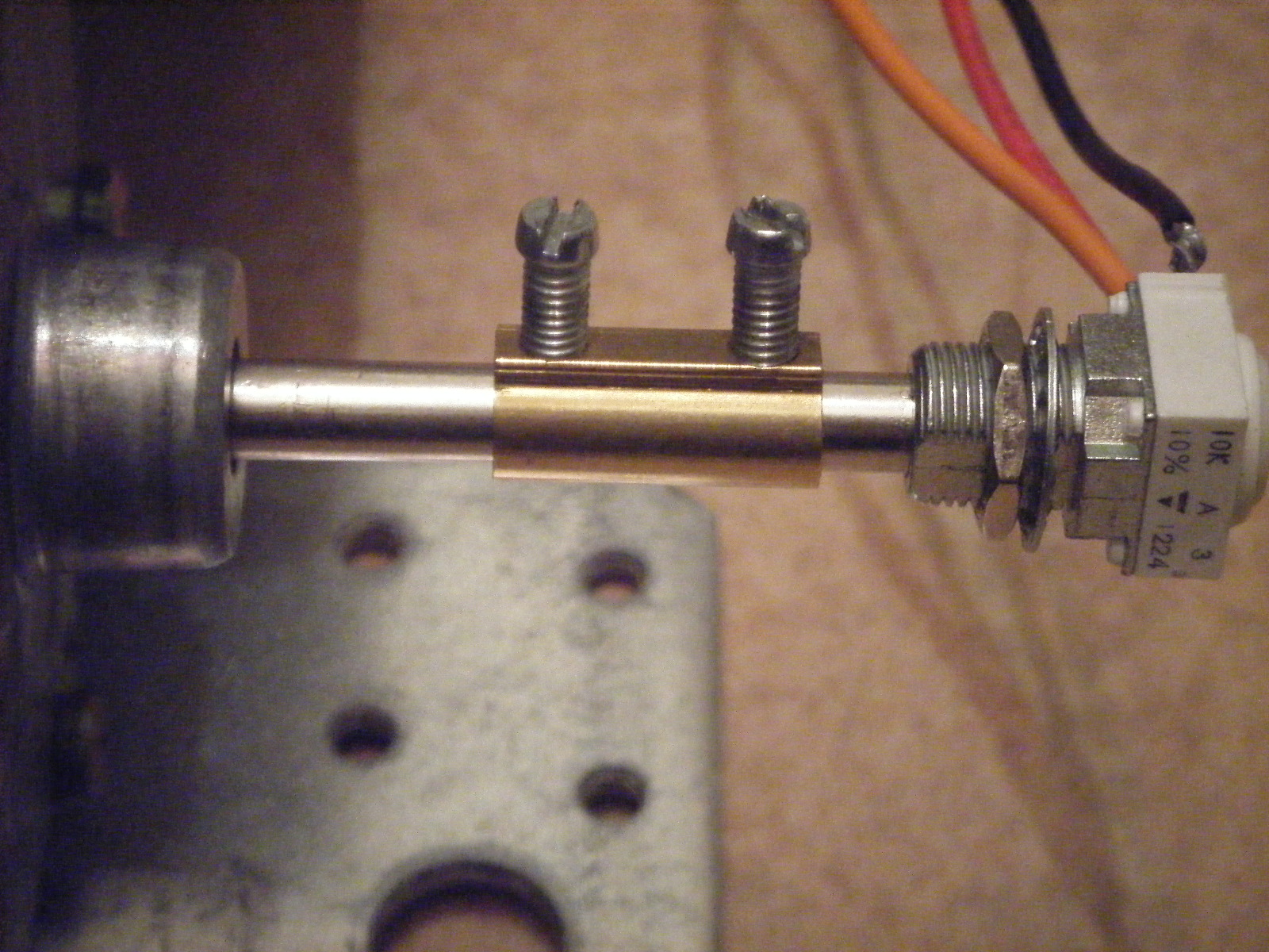

    Mounting potentiometers

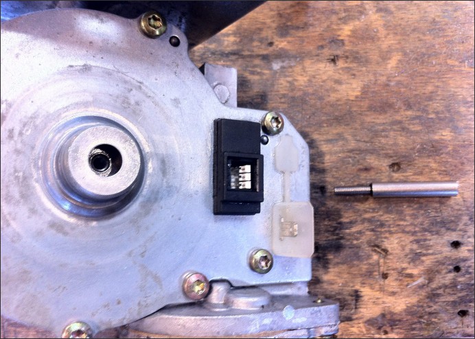

    wiper motor's preparation = fixing the pot at the back of the engine
    1 / tapping of the smooth hole of the engine
    2 / a M4 threaded rod
    3/ a 6mm diameter (like pot) spacer and M4 tapped
    assembled with loctite:
    then the parts for making a rotational connection adjustable to adjust the potentiometer
    (The brass piece is ... a 380V connecting block course!)
    This solution is rather excellent!
    it is tight enough to but if it goes too far: the pot is not damaged, it slips.
    Overview!

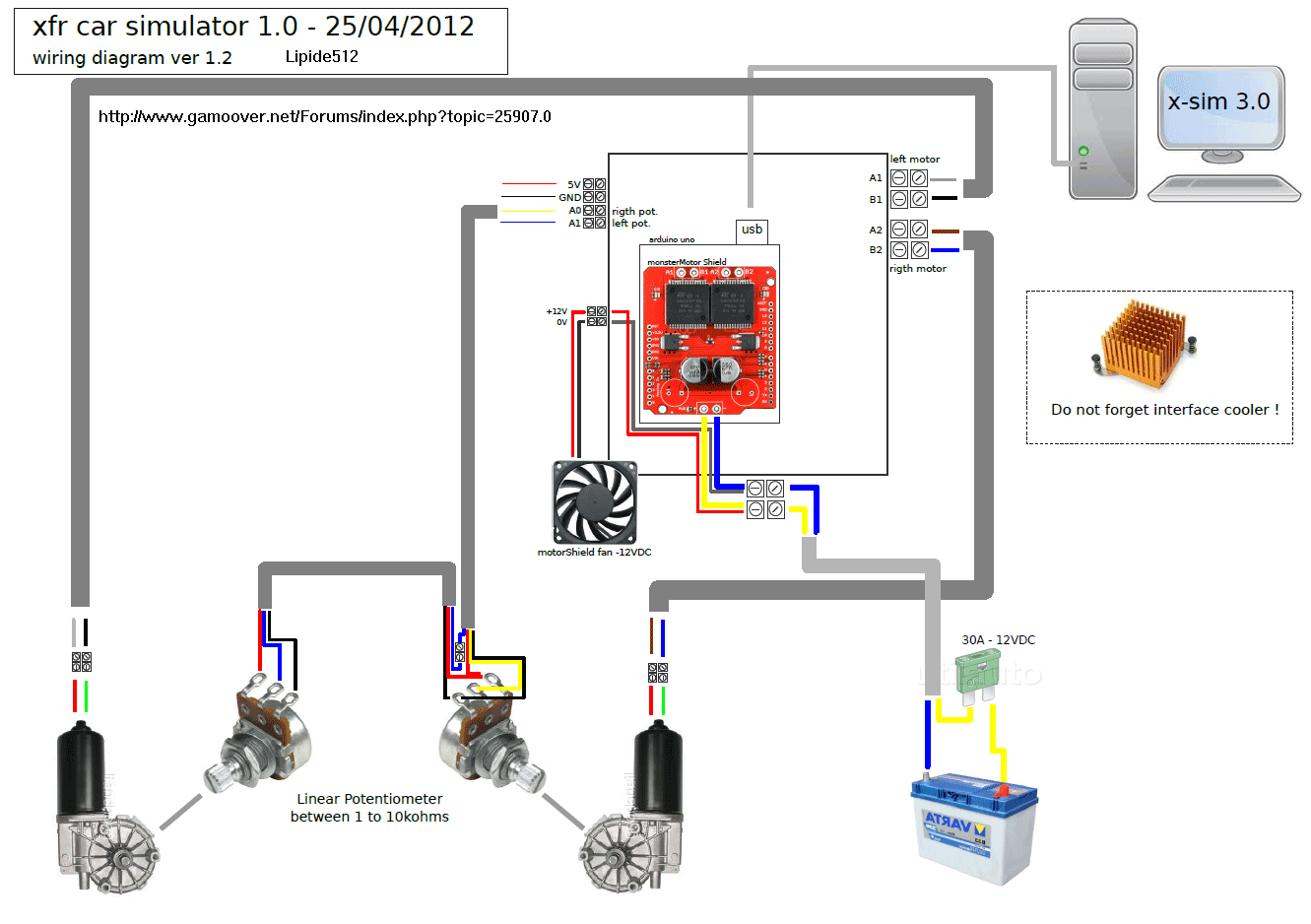

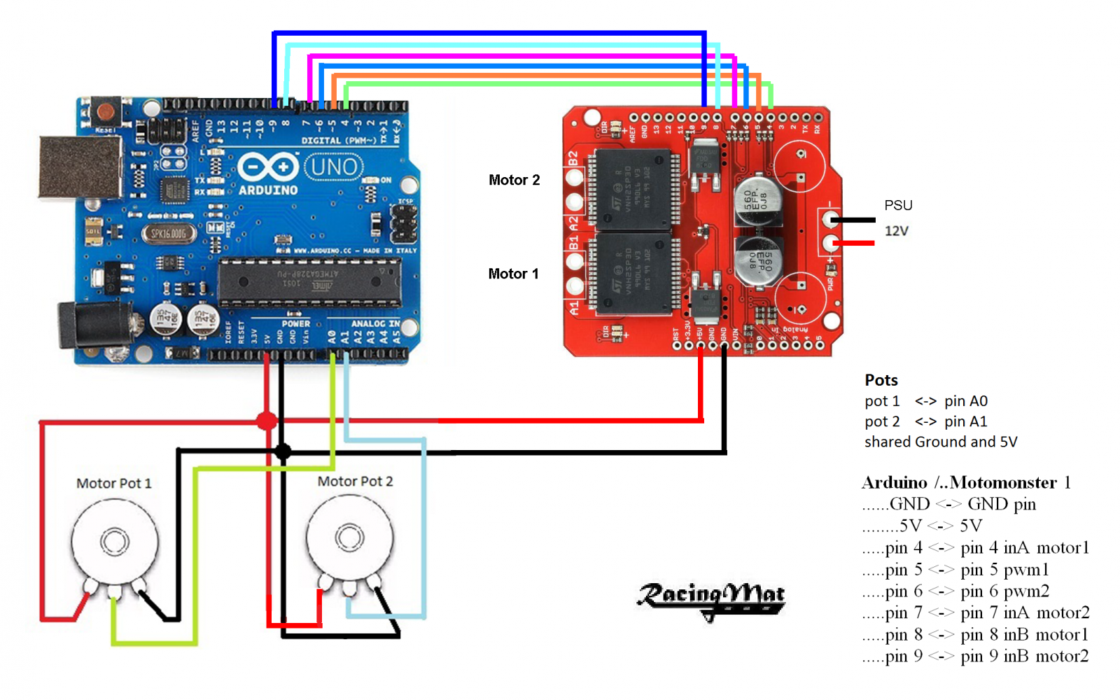

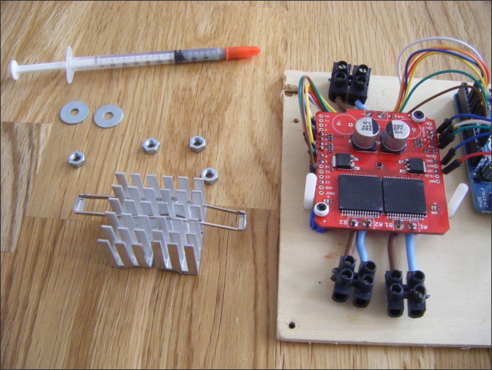

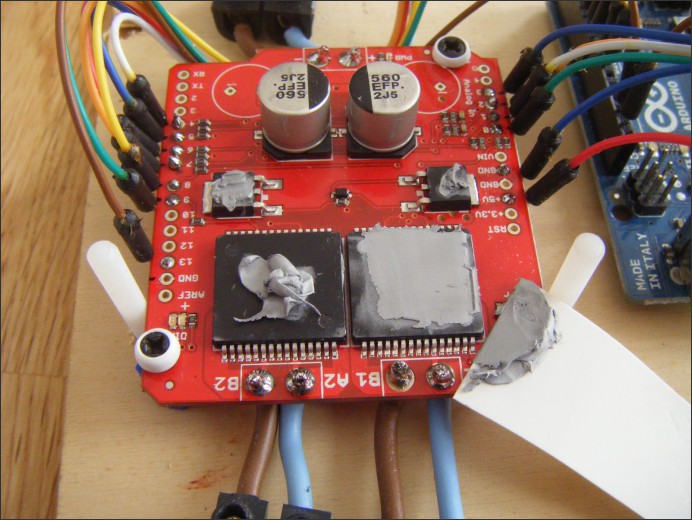

    Cards: Arduino and MotoMonster:
    here, the wiring diagram drawn by Lipide512
    9640
    I choose not to stack the two cards although it is expected to:
    - I wanted to keep me a chance to reallocate the outputs of the Arduino
    - I wanted better cooling system (so I raised the motomonster)
    Arduino /..Motomonster
    ......GND <-> GND pin
    ........5V <-> 5V
    .....pin 4 <-> pin 4
    .....pin 5 <-> pin 5
    .....pin 6 <-> pin 6
    .....pin 7 <-> pin 7
    .....pin 8 <-> pin 8
    .....pin 9 <-> pin 9
    pin 13 is not needed

    Heat sinker had to be cut in half in order to have a good contact with the 2 chips (uneven)
    go for the thermal paste
    spreading the paste:

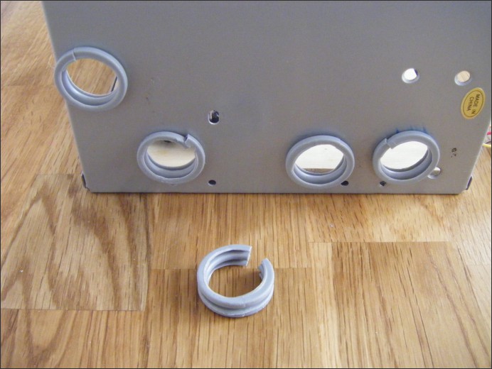

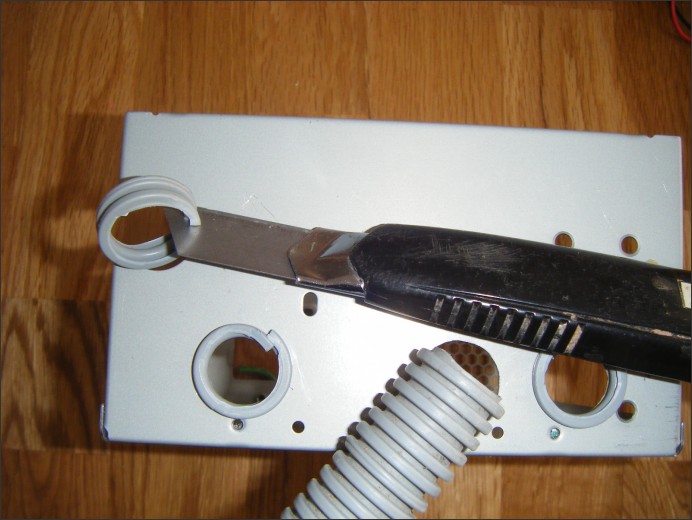

    Protection for cables :
    -> electrical conduit
    -> A notch
    -> And insert in the hole!
    the cover of the electronic cards with his fan
    a grid that prevents the wires to be worn against the blades.

    Items to buy
    - motors 12N.m 24V irreversible
    cost 2x35€ + 16€ shipping
    SWF VALEO NIDEC ITT 404.458 motoréducteur 24V DC http://www.smolka-berlin.de/onlines...cteur_24V_DC__Offre_sp%E9ciale%21%21%21_/4398
    beware to choose irreversible gearmotors...
    - Arduino board : 25€ + shipping http://store.arduino.cc/eu/index.php
    - MotoMonster board (16V max) :
    70€ @ Sparkfun https://www.sparkfun.com/products/10182
    27$ @ DX http://dx.com/p/monster-moto-shield-for-arduino-red-161274
    - server PSU 12V 47A (575W) DSP600 : 35€ on eBay
    - 2x potentiometers : 2x7€ + shipping
    you can buy any cermet potentiometer : cermet means Ceramic Metal.
    It guarantees you that it's the strongest design compared to plastic-carbon low cost pot.
    - cermet
    - linear (not logarithmic)
    - 10 kOhm
    The Anolog Digital Converter behind the analog pins of the Arduino is optimized for 10Kohm pots
    I bought mine at http://www.gotronic.fr/art-potentiometr ... -11293.htm
    you can find here many other electronic distributors : http://codelab.fr/177
    Weight
    + my plateform structure weight 8,6 kg
    tube 30x20x1,5 (1,1 kg/m) 5,4m : 5,9 kg
    tube 16x16x1,5 (0,7 kg/m) 4,1m : 2,7 kg
    + rally tube seat : 9 kg
    + rally harness : 1 kg
    + logitech MOMO wheel and pedals : 4,5 kg
    + buttkicker 1 kg
    subtotal : 25 kg
    + driver !
    grand total : 100 kg which is heavy and has great inertia in mouvements !
    -> so keep in mind to build light
    Electrical power consumption
    I measured the power with this wattmeter : [album]1961[/album]
    PC Games : 80 to 100W
    Dolby 5.1 : 15W
    Power supply PSU : in IA mode rfactor which sakes a lot ! between 170W and 220W (depending on the parameters in Arduino code : max speed and amplitude)
    the PSU efficientcy is 81%, hence it gives 180W to the motors.
    -> 90W per motor -> 7,5 A in 12V DC

    well.. im making a copy of yours, not exatly the same, im making it bigger and with 3 monitor on it.. but the idea is the same
    but im having a problem..
    u know the motor are behind connected to the chassis... the problem is one side of the motor i can rotate with my hands, as to the other side i cant,,,,,, both motors a like that (wipers motors) so.... if i left it alone the chassis drops down because the motors cant hold the chassis in center so it rotates. and the front of the chassis goes down...
    how can i solve that? only for one side i can rotate with hands.. but the other side i cant rotate with hands... im gonna try to fix it tomorrow
    i hope u can help me thanks
  16. bsft
    if you are running wiper motors, they are stiff to turn by hand. even the same brand and type. even with the big worm gear motors, they have no holding when power is turned off. So even if you stay with wipers, you need to expect some slack in motors when power is turned off.
    Ive had wipers in the past that were either easy to turn by hand or impossible to turn by hand with power off.
    • Old Old x 1
  17. RacingMat
    2,233
    21,063Coins
    +2,092 / 21 / -2
    @trust928: in fact, gearmotors can be irreversible or not. It depends on gear ratio (and angle of teeth in the gears).
    If they are irreversible, it's better because you don't need to have a break to block the motor when power is cut.
    As bsft said, some does and some doesn't... The motor reference I gave in my post, is irreversible...
    Maybe you can shorten the lever length to reduce the force applyied... until it appears as irreversible.
