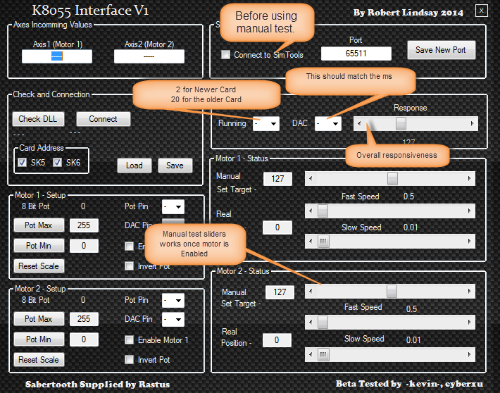

    Hi billo2404,
    The Problem I had was that when I connect to simtool. my motors starts to turn slowly in one direction and I have no control of them and its started to jitter. As soon as I uncheck the connect to simtool box, i managed to stop it and drag the slider bar to move them back in neutral position. I find that my K8055 interface isn't communicate with simtool game engine.
    When it is not connected to simtool, I can manually move my motors to max & min by sliding the bar. And Also I tried output testing them, It isn't responding.
    I tried changing the port to different value to 4123 or 9600, its started to jitter when I check connect to simtool box.
    My FS9 game is running and I can see the values are changing in tuning center. That tells me it extracting the DOF values from the game. I don't know Where has gone wrong?

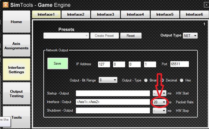

    Hi cyberxu ,
    Did you have tried change "packet rate" values ? Try change it from 10 ms to 20 ms or more . Actually it have to work without problem with 20 ms .

  5. eaorobbie
    20,400Coins
    +1,683 / 23 / -2
    Before even testing in Simtools you need to be able to comfortably run them in App as able to move them without them freaking out.
    Set the timing right first then make sure the pots are right then set a Fast and Slow speed and enable motor and test with Manual Slider, while testing you can adjust the fast and slow speeds to make it better plus also if the motor seem to lag as in not move will with the slider increase the response slider.
    Once motors are moving well you can then connect to simtools and test their and enjoy a game or two.
    Once you have all the setting right , press save and next time it reloads all your settings should be good to go.
    Hope that helps.

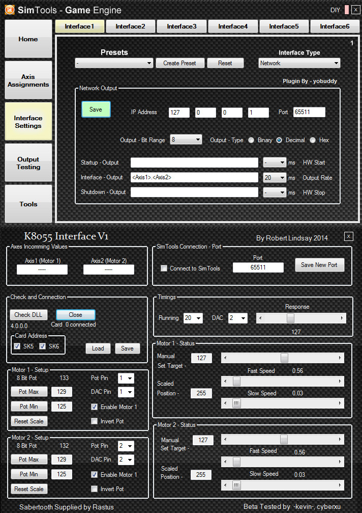

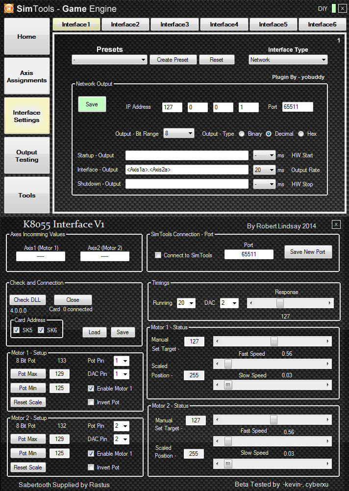

    Hi robcoll, did you ever get simtools to work with your k8055 board? I am having problems trying to get the k8055 interface v1 to connect with simtools. I have the same set up as you (a diy 2dof simulator with the k8055 & sabertooth). I think my problem is with the interface settings in simtools game engine, i'm not sure if i've set it up correctly. If you are up & running you could really help me out. Thanks.

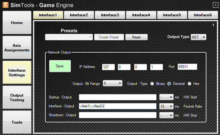

    SimTools 2.0 Input Settings - The difference from SimTools 1.3 to SimTools 2.0 in setup is that instead of axis defined like this <Axis1> it is now like this to designate grouping for a or b <Axis1a>

  20. koko17
    koko17 New Member
    Aug 28, 2016
    England
    28Coins
    2DOF, DC motor
    Hi Noorbeast, thanks for your answer. Here is an image of the changes i have made to the interface settings, not sure if i have done it correctly. K8055 interface V1 still will not connect to Simtools 2.1. I have spent hours over the last 3 days trying to work this out. I know some sim racers have managed to get the K8055 interface V1 to connect to Simtools, i just wish i knew how they did it.........
