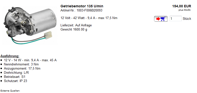

    In terms of performance alternatives some motor options you may want to consider are:
    @mariano68's modified electric jack motors:
    http://www.xsimulator.net/community/threads/2dof-foot-mount-sim-powered-by-12v-electric-jacks.7601/
    Using powerful DC winch motors: http://www.xsimulator.net/community/faq/dc-winch-motors-for-motion-simulators.151/
    Clarify the specs on these, as the web page states 8nm but the spec sheet says 20-30nm. The RPM is a bit low but if the torque is adequate you can run a bit longer levers on a shoulder mount design. 24V complicates things a little with PSU and control boards but plenty of people use it: http://www.smolka-berlin.de/onlines...C__ITT_404.448_Motor,_Getriebemotor_24_V/4397

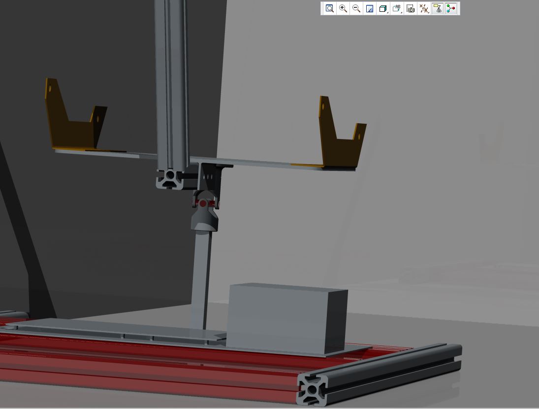

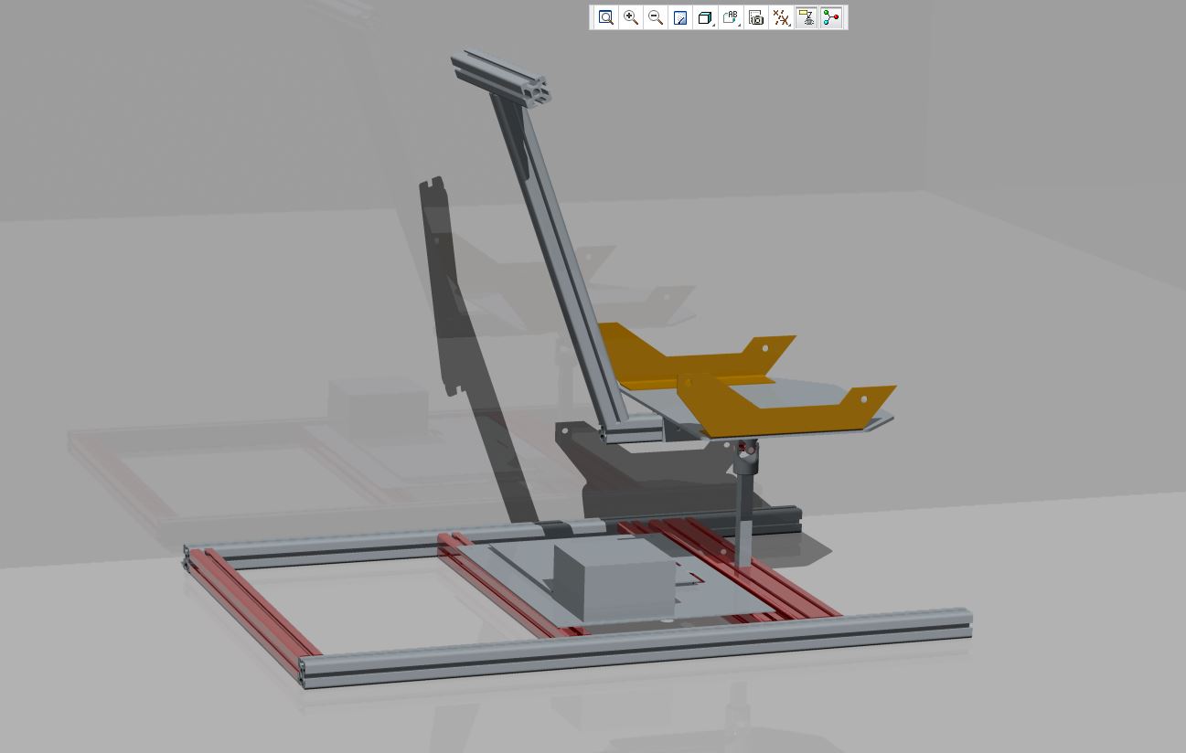

    Hi guys!
    So here is an update on the Seat-assembly!
    I moved the the u-joint as close as possible to the seat. Furthermore, I designed custom seat brackets (cheaper) and the mounting of the profile to the seat base.
    So it's coming along nicely.
    21,665
    151,644Coins
    +11,044 / 56 / -2
    Nice job with the renders.
    Have you got the problem of a supplier for motors sorted yet?

    What do you think
    about these guys:

    @bsft @noorbeast
    Oh, I seem to have overlooked these!
    They are definitely easy to get even here :p
    I instantly found a similar jack motor here.
    So they have a way more torque, but are slower it seems...
    There are a lot of these around....
    The problem is, that they don't really offer any description about the motor itself.
    Just:
    12V, 2t liftingability
    that's not really detailed :p
    Furthermore, am i still able to control these via JRKS?

    The specs for almost all the 2ton models:
    12v
    max 15amp
    about 50rpm
    And strong enough
    And it is just another motor, so you can control them with arduino and MM or JRKs
