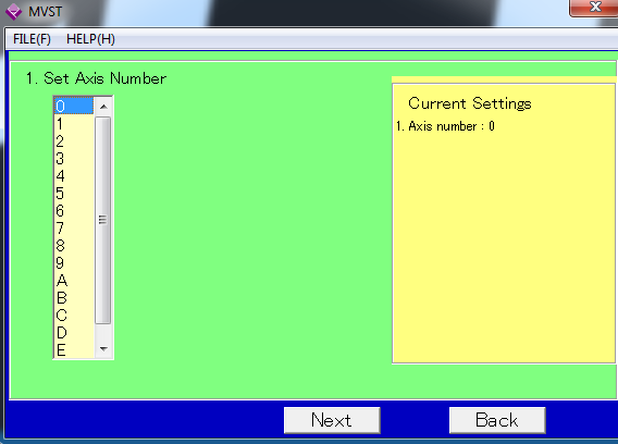

    I'm still not getting any motion from my SCN5's. They are connected to COM5 and COM6.
    If I exit software, and open up X-Sim Profiler, they work normally (under those specific COM ports)... and if I leave SimTools engine open when I launch X-Sim Profiler, it fails to find the actuators - so SimTools is definitely connecting to them when it opens.
    Any thoughts where I should try looking first?

    Did You set the id from both actuators to 0 instead of 0 and 1

    Using the MSVT Servo Configurator? They are both set to 0

    The easiest way to adjust the ID is to use x-sim.
    In the x-sim software you can find this
    Under change id you can change your ID :grin do this or check both actuators.
    Ohh uhhh its not the red circle .... but on the right beneath that.

    I have tried with both set at 0 and also different set at 0,1... no difference.
    now i'm wondering if its just a difference with the controller/adapter that I need to sort out

    Do you have no motion at all ? or maybe just one
    Do you have you're actuators hooked to one controller ? (simtools require two rd485 to usb controllers)

    No motion
    okay. both ID's set back to 0
    2 controllers (COM5, COM6).
    Perhaps instead I can make SimTools talk to them by configuring the output type SER instead of SCN?

    Did you Patched the game ? with game manager ?
