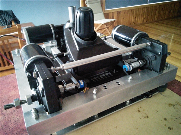

    I had discussions a couple of weeks ago with Motion Dynamics about excessive play in one of the 60:1 gearboxes. They thought the issue was the motor to gearbox coupling, so I ordered 2 more prior to pulling the sim apart.
    It turns out that the issue is keyway play on the shaft side slot of the keyway, with the key looking to be firm in the brass gear. I have advised Motion Dynamics accordingly and they will review this video and query the manufacturer.

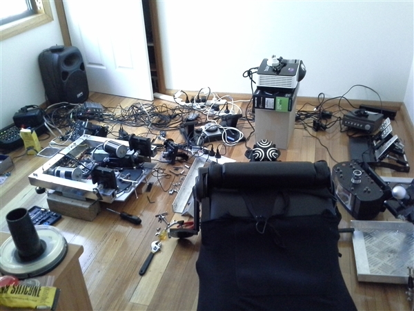

    My whole sim room is currently in a state of utter chaos during the updates I am doing.
    The 60:1 gearbox with excessive keyway play has been shipped backed to Motion Dynamics today, for them to review.
    I am temporarily refitting the 25:1 gearboxes, as Motion Dynamics is not yet certain on a timeline to review the 60:1. To their credit Shane from Motion Dynamics has said he is willing to pull the shaft out of another box if needs be.
    I have ordered a new JRK to replace the one I damaged, plus a spare, and they should arrive either tomorrow or early next week.

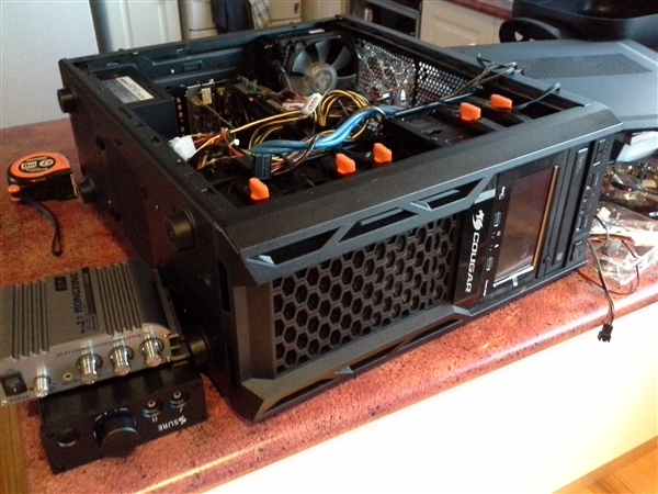

    The computer that runs my sim is also getting some attention. I am adding additional fans to the case and a touchscreen 5 fan controller. The temperature controller will be used to monitor the computer, and the simulator JRKs and Arduino. I am currently mocking up a PC 'dock', the main function of which is to tidy up cable and power management as well as enclose a number of audio amps and powerboards.

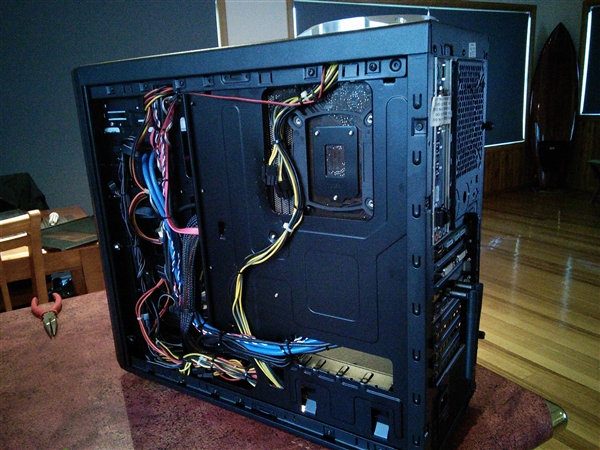

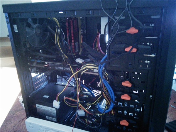

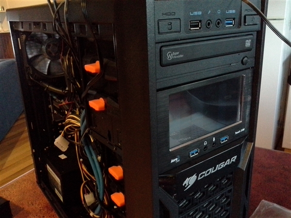

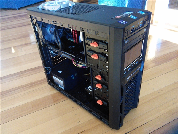

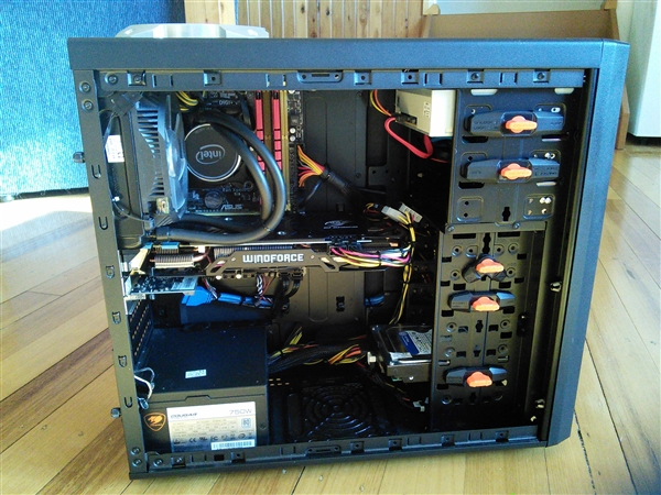

    A before and after of cable management, with the new digital touchscreen fan controller fitted and additional 120mm programmable fan, with billet cover to match the simulator.
    The computer specs are an i7-4770 Haswell Quad-Core 3.4GHz with 16GB Dual Channel RAM 1600MHz with Heatsink and Fins, overclocked Nvidia GTX970 Graphics Card, 250gb SSD, 2Tb 7500 HDD, Intel Liquid Cooling, 750W PSU, Microsoft Windows 8.1 PRO 64 Bit.
    I will eventually do the outside in carbon fiber wrap, once the custom computer dock for the simulator has been built.

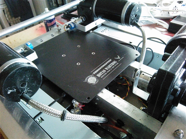

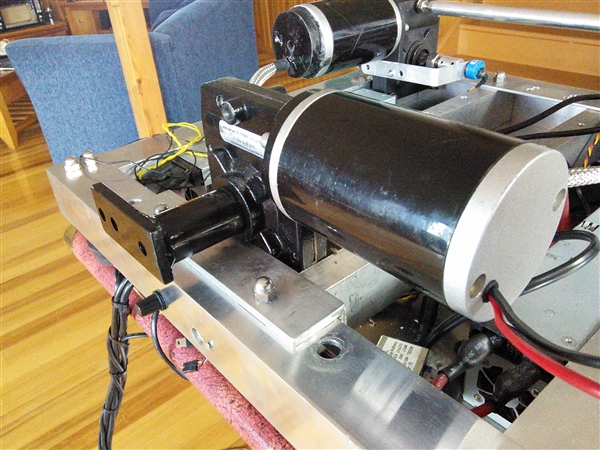

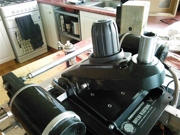

    The issue with the 60:1 gearboxes compressing the brass gears prompted me to implement something I had planned to do someday, but not during this update, and that is to add heave.
    I am using the tilt mechanism from the original DX Racer chair, as it allows me to have an adjustable setting for the user weight and chair. That way it takes very little to move for heave, as the adjustable sprung loaded pivot is taking the user and seat weight. And yes I have recycled the original Warthog base plate for the mount. The third engine is now mounted using 6mm aluminum angle, carefully slotted over the existing frame and locked down with the existing mount bolts that are also used to suspend the component tray.
    Hopefully I will get some time tomorrow to make the universal joint adapter mount and finish the heave base clamp plates. I will then add another PSU and JRK and rewire the whole sim. A new 92mm fan will mount to the heave base plate with the JRKs moving under it.

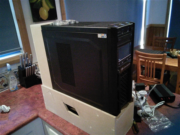

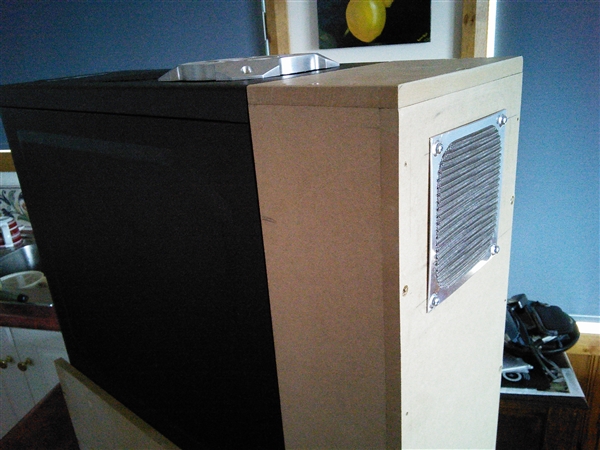

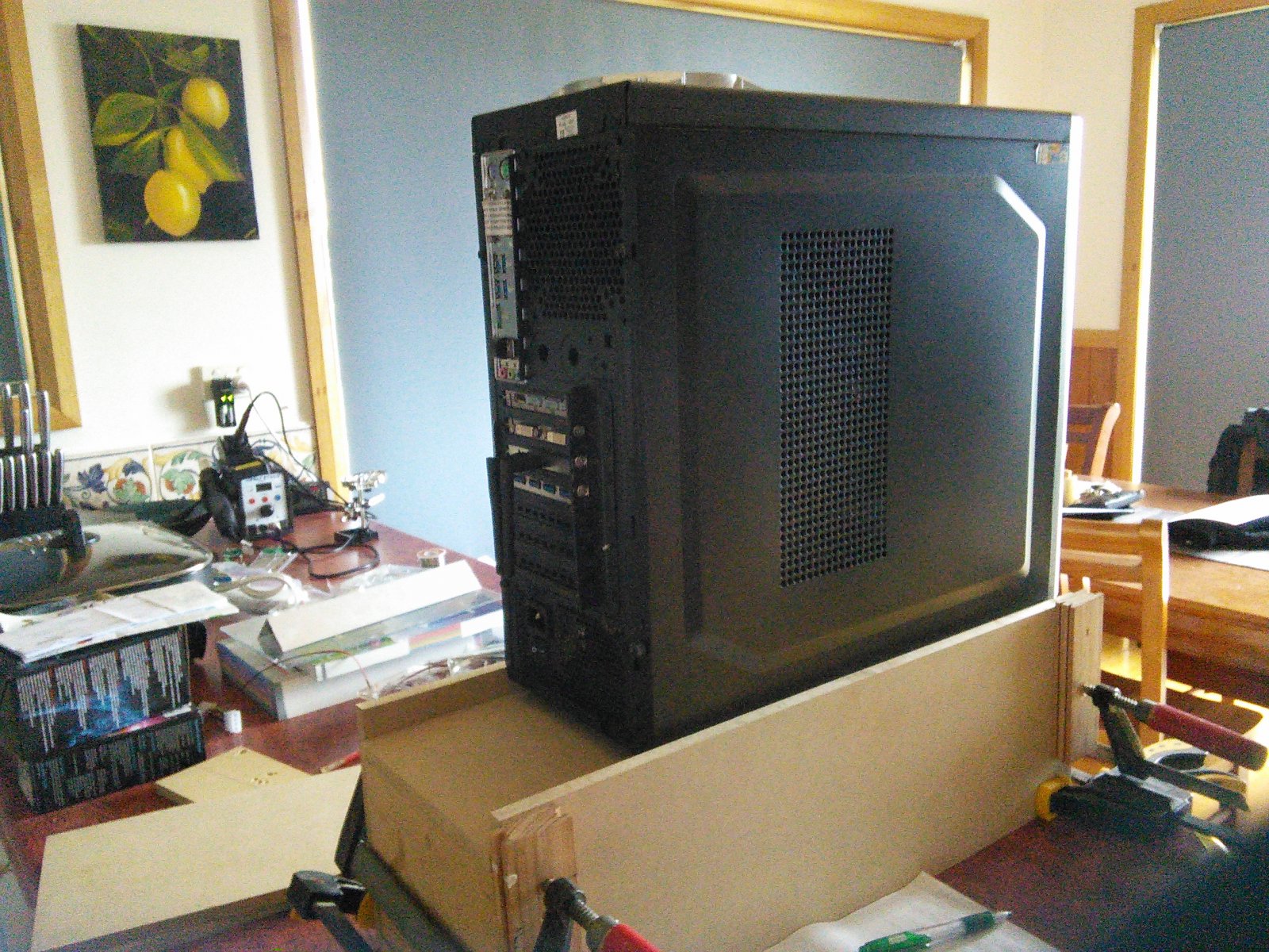

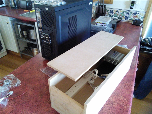

    The computer dock is slowly coming together. It will house the mini amps for the sound and haptic systems, along with powerboards and all wiring.
    IMG_20150615_121954.jpg IMG_20150618_101241.jpg IMG_20150618_143753.jpg IMG_20150621_153819.jpg
