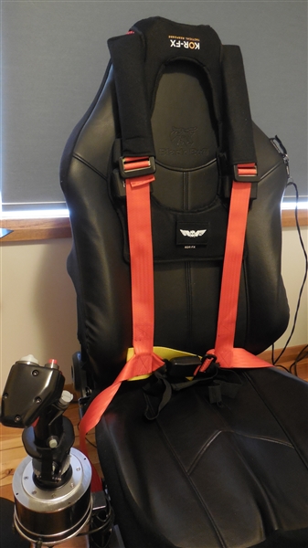

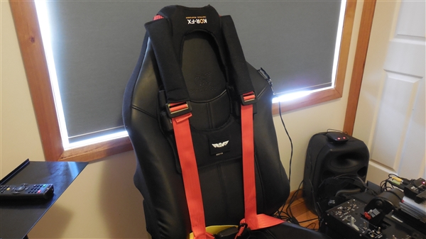

    My Kor-FX vest arrived this morning. I got it to do a version 1 quick and dirty evaluation for creating a harptic harness. Ultimately I will custom make a haptic harness for my sim rig, in anticipation of SimTools eventually adding transducer control.

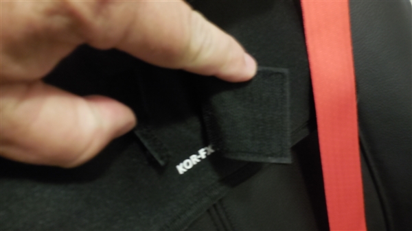

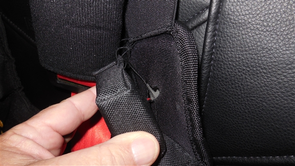

    While the Kor-FX works OK, I have to say I was shocked at how shoddy the stitching is and its overall poor quality. The first time I put batteries in it one of the sewn in battery pockets came most of the way off. First time I went to remove the front flying skull patch, which is held on with velcro, it pretty much ripped the stitching away on the velcro strip sewn to the vest.
    I always planned to cut the Kor-FX open to rewire it and create an opening chest strap, so it is easy to get in and out of as part of the harness. Hence I can live with the shoddy manufacturing. But I would never recommend the Kor-FX to a gamer, the stitching and overall poor quality control is that bad. There was not even any sort of instructions included in or on the box. It is not that hard to get the basics working, but button presses with a built in feedback voice from the vest are used to configure the thing, so that really does need some sort of instructions.

    That KOR-FX upside-down on the top drives me crazy :D I would have already cut it or covered it!
    Yeah, I know, I'm crazy :sos
  12. noorbeast
    20,572
    145,250Coins
    +10,783 / 52 / -2
    I only got it this morning, but its time will soon come when it gets hacked to bits, I just need to try it first along with some other sound gear I want to link together. So no you are not crazy @Blame73.

    My initial summary stands @SeatTime, the Kor-FX is poorly constructed with no information provided. The push button interface with robotic feedback voice is not really intuitive. If mine is an average example then it would not last long in general gaming use, hell it really did not stand up to just putting batteries in it for the first time without the stitching giving way.
    The interesting bit will be taking a Stanley knife to it and opening up the workings. I will use the guts of it to prototype a haptic harness, which I think is a pretty cool idea for extending the use of traducers. Even in my initial test today it gives a feeling of being more completely surrounded by vibrations, but I am sure I can improve that even more and make haptics a seamless part of the harness.
