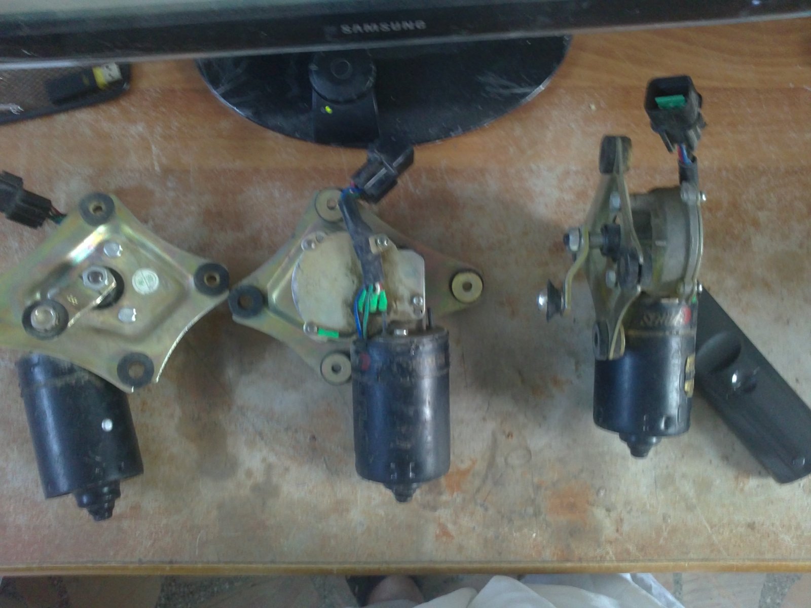

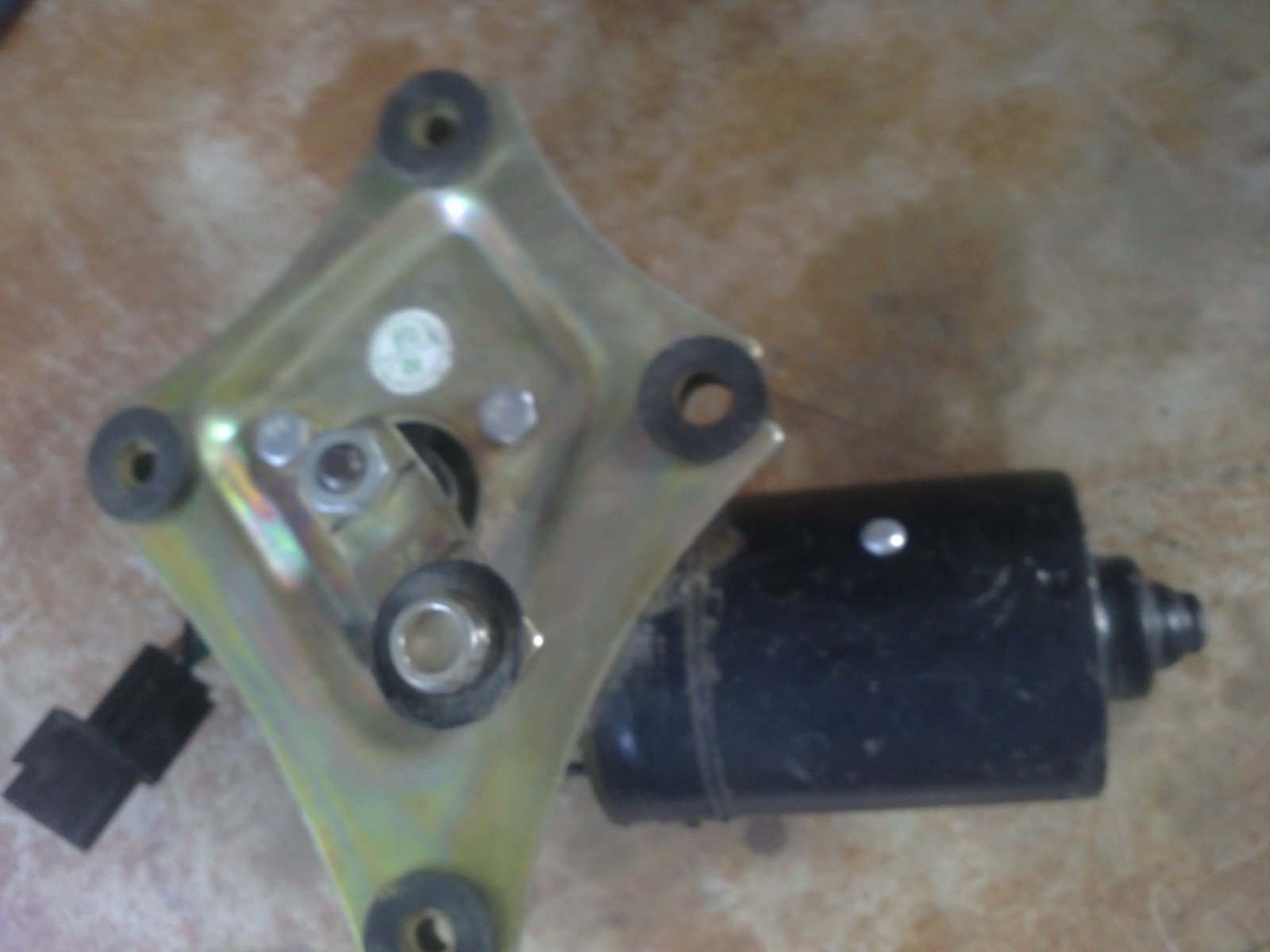

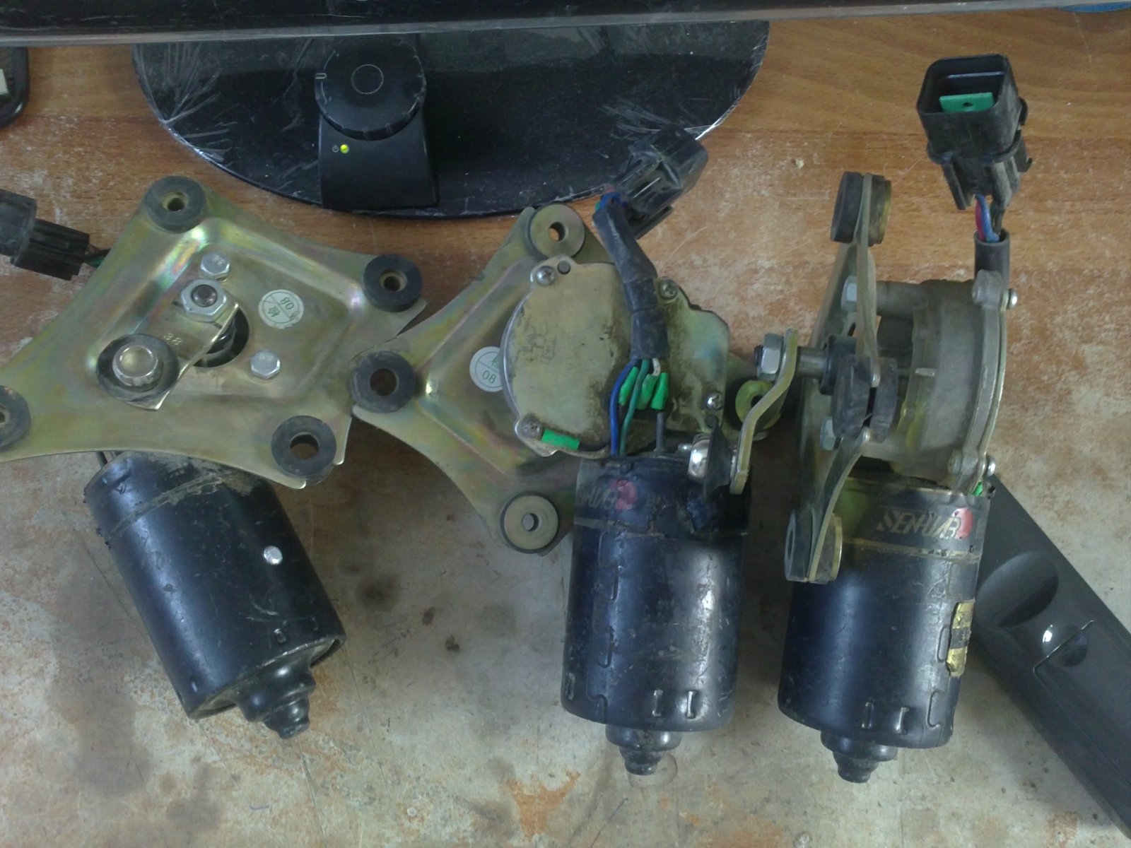

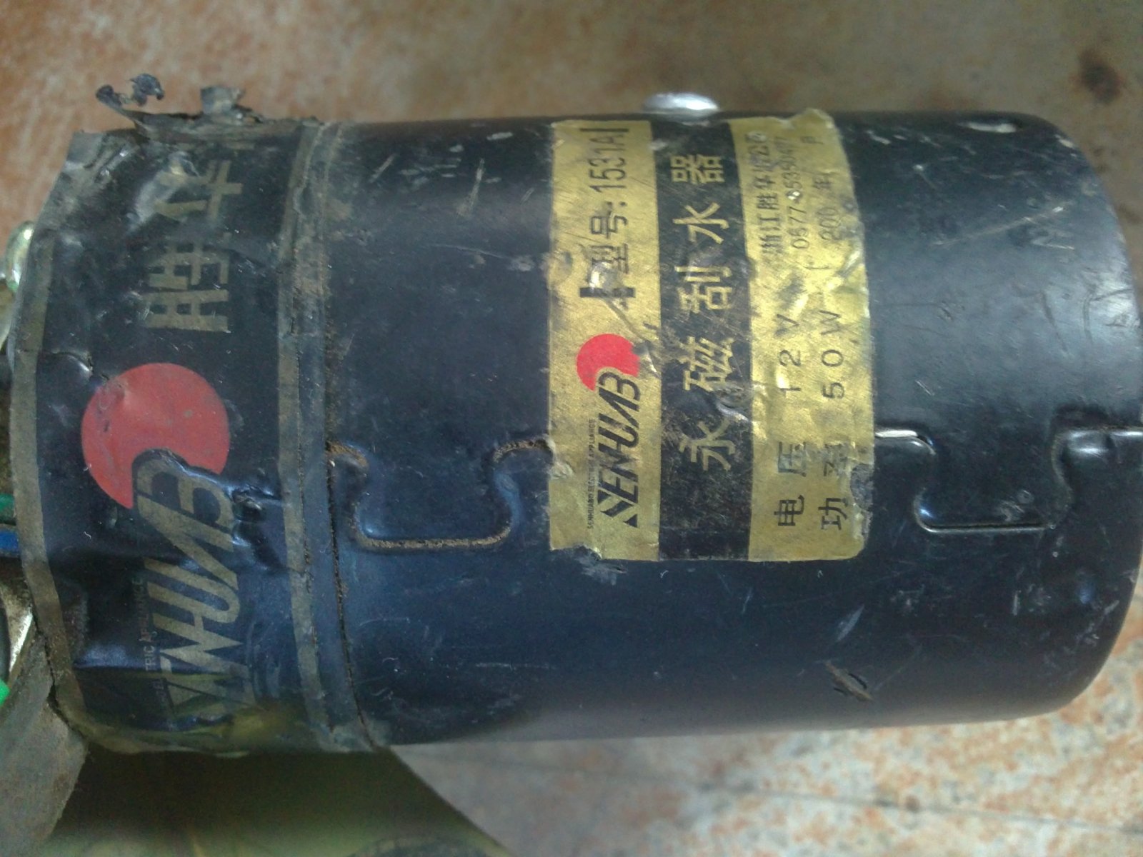

    I bought three wiper motors
    Written on 12-volt 50 -watt
    Is it possible that the Have fun in playing simulation
    I run motor on adapter 14 volt 20 amp
    It was his speed Not too bad
    The question is
    1- Is it possible to be used in the simulation Or it's slow

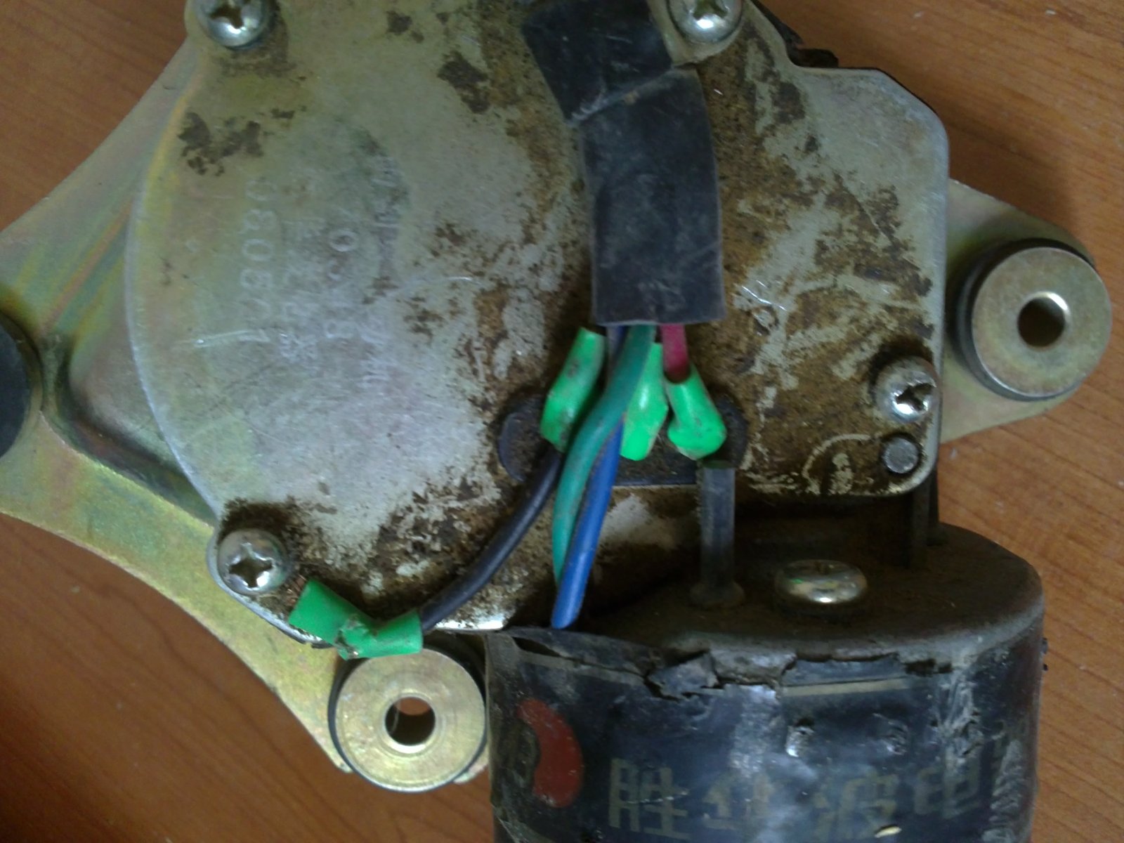

    In the wiper There are Five wire
    Two of the engine and The other three
    For sensor or that Encoder
    2- Can I Benefit From the Encoder Instead of potentiometer

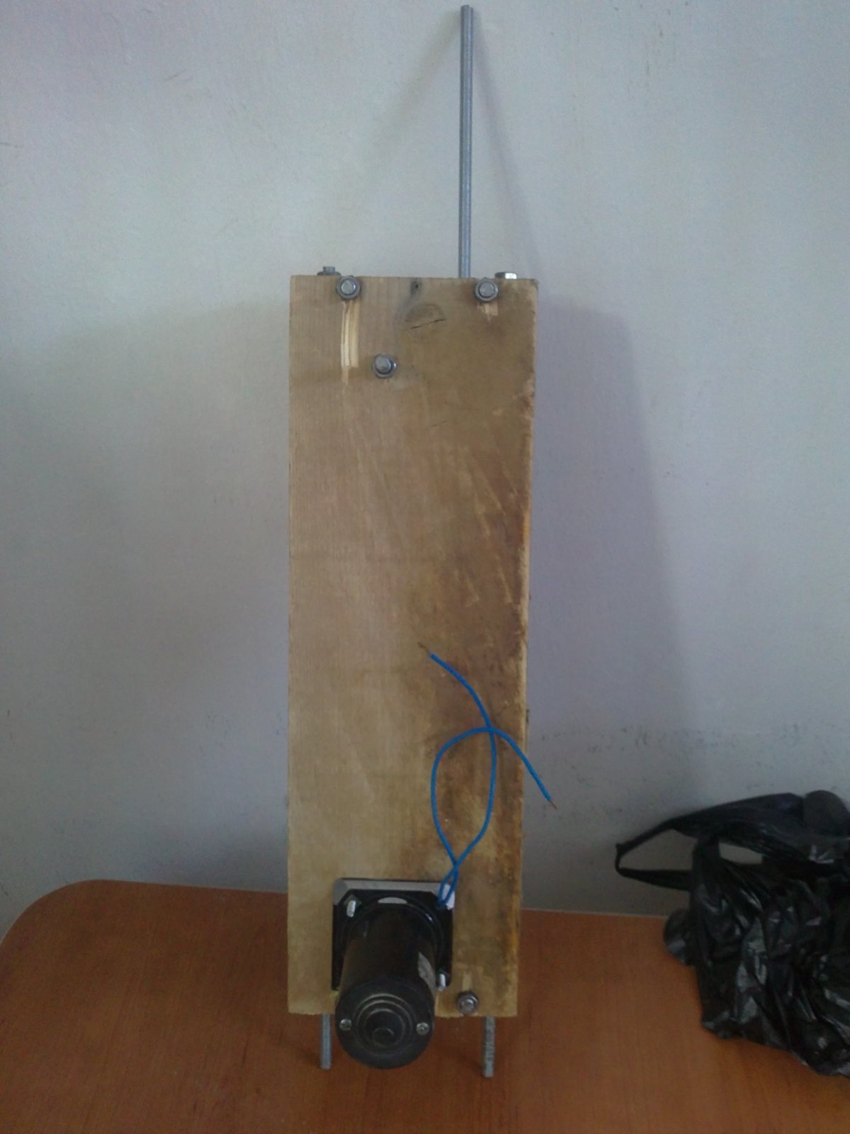

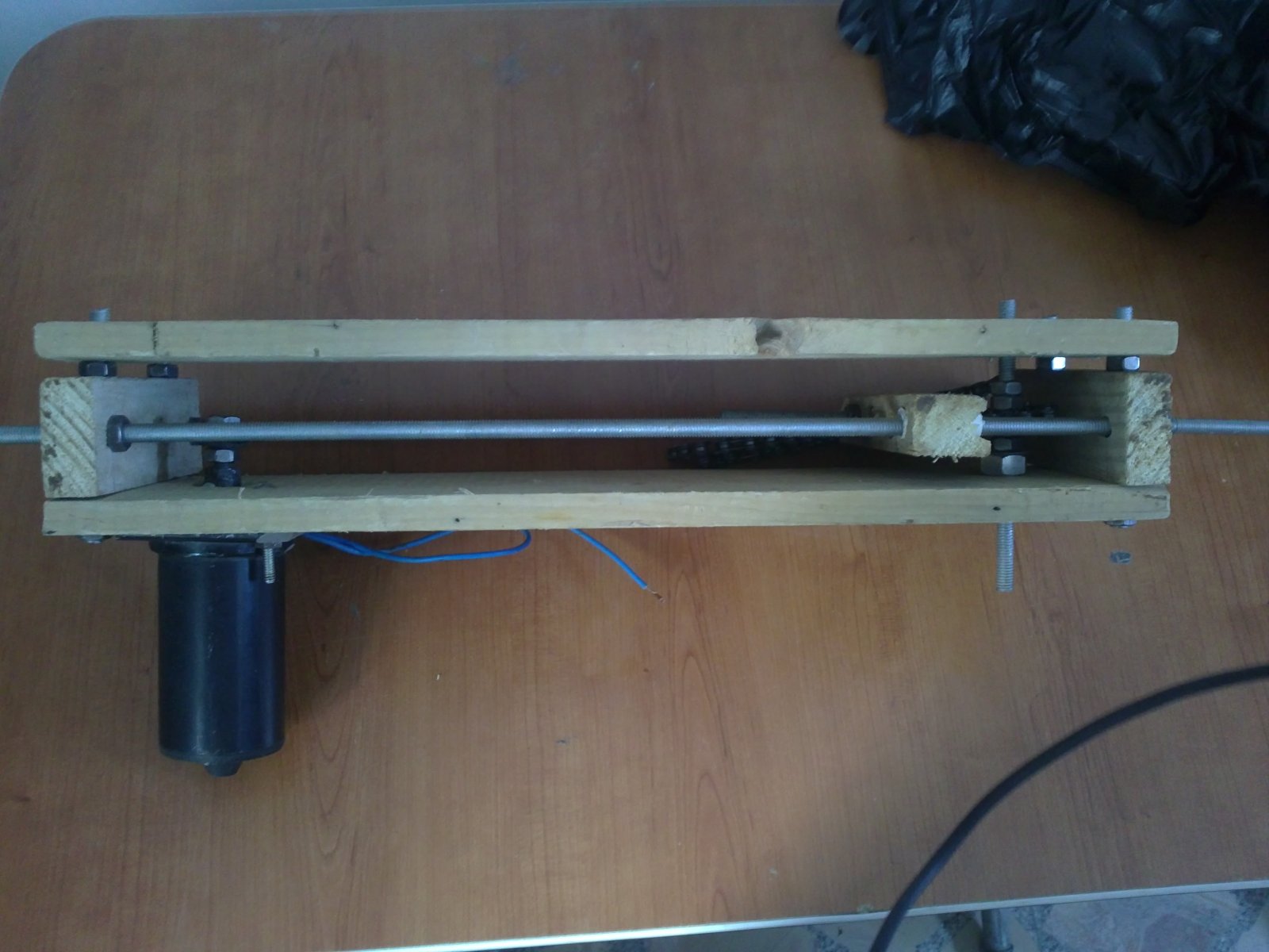

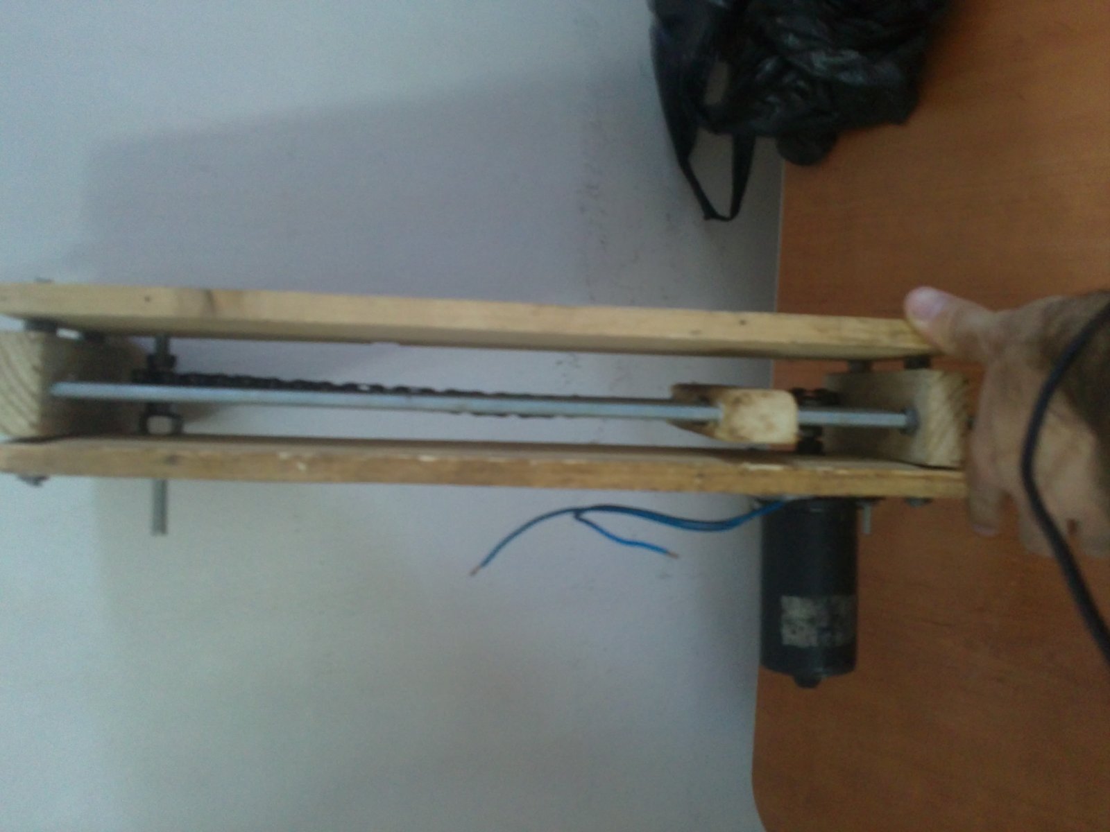

    worked linear actuator motor but
    Failed completely
  2. bsft
    wipers should be ok to test them with
    with the 5 wires, not sure, you will have to put straight 12v on them to find the faster speed of the wiper
    Remember that the wiper MUST be earth isloated.
    Start witha pot if its cheaper and work with encoder later if you like.
  3. RacingMat
    2,234
    20,896Coins
    +2,084 / 21 / -2

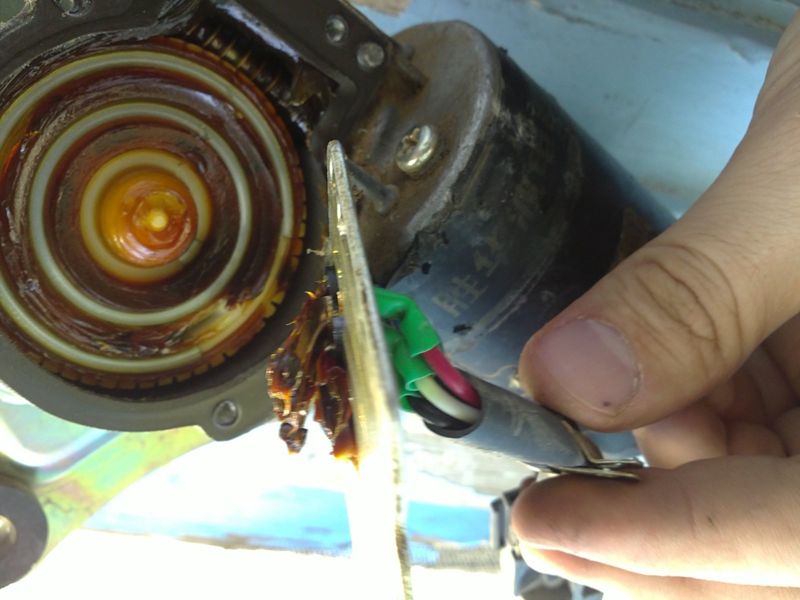

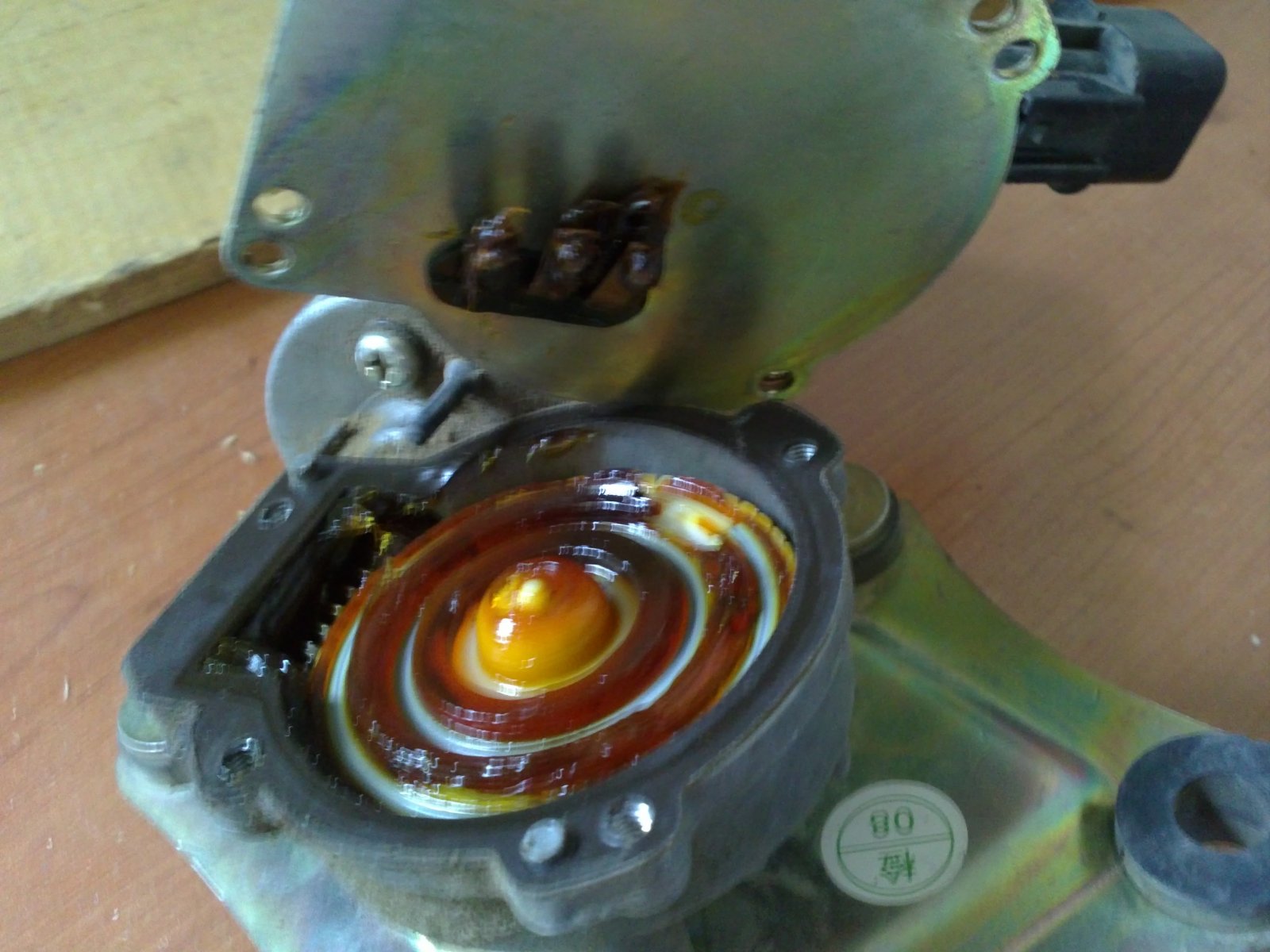

    Are you really sure there is an encoder?... :think I would rather say these extra wires are slow and fast speeds.
    There is no need of encoder to drive the wiper motors in (old) car.
    Neither for our simulator: we need absolut positionning! hence a potentiometer
    I'm eager to see your linear actuator working :)

    As he Said @bsft There are two speed of the motor
    I try to work linear actuator Will be Demo And Attach the Project
  5. bsft
    well done, you have gotten further with your actuator process than me.

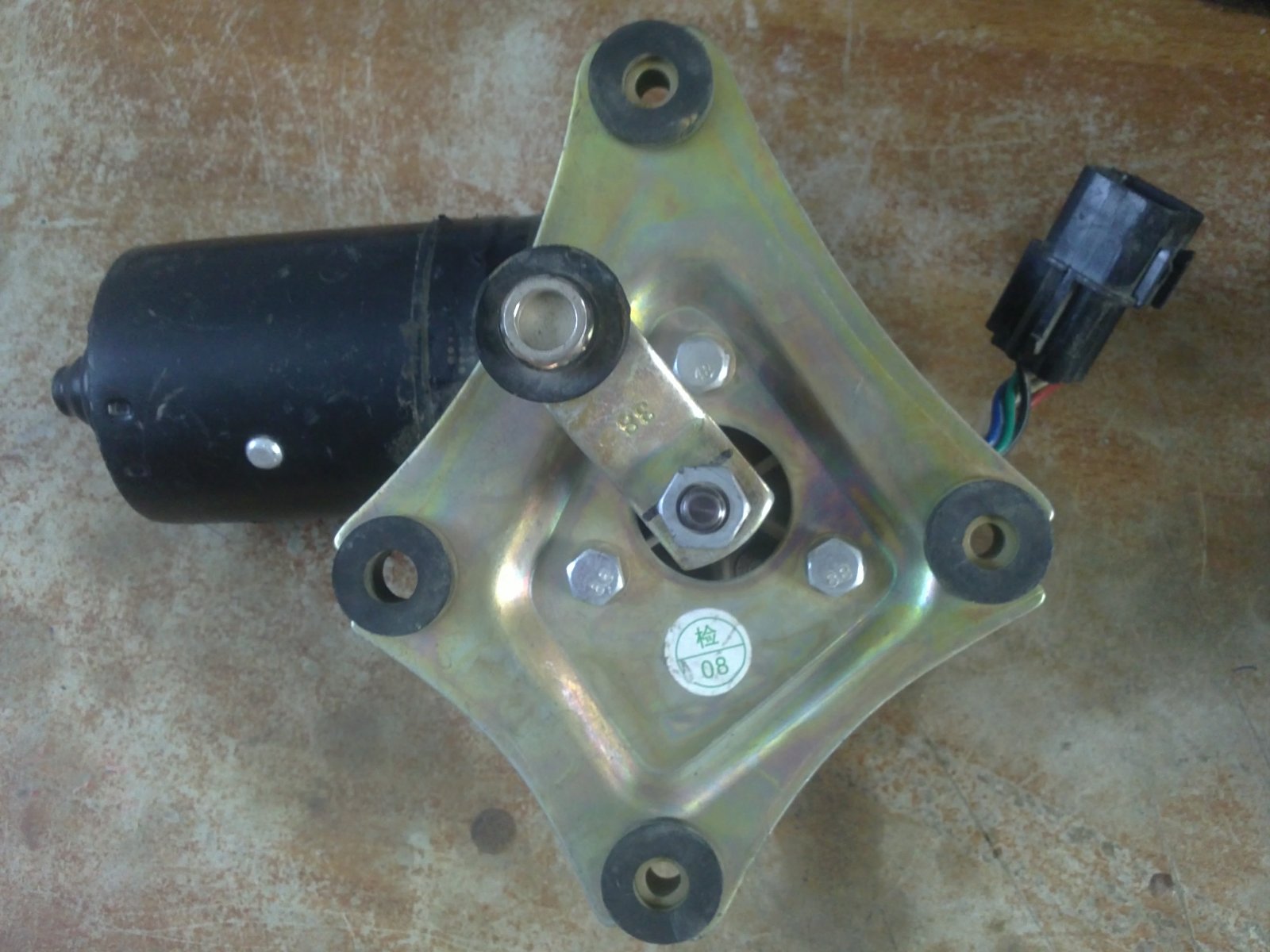

    Another question
    Are these three engines capable to carrying of a 90 kg
    Or you will lose speed
    Does motor I need more than 50w
  7. bsft
    no idea, Id guess from what Ian at BFF did and he uses 200 watt motors.
    But use the wipers as a start
