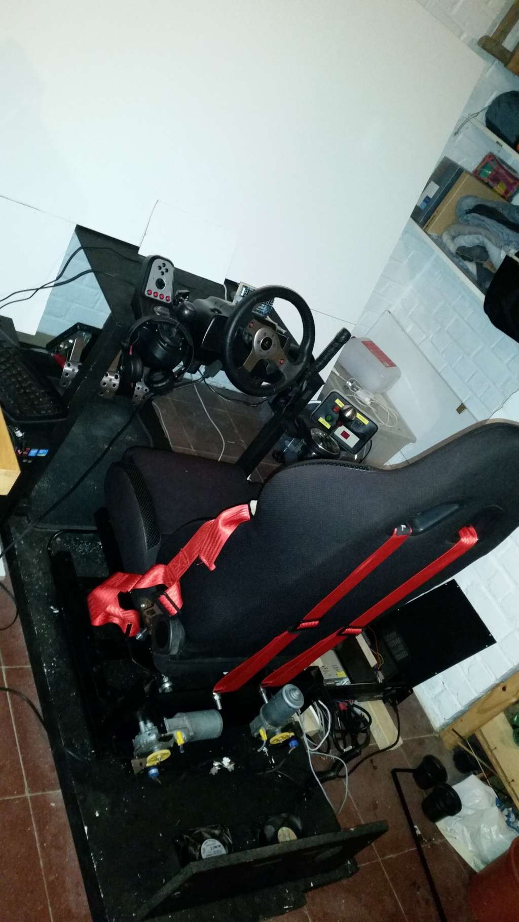

    Hi all !
    My DIY 2DOF motion simulator is using
    - Arduino UNO (I will share my code very soon, I need to clean it before :p)
    - Sabertooth 2x25
    - DC motor Smolka 24V
    I am using a G25, a TH8RS and a DIY handbrake (plugged on my G25 shifter)
    My screen is either a videoprojector or an Oculus rift DK2.
    Here is a picture :

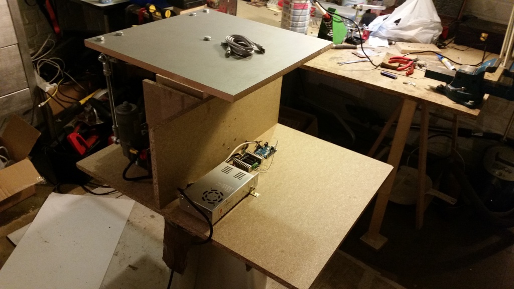

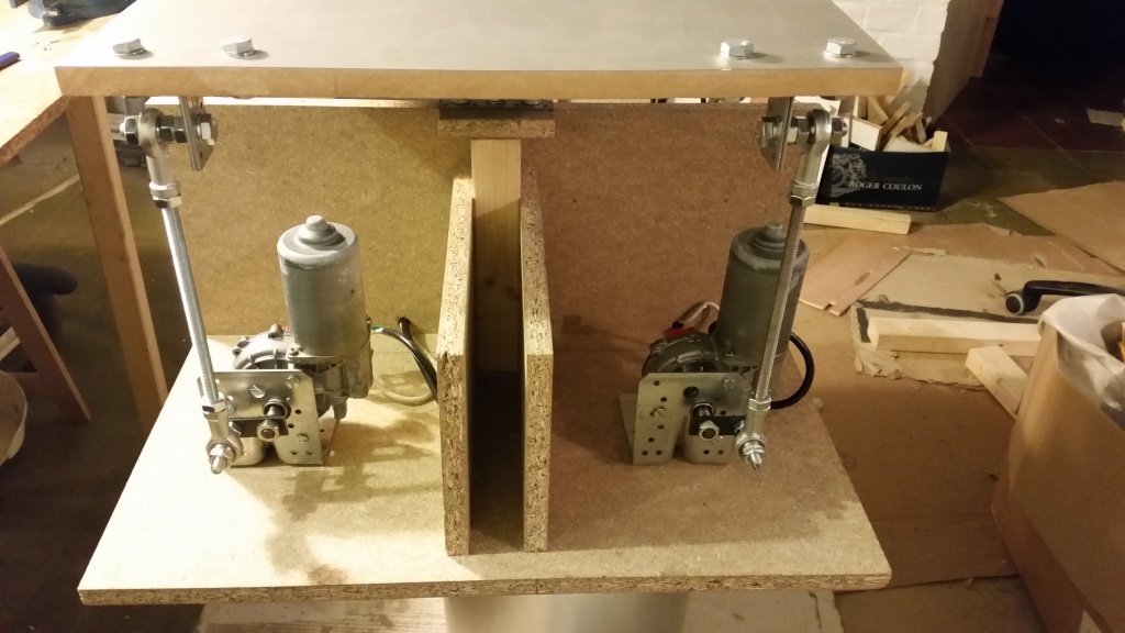

    I also wrote that I am building a new motion simulator low cost (less than 450€ !!), very easy to build and I will publish a complete tutorial soon (in french first) :
    And a video from it running Elite Dangerous (using SimTools !!) :
    FYI : I am working on the project to make motions on a sport video I recorded (ski, MTB, etc...), and I will use this platform below :
    If you have questions or want more photos, please do not hesitate I would be happy to share my knowledge with you!
