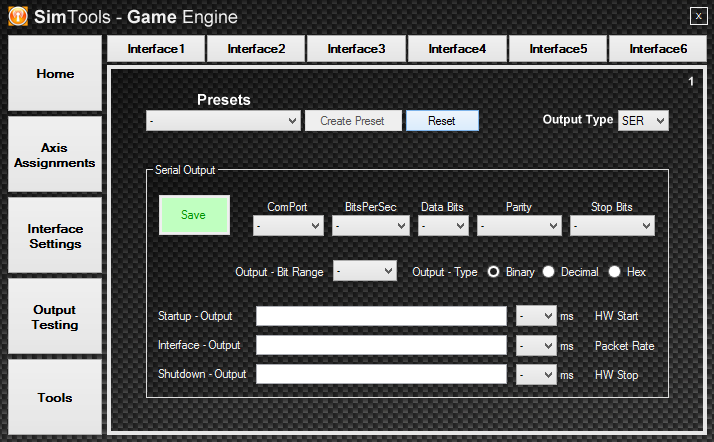

    Setting a Serial Interface.
    Once you have selected Ser from the Output Type box you will be given a screen that looks like this:
    To explain all the areas:
    • ComPort – Is the Com port the device is connected on.
    • BitsPerSec – Is the Baud Rate at which the interface needs to communicate at.
    • Databits – as it states is the data bits that are needed by this interface.
    • Parity – as it states is the parity that is needed by this interface.
    • Stop Bits – as it states is the Stop Bits that is needed by this interface.
    • Output – Bit Range – as it states is the range of values SimTools will send.
    • Output – Type – Is the format for the value needed by the interface.
    • Startup – Output – If your Interface needs a specific set of commands to set it up. Plus on the end of this you can set a pause for the Interface to do its start up in time before any other command is sent to it – HW Start. IE the time it takes to centre or calibrate itself.
    • Interfaces – Output – Will be the format that SimTools will send Axis movements to the selected interface, and an axis is represented as <Axis1> and so on. Again on the end of this there is another setting for setting the time needed for the interface to cycle through the command before it receives another Command – Packet Rate.
    • ShutDown – Output – If your interface needs specific commands to shutdown enter them here, as well again we have another setting on the end to allow the interface time to successfully shut down – HW Stop.
