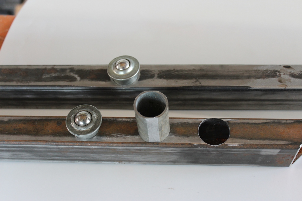

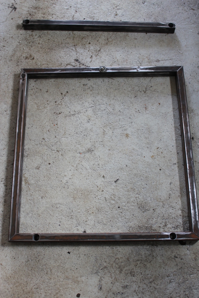

    Here i present my latest extension

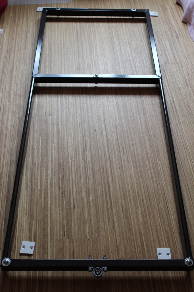

    I sattle for a 5 Point mounting Frame .
    Why?
    You prevent torsion, its cheap cause the frame could be lighter and easy to build.
    I bought some Bearings ( whats the correct tech. expression?) New OldStock on Ebay - 5 for 10€
    I had some daubt about the Quality, but no Problem at all.
    I inserted some Tube to give the bearings a correct fit. The Tube is fixed with two welding points.

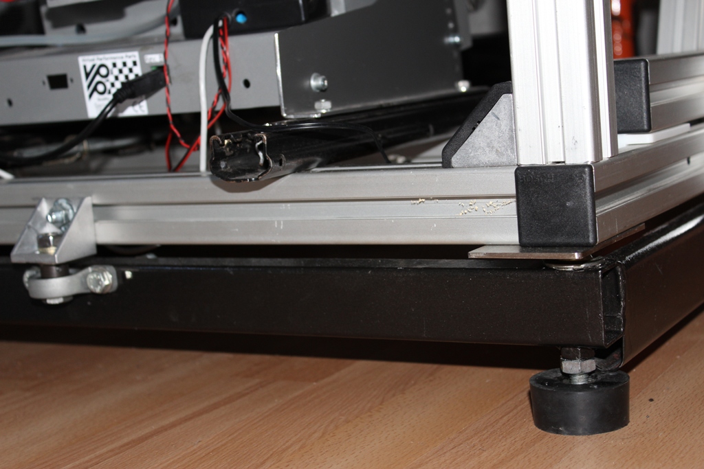

    Here is shown the Front Frame and the Rear Frame.
    In Front and Back 2 Point Mounting and one in the middle , right under the seat.

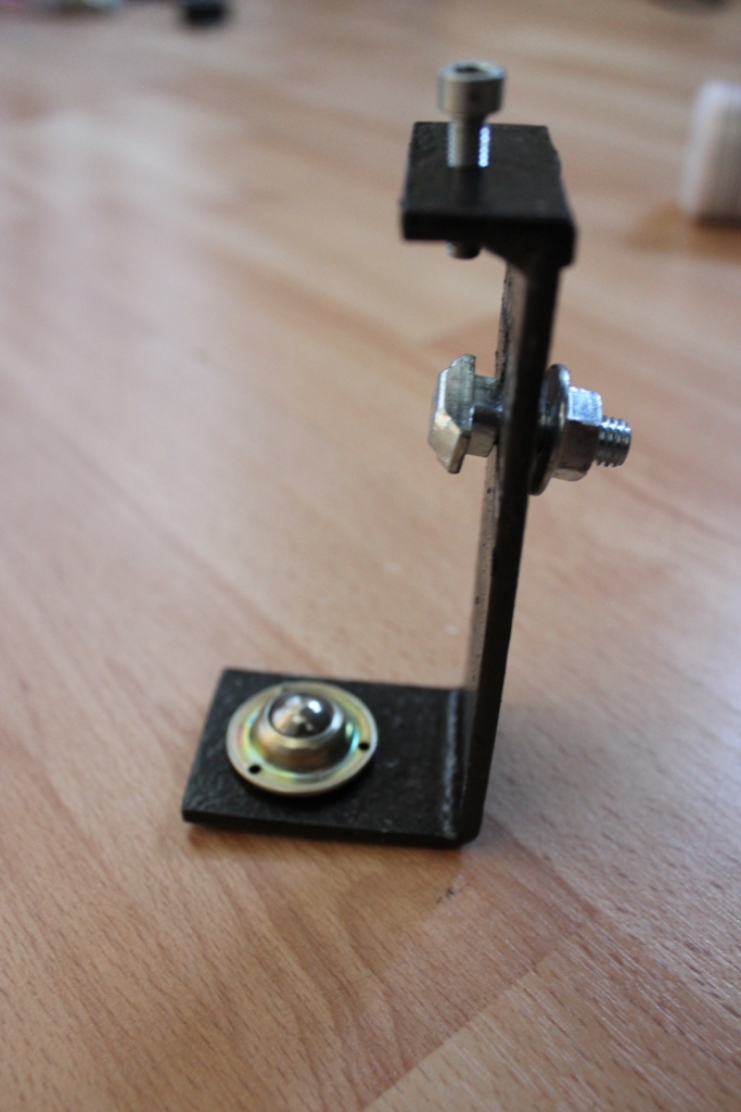

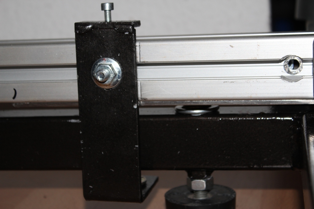

    Here you can see the Bearing with Bracket for the upper Frame.
    Very small, cause ther are only small forces to assume . Another 10€
    Here in Detail
    Underneath the Top Frame I installed some Stainless Steel Plates.
    First I tried Plastic but they were worn out immediately.

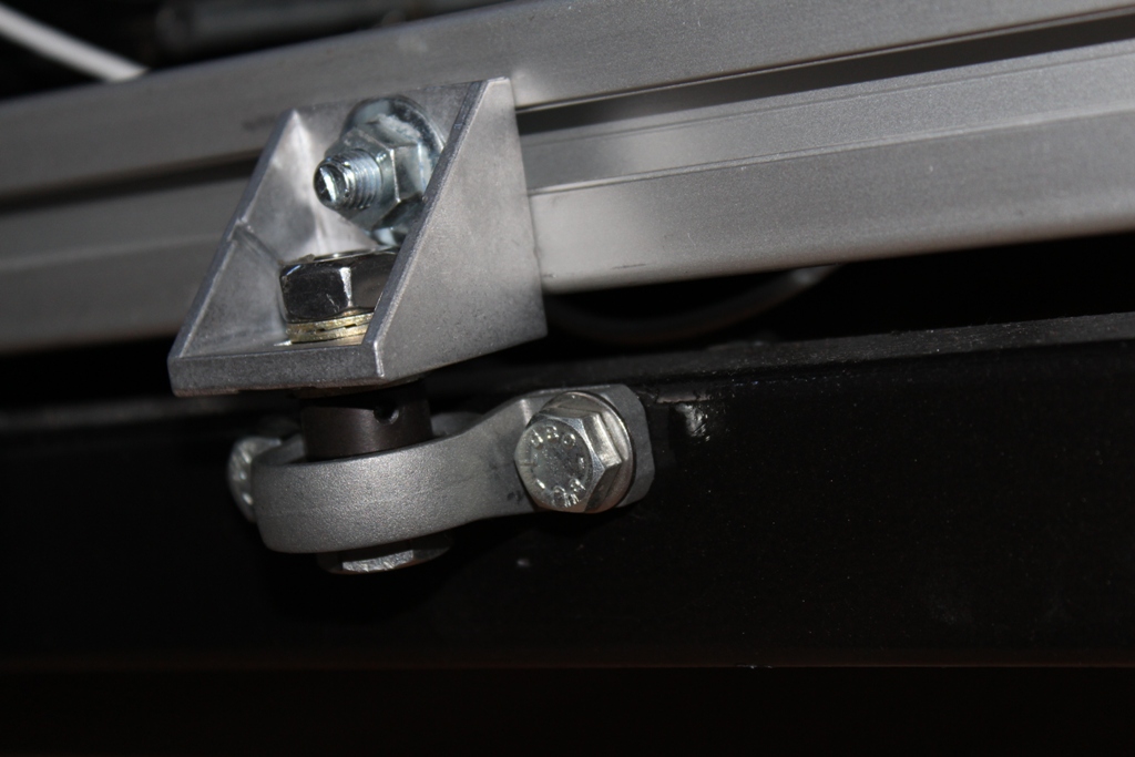

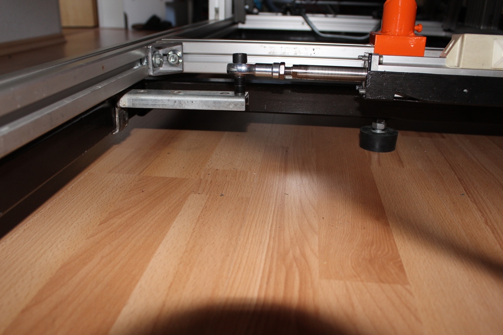

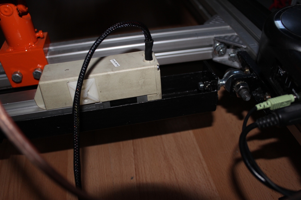

    Here is the Acctuator Mounting
    Left side
    Right side.
    First test
    mhhh not bad but the upper frame lifts a little bit in hard bends.
    Here is the solution for not hopping around
    Works fine !
