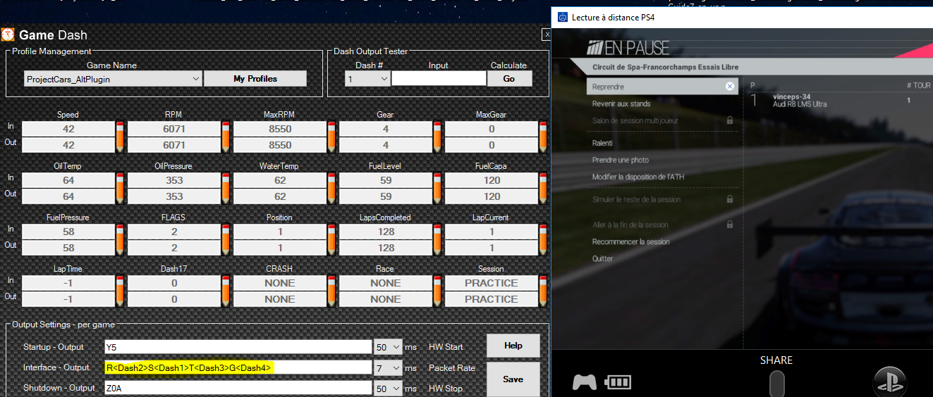

    Just another issue i think.... after 2 laps the leds on tm1638 just light 5 or 6 when get the max rpm... i push the reset button for leds and just stay good middle lap... how can i fix that. Im using arduino uno r3. I have tested with mega and leonardo but get the same issue...
  5. vthinsel
    vthinsel Well-Known Member
    Feb 20, 2015
    439
    FRANCE
    5,986Coins
    +564 / 2 / -0
    Arduino, 4DOF
    Which game ?
    Which GameDash settings ?

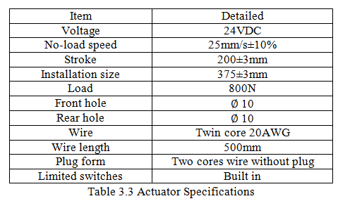

    sir.. can you help me about my coding...now, i dont know what is problem my real driving simulator because it is delay or slowly movement..maybe from actuator or coding for motor driver( arduino).. this is my coding.

  7. Malik10
    Malik10 Member
    Mar 3, 2016
    68
    MALAYSIA
    657Coins
    3DOF, Arduino, SimforceGT, Motion platform
    this is my spec for actuator..

    Hello...
    Game: project cars (ps4 console)
    Game Plugin: ProjectCars_AltPlugin
    When you mean gamedash settings i think its that:
  10. vthinsel
    Feb 20, 2015
    439
    FRANCE
    5,986Coins
    +564 / 2 / -0
    Arduino, 4DOF
    As PCars exposes the MaxRPM, you should defenetly use it : add T<Dash3> and that should do the trick
    I love PS4 RemotePlay :)
  11. mys3lf
    mys3lf New Member
    Feb 24, 2016
    24
    Designer
    Portugal
    118Coins
    +9 / 0 / -0
    Thanks @vthinsel Its working now....
    Thanks again mate.... :cheers
